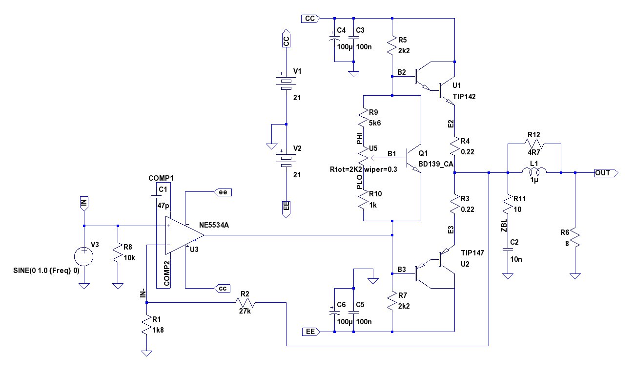

I'm looking at that R7 between the opamp output and the minus supply - it doesn't look needed to me. And the thing looks scary without the emitter resistors. They at least partly reduce the chance of thermal runaway in the output devices. Being darlingtons (two transistors in each case), both the driver's and output's Vbe's will drop as they heat up.
It is possible to leave out R7, but then the current goes into the opamp. Nothing wrong with that, as long as it is within limits. But it does look a bit strange.
You're probably right about the emitter resistors. I would recommend putting them in for anybody building such a thing. I would also add a Zobel output network and decoupling caps. Oh yes and I would replace the diodes with a Vbe multiplier.
