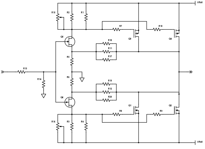

Basic schematic. I'll add all values later.
Feeling somewhat disappointed (Nelson's time machine at work again, hahaha) that this is now basically a less fearless version of F7 (more fearless than F5 though), probably no interest in this, other than it has very similar specs to F7/F5 (obtained with negative feedback) and will be much easier to successfully build than the F7 for the DIYer dumb dumb (touch wood).

as regular F5 with laterals
Yes, but without all the other bits, much dumber (I prefer dumber ).
No source resistors, no thermistors, no current limiting circuitry, and has dominant 2nd Harmonic which F5 didn't have.
I suspect it should be a hybrid sound of F6 and F5, so should be quite pleasing to listen to.
Edit: Many years ago I also built something similar with 3 pairs of IRFP240/9240. That one had source resistors (this one doesn't ). It sounded great but the bias stability scared me a bit. This one is rock solid and meets all my requirements more so than F5.

It's my design so you won't find it anywhere. Actually it's a modified version of one of Papa's amps but all design decisions are mine using his topology. ......

however , that just means you didn't do your homework - several Greedy Boyz already made that - F5 with laterals and no current limiters
besides - laterals having negative TempCo above 100mA , there is no need for NTC ....... maybe adequate PTC , if you're splitting da hair type
first one doing that , from memory, was Jackinnj (moi always having trouble to remember exact spelling) ; he's even still selling 2SJ201 and cousin in his small store
whatever - that's good amp ; but , I would (in your boots) put that Zen Amount Pot in parallel to input JFet source resistors , as Papa made in second revision of F5

Well you didn't do you homework (hehehe) :D, I was the one who originally suggested/observed changing source resistance of jfets in F5 would alter harmonic profile, brainy Papa came along and suggested putting a pot on it.

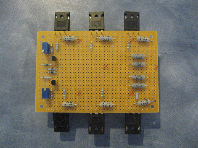

Anyway to give the full background behind this amp design, in July 2009 I wanted to build a simplified F5 with a bit more grunt, the picture below was the start of that building process (done point to point). I was very happy with the sound of that amp (back in 2009) but the bias seemed to keep drifting upwards, which was a little worrying at the time.
The amp had 3 pairs or IRFP240/9240, no thermistors, no current limiting but had source resistors.
This amp preceeded every other modified F5 (that I am aware of) including F5 turbo and Juma's F5 with 2sk2013/2sj.
This was the start of what I built back then, a few people said it wouldn't work (they were wrong, hahaha)
