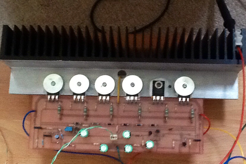

G'Day
Finally finished building this amp had some spare time. Used 2sa970/2sc2240, bd139/140 & Tip142/147, rails at 24v,bias 0.1amp, dc offset 25mV ish, very stable. Coolest running amp of Nelsons I've built yet doesn't seem right lol.
On soak at the mo, then give it a play. Cheers Nelson again.
Regards
Bruce
