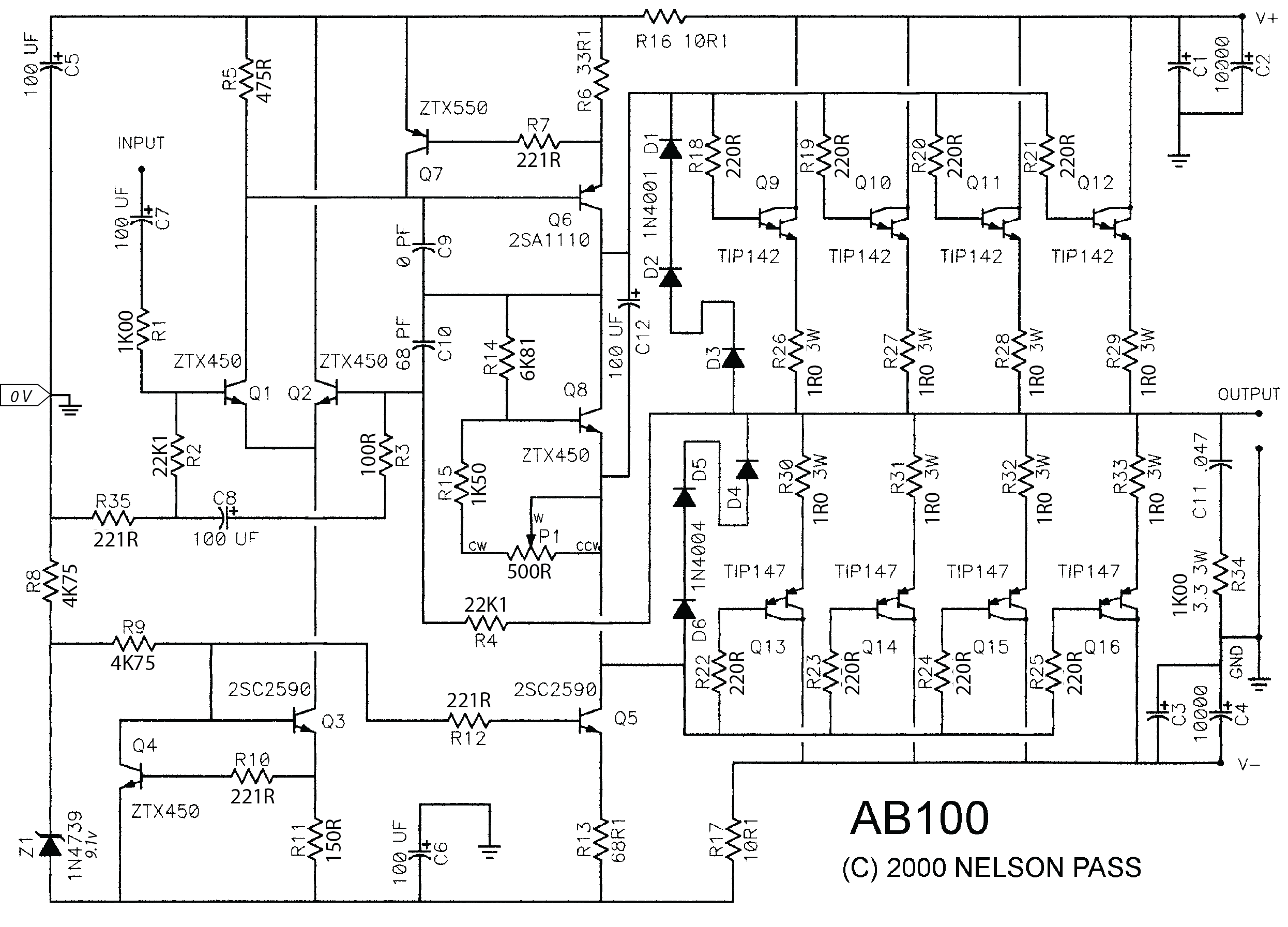

AB100 Class AB Power Amplifier

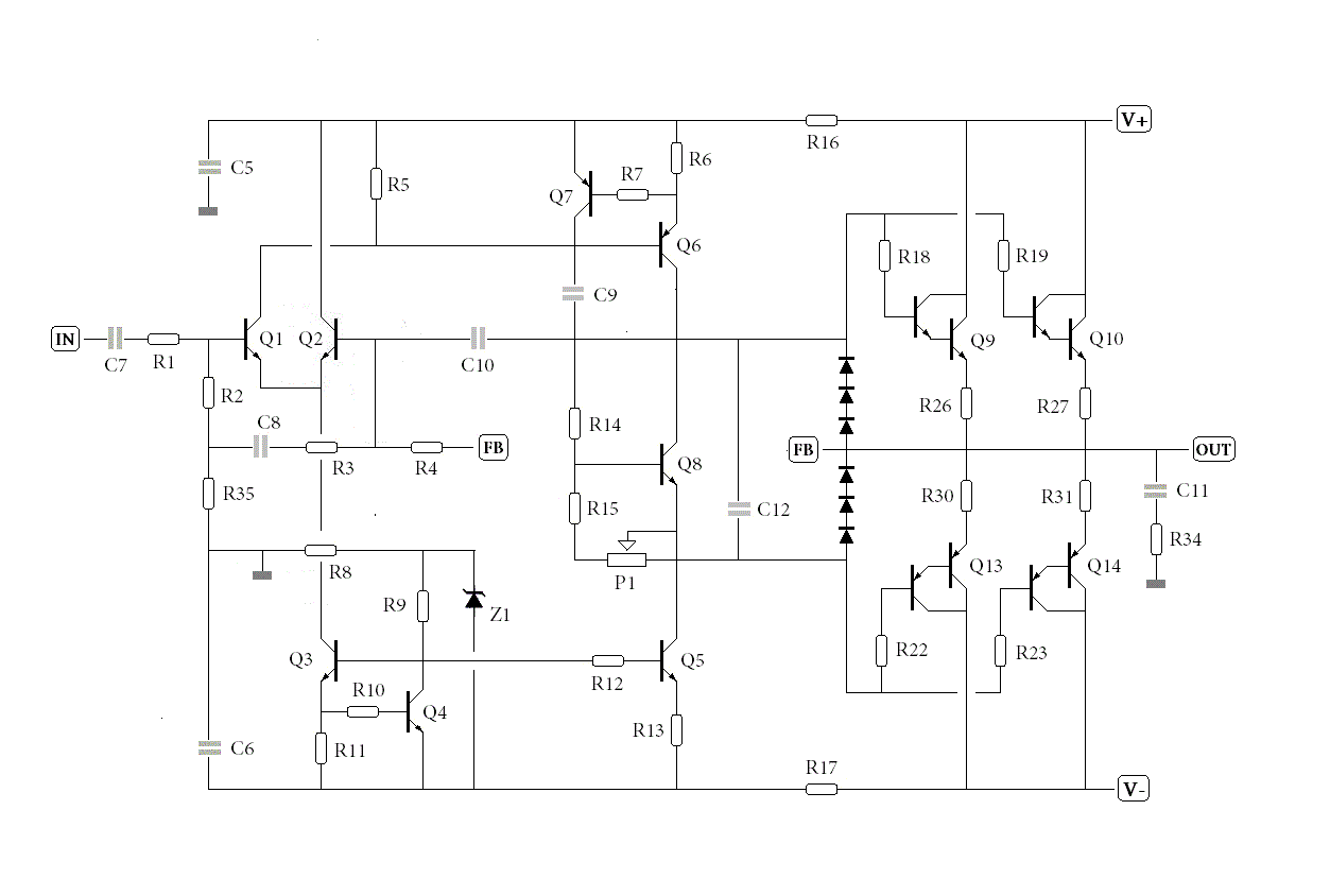

PASS AB100 - Minimalist improved schematic
Feel free folks to adopt...
Resistance values are now in more familiar coding.
The "missing ground" has been added.
Crossing lines have been 'broken-gapped' for clarity.
Zener has a Vz value.
No adjustments made to actual values.
Subtle... but a bunch easier to "stare at". And that darn input ground insertion prevents the old-timer's "where the heck is the operating point of the zener?" problem.
GoatGuy

Now if you could add the values to Tinnitus's drawing it would be even easier to read!
WHICH tinnitus drawing? He's come up with 2 or more.
Its funny - maybe 'cuz I live in The Colonies (AKA America) - but I get weird feelings when I look at resistors, drawn correctly by IEEE and EU standards, as little square boxes, instead of zigzags. Every OTHER component in electronics is a symbolic representation of its "principle of action". Capacitors are separated plates, transistors are bases with emitter and collector points touching (like Schottky's original!), diodes are symbolic "electrons stop here", coils look ... like formalized coils. Transformers are obvious, even tubes are pretty clear. Switches - bars that switch, etc.
Well, "resistors" are accurately zigzags! Originally almost all wire-wrapped, the notion is, "a bunch of crumpled up conductor, thin, that gives resistance". By comparison, the square box is ... counter to all the other symbols. According to many sources, it was adopted in the 1970s because "it is easier to draw both for draughtsmen and early memory-limited computers". It hardly seems appropriate. The zigzag IS the correct representation, and the little white box ... just "lies": many little boxes in digital electronics especially harbor marvelous and obscure functionality. Indeed, one does a disservice to a digital circuit schematic of any complexity using little square boxes for pull-up or balancing resistors.
This is why I'm also not inclined to annotate Tinnitus's drawing. Call me provincial, but I think Nelson Pass's original AD2000 drawing (with broken gap crossovers) is entirely clear. And I like zigzags for poor conductors. Gotta make those electrons run, run, run! That way they get tired. :p
GoatGuy

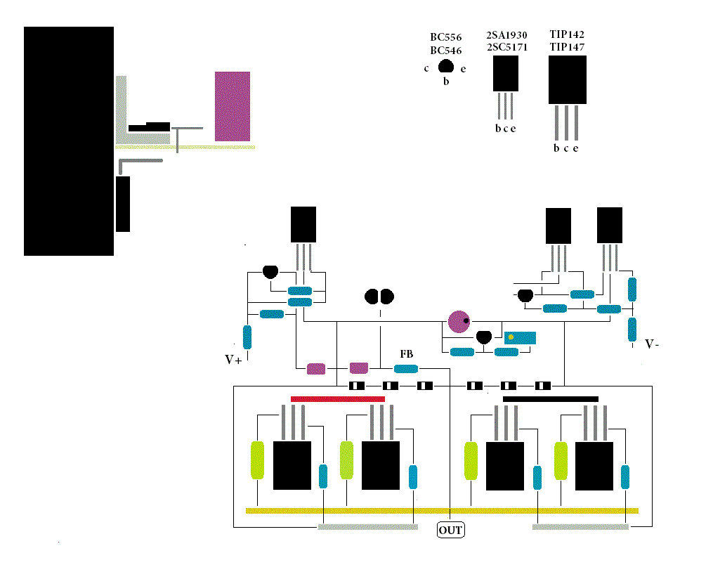

so that my drawing remains worthless, and not floats around the net with wrong values or text, I have intentionally stayed away from adding any kind of values, or text
but feel free to print it out and use for your own personal use
I hope thats ok, and clear enough
same goes for the resistor chart, no text added
use as you wish
but please refer to original schematic for correct values

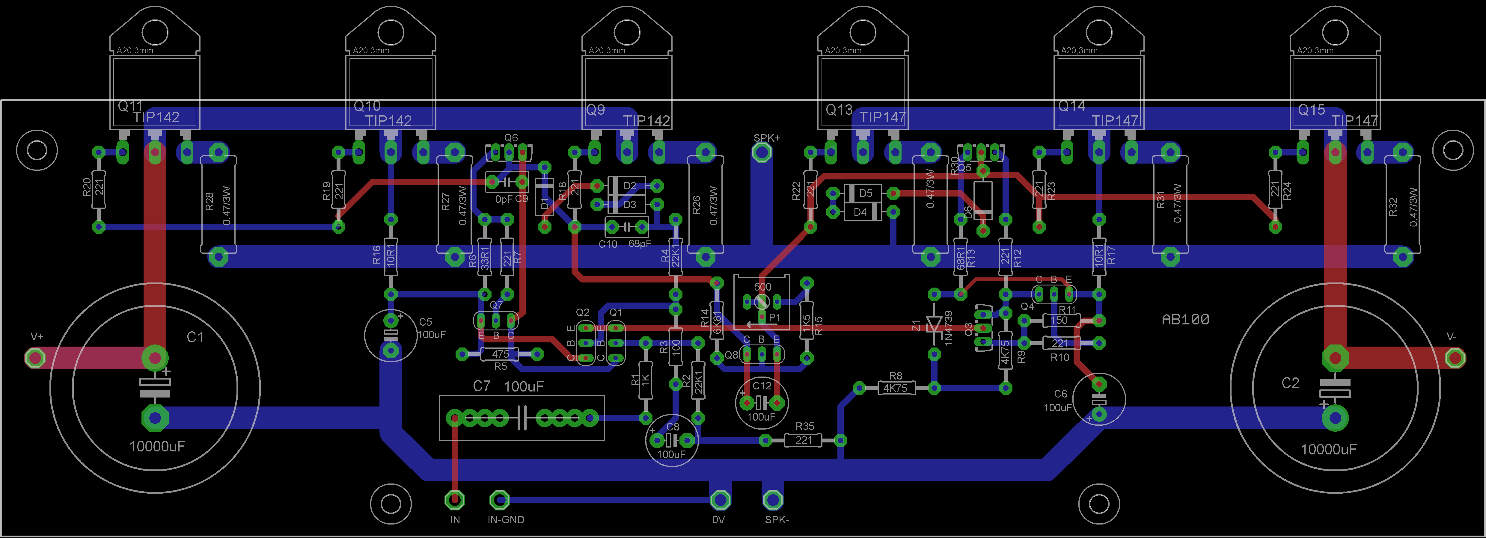

well, for that you deserve at least 'something' :rolleyes:
I guess component numbers will be ok

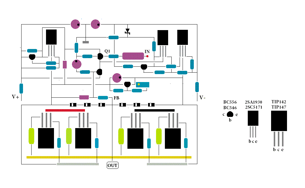

btw, since bias transistor Q8 is a TO-92, Im planning a small board for it
it will be mounted with small alu plate with hole for the transistor
the hole bias curcuit can then be mounted on the main heatsink
drawing will come soon, ofcourse :)
Ex-Moderator R.I.P.
Joined 2005
:scratch2: MJE340/350 does not appear to be very popular
but I have a few 2SC5171/2SA1930...maybe they would do ok
maybe, maybe not :clown:
getting tired :eek::p

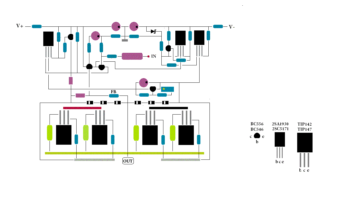

final...but still needs careful checking

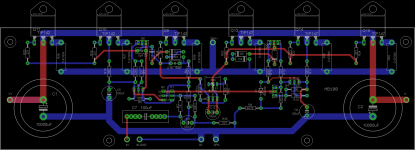

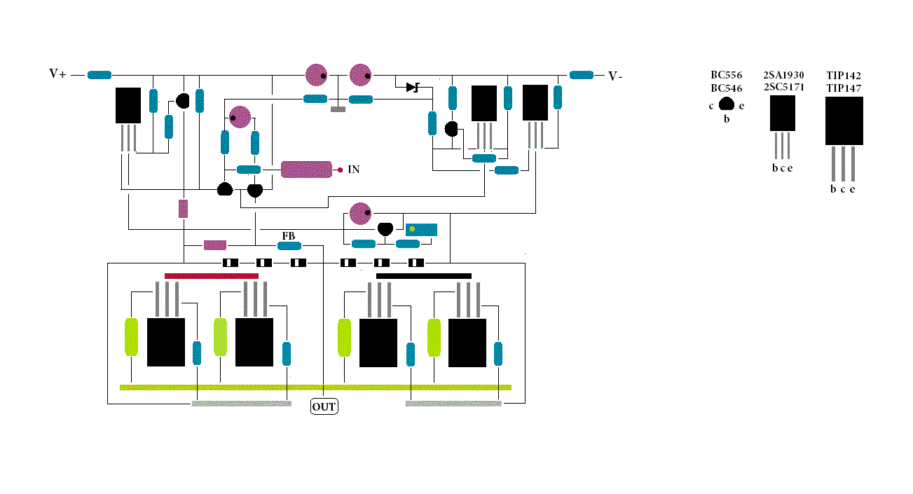

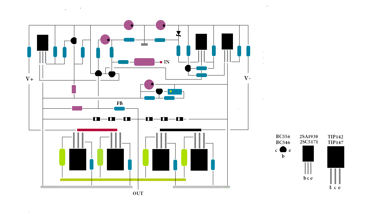

just small cosmetic change

And a question for the community -- Does anybody know if Q3, Q5 Q6 need to be individually heatsinked and/or need to be on the main heatsink to track the output's temperature?
