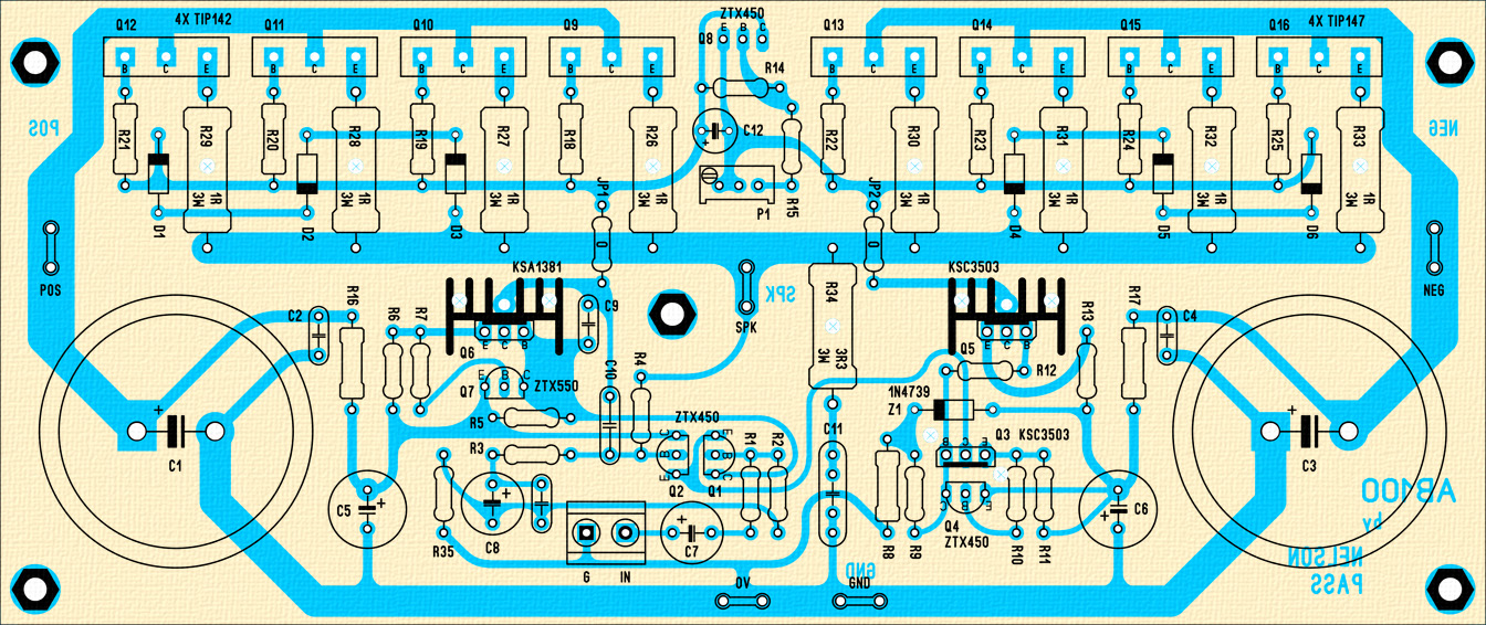

beautiful PCB,. but what psu and transformer do you suggest to use ?? x transistors, you need to Matching ???yea, but Mr. Pass also use two really big electrolytics in B1 buffer
Attached!
BTW, this is my last "mod" attemp (rounded tracks).
dim' : 190*80mm
Feel free to modify it yourself.
ZIP :
*.Lay6 files
Gerber & Drill

Q8 should be spun around so that the flat side can be clamped to the heatsink. The pads and holes for the power transistors Q9-Q16 should be enlarged to ease assembly and later repair. The +/- rails can be moved from the edge of the board to under the base and emitter resistors. Just move the protection diodes.
I think BD140 wouldn't be a good choice as a VAS transistor, too slow, compared to 2SA1110.The BD139 and BD140 appear to be intended for audio amplifier VAS usage. These are what are being used in the PeeCeeBee thread for VAS in the Solid State forum.
What diameter do you suggest?The pads and holes for the power transistors Q9-Q16 should be enlarged to ease assembly and later repair.
{all dimensions in inches}
When I prototype stuff like this I use a Keystone #34 eyelet that is about .150 diameter and requires a .093 hole. Inside hole is about .068 after I install the eyelet with my non standard tool. For a double sided PCB I'd use a square pad about .190 or .200 and a .065 +/- .003 hole. It might be nice to enlarge the pad vertically and drill a via about .100 from the component hole.
hi, but x the psu are 45v DC?Amp ha been completed and it sings like crazy
Everything worked even without test boards. No hum, dc offset 2mV and 10mV per channel.
Bias 40mA per transistor - runs cool.
no turn on/off thumps.
PSU - +- 45V 30 000Uf in each rail.
indicator diode foe each rail.
Transistors - ztx450,550,MJ340/350, mj11016/15.
0,5 ohm emitter resistors and base stopper divided-100R on PCB and 100 on transistor base pin.
I will measure later with scope and sound-card - now I am a little tired after amp hobby work
hi, I meant this thanksHi, i do not understood your question correctly, but if you asking about psu voltages:
Transformer 2*32V ac and approx +- 45V DC

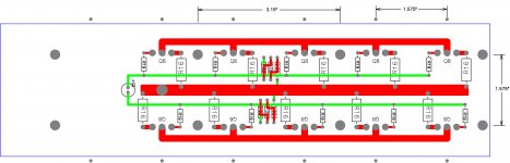

From Mr Pass
Hope he doesn't mind I posted this here.
Somewhere, can't remember where, I promised some work on the AB100
pc board by way of update, and later decided that I would try melding it
with a modular output stage that would support an open design and
make it available through the store.
Toward that end I started fitting it to the UMS spec of DIYaudio, and here
it is currently, with up to 10 output devices and room for the 20 pin
socket holding a front end.
At this point I am just entertaining the notion of a layout that looks like
this with something like these dimensions.
These pinouts support complementary followers for TO-3P type packages
in both Bipolar and Mosfet. Digikey shows 95 such Bipolars.
Comments welcome.
