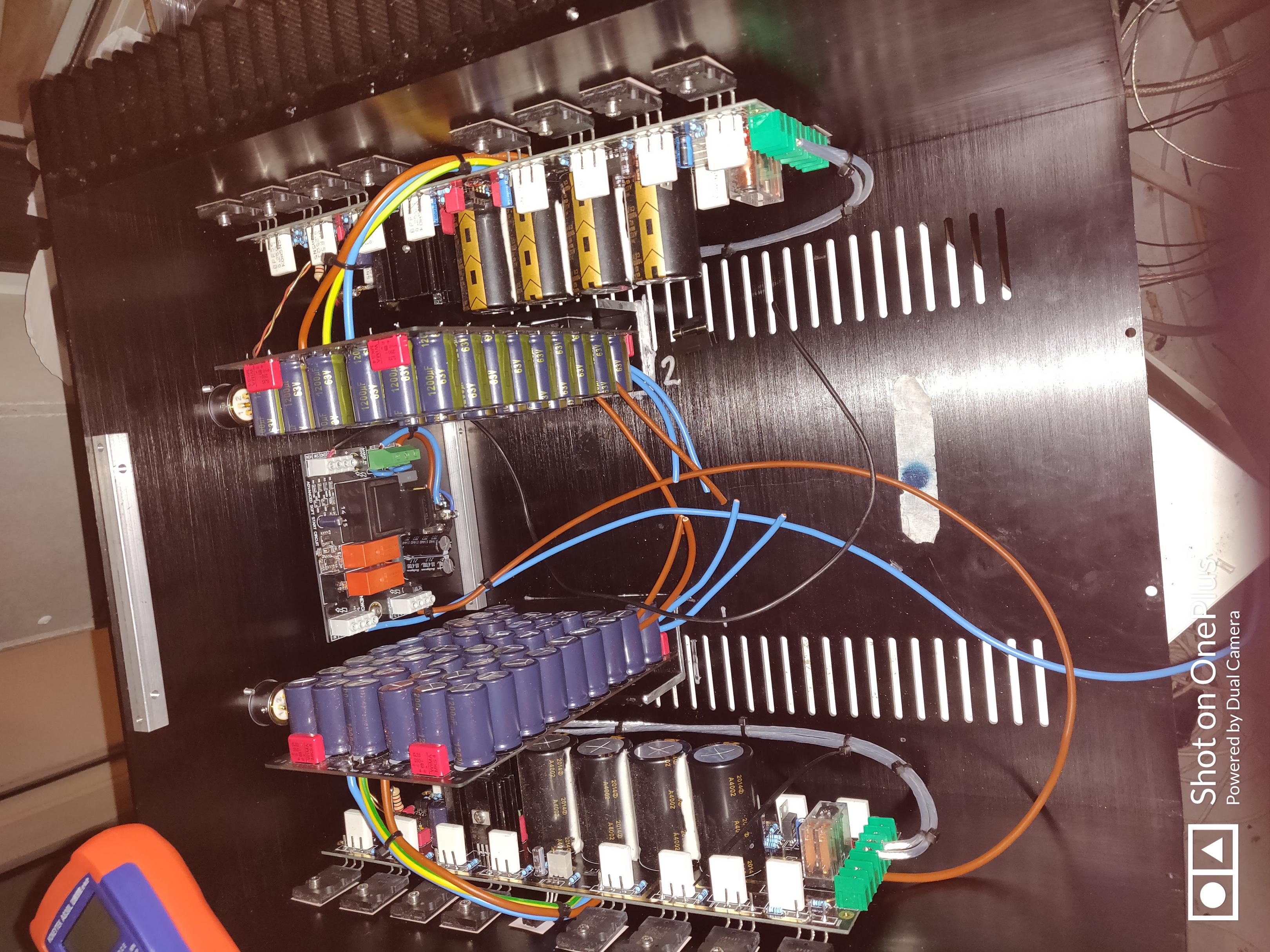

IMG_20210316_183906.jpg Two of this for my Accuphase Clon. If to meatless I will use Kendeil 180.000 uf 63 v.
Great improvement
View attachment 932827 Two of this for my Accuphase Clon. If to meatless I will use Kendeil 180.000 uf 63 v.
Very good Erlend, :)

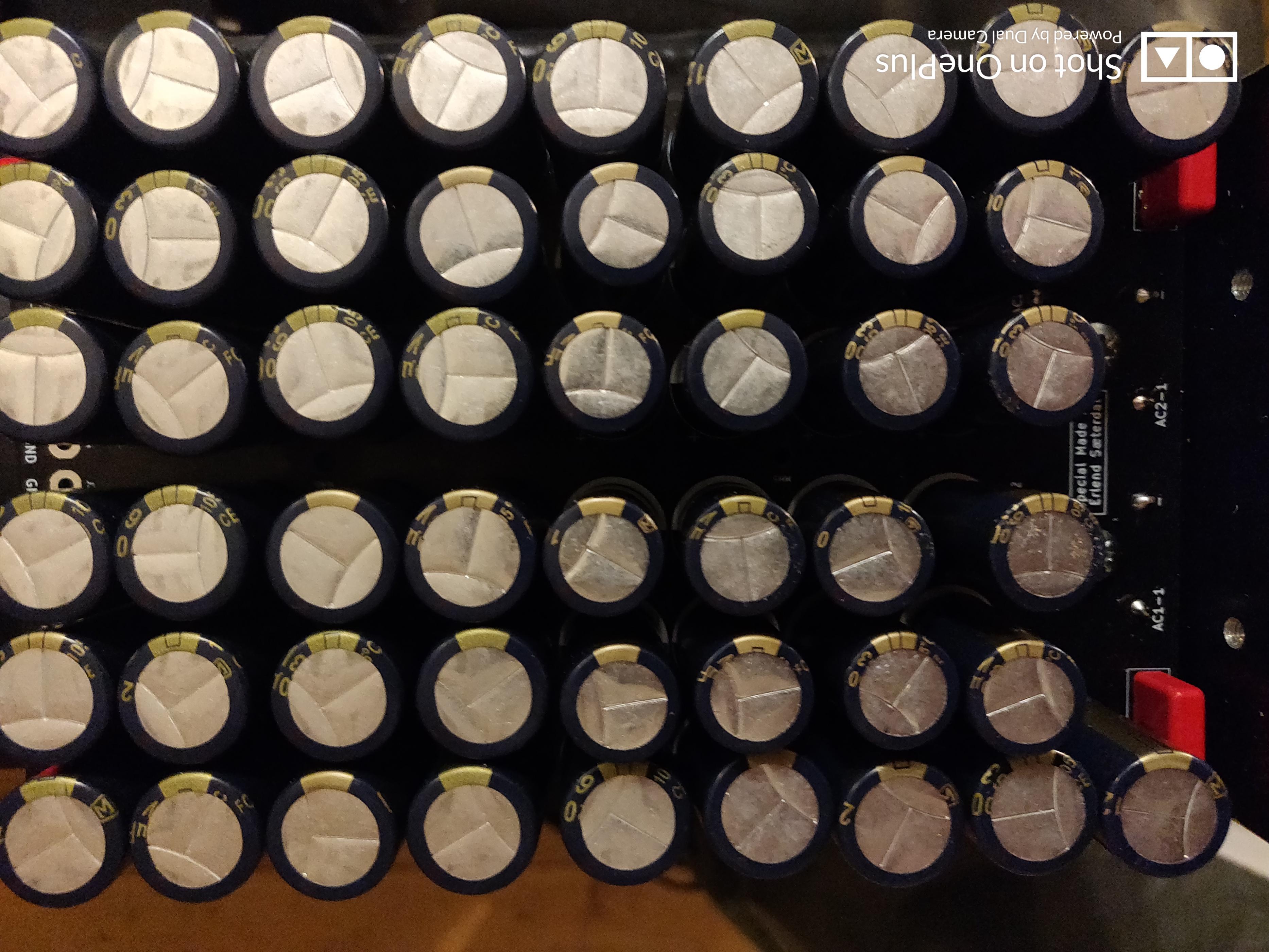

That is a great improvement because these on-board capacitors are too little to provide enough clean power for such a powerful output stage.
Furthermore, I intend to replace all 0R1 emitter resistors with 0,22 ohm to prevent thermal runaway at higher bias currents.

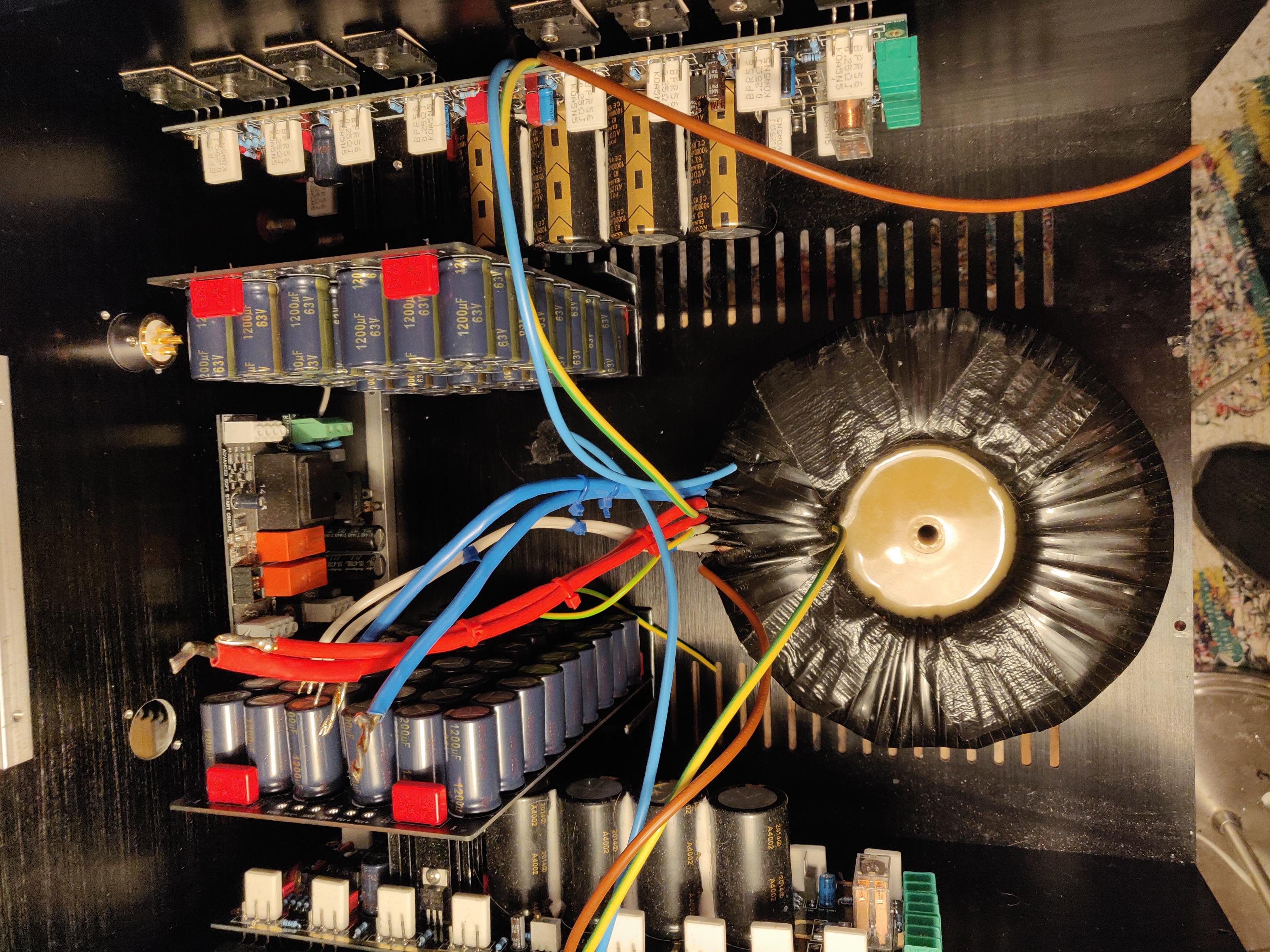

I can't wait to my 4 X 36 vac 1500 w transformer arrives from Polen.
Erlend,
What you do is the right way to go. The cost of the amplifier board itself is just a fraction of investment into adequate power supply and heat sinks required to extract the maximum performance from this amplifier.
Also, it is a great idea to use a single 4 X 36 vac transformer. This means you can use a single larger transformer and yet keep the channels entirely separated. The chosen transformer has four secondaries - two for each channel. Perfect. :up:

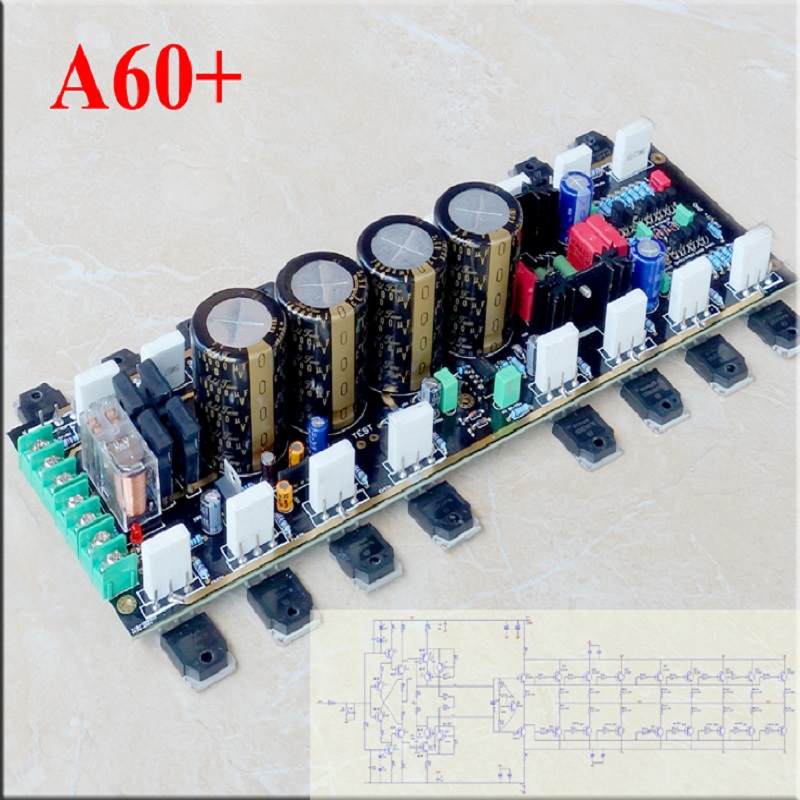

Hello everybody! Today I ordered 2 power amplifier boards in the official store WEILIANG AUDIO, A60 +. And also 2 voltage transformers of 500VA at 2x36V. So take me into your ranks if there is no objection. Permission to ask questions. How bad are the onboard power transistors and power supply capacitors? Please forgive me for my English, I use a translator.

Hei Rallyfinnen, :)
This board is really easy to tweak: bias & DC offset potentiometers are already on board. All you have to do is to adjust the desired values. Other possible improvement is adding more capacitance to the power supply section.
It would be indeed difficult to achieve substantial improvements on this board because there is absolutely almost no room for improvement. Just observe the measurements I have presented a couple of pages back. Awesome performance and great sound can be achieved almost with zero effort.
However, I guess you prefer more problematic boards where you can work more creatively. :cool:
