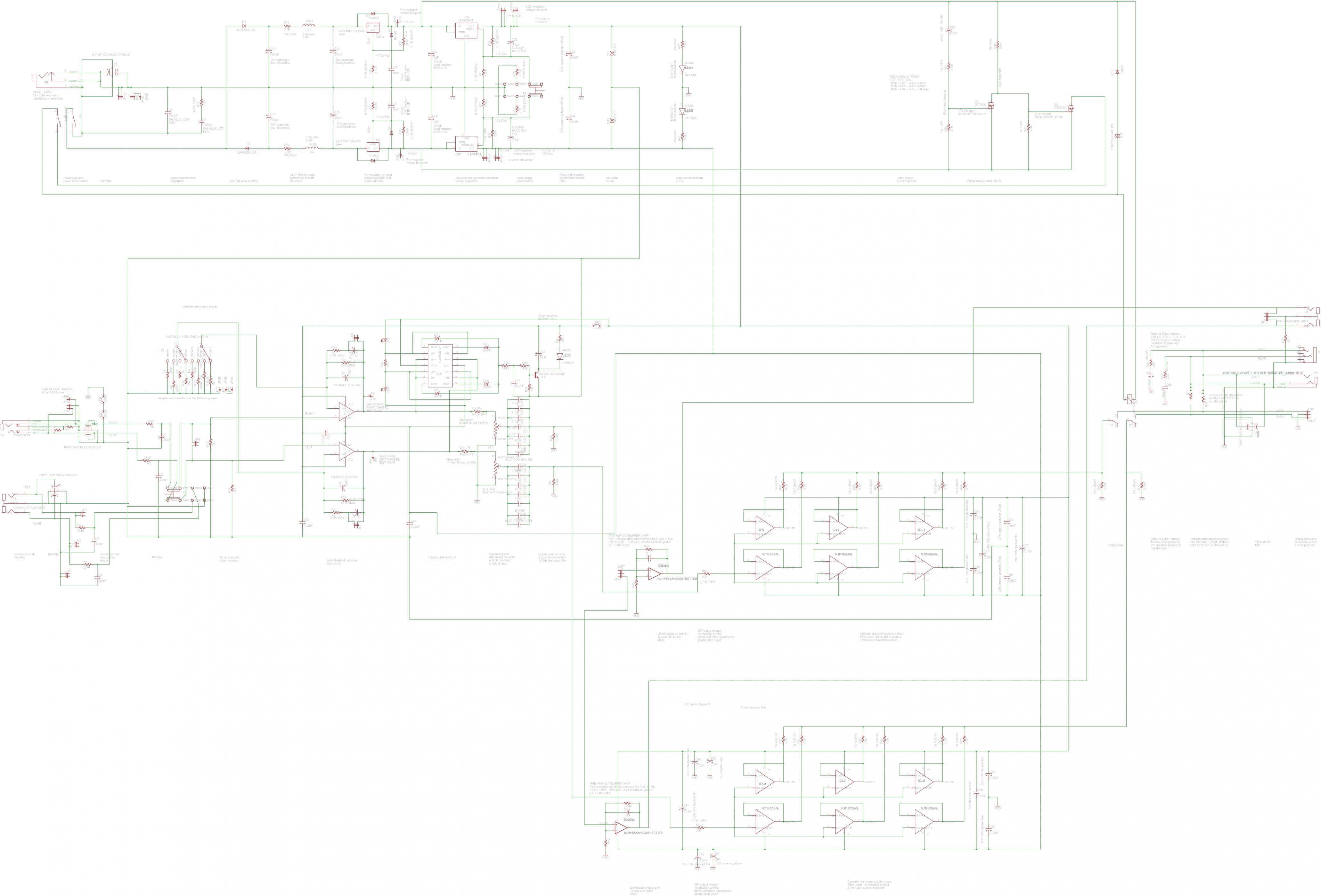

Well in some 4-layer news, I've already come up with one slick change that makes use of the extra routing layer. I'm modifying the relay circuit to do away with the separate 24V regulator chip and instead just tap into the +/-18.5Vdc from the LM pre-regulator chips. The relay is then changed to the 48V coil unit of the same G6A Omron series. The relay has a "must operate" voltage of 70% of the rated coil voltage, so 18.5Vdc x 2 = 37Vdc should work. I wanted to do that originally, but without the extra routing layer there was no way to get the connections back to the pre-regulators made, at least without more jumper wires.
But the win isn't just getting rid of the regulator chip. The new arrangement will prevent the headphone relay from operating if someone accidentally plugs in a DC adapter rather than AC. That would "light up" only one rail, with a resulting rail-to-rail voltage a few volts less than the 48V relay's minimum pull-in voltage on Omron's datasheet graph. I've always thought that these dual rail half wave supplies need that particular protection.
So the change adds "accidental DC power adapter" protection to the relay circuit, while keeping the existing turn-on anti-thump delay and accelerated break at turn-off.

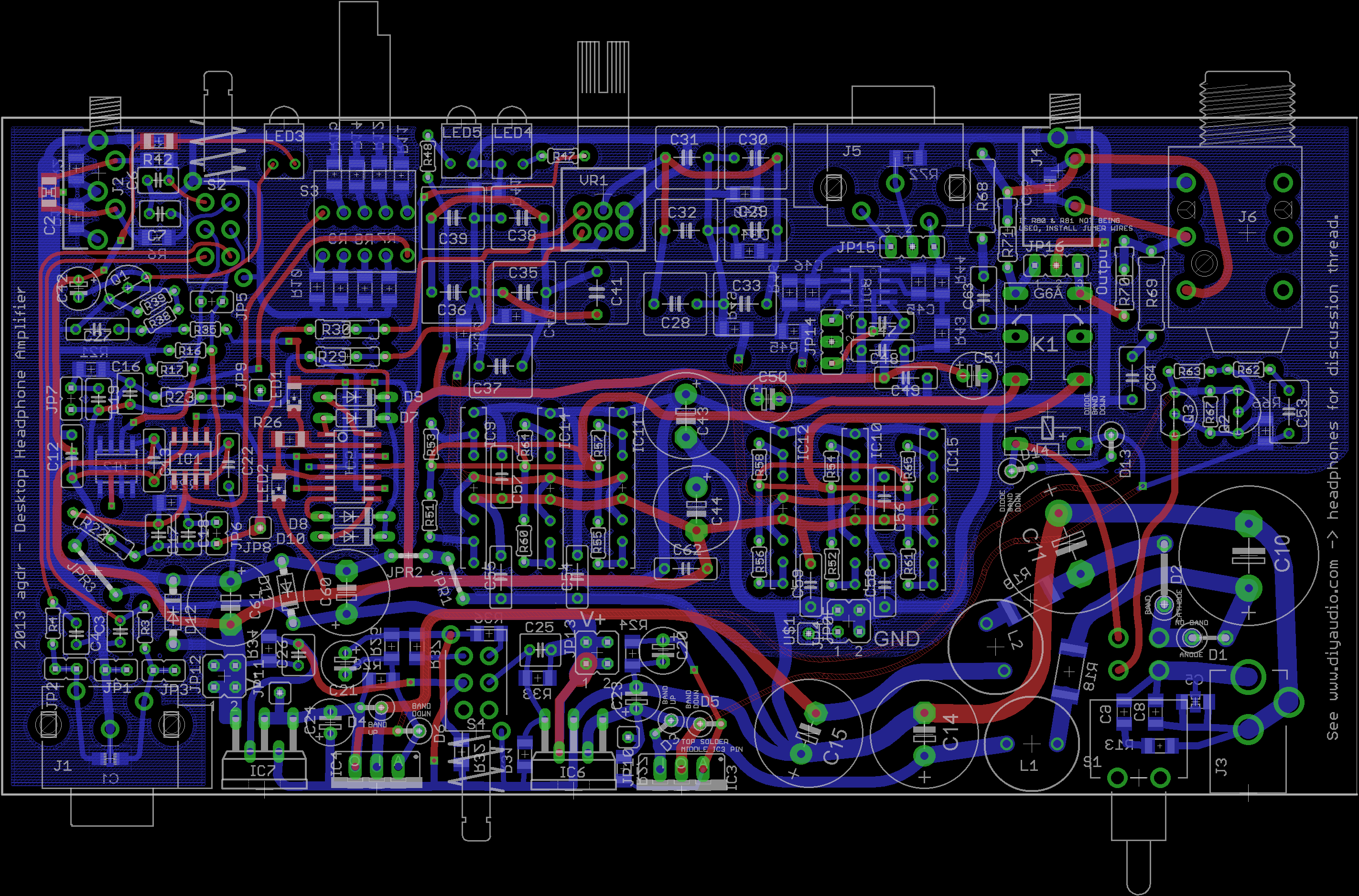

Something interesting on the 4 layer stuff. I was just studying the information on Seeed's site and I see that the inner layers are thinner - 0.5oz as opposed to 1oz on top and bottom - so the inner traces need to be wider to handle the same current. Perfect for what I have in mind, just some additional signal routing and the ground plane. The spacings are also different. The outer-to-inner is thinner than outer to outer, which may or may not make a difference depending on what is being done with the circuit.
Well it doesn't look like 4 layer is going to be difficult at all. :) I've left a significant amount of space between the ground plane and the traces to reduce the fringing fields. I'm leaving the jumpers on power traces since they can be top soldered as well as bottom soldered to eliminate via current problems. Saves space over just punching through multiple vias. '
The plane under the input parts will be connected to the input (clean / high impedance and low current) segment of the ground star, while the plane under the output parts is connected to the output (dirty / low impedance and high current) segment of the ground star. No plane under the power supply parts and no connection to the power supply reference section of the ground star, since there is nothing to gain and only noise to introduce.

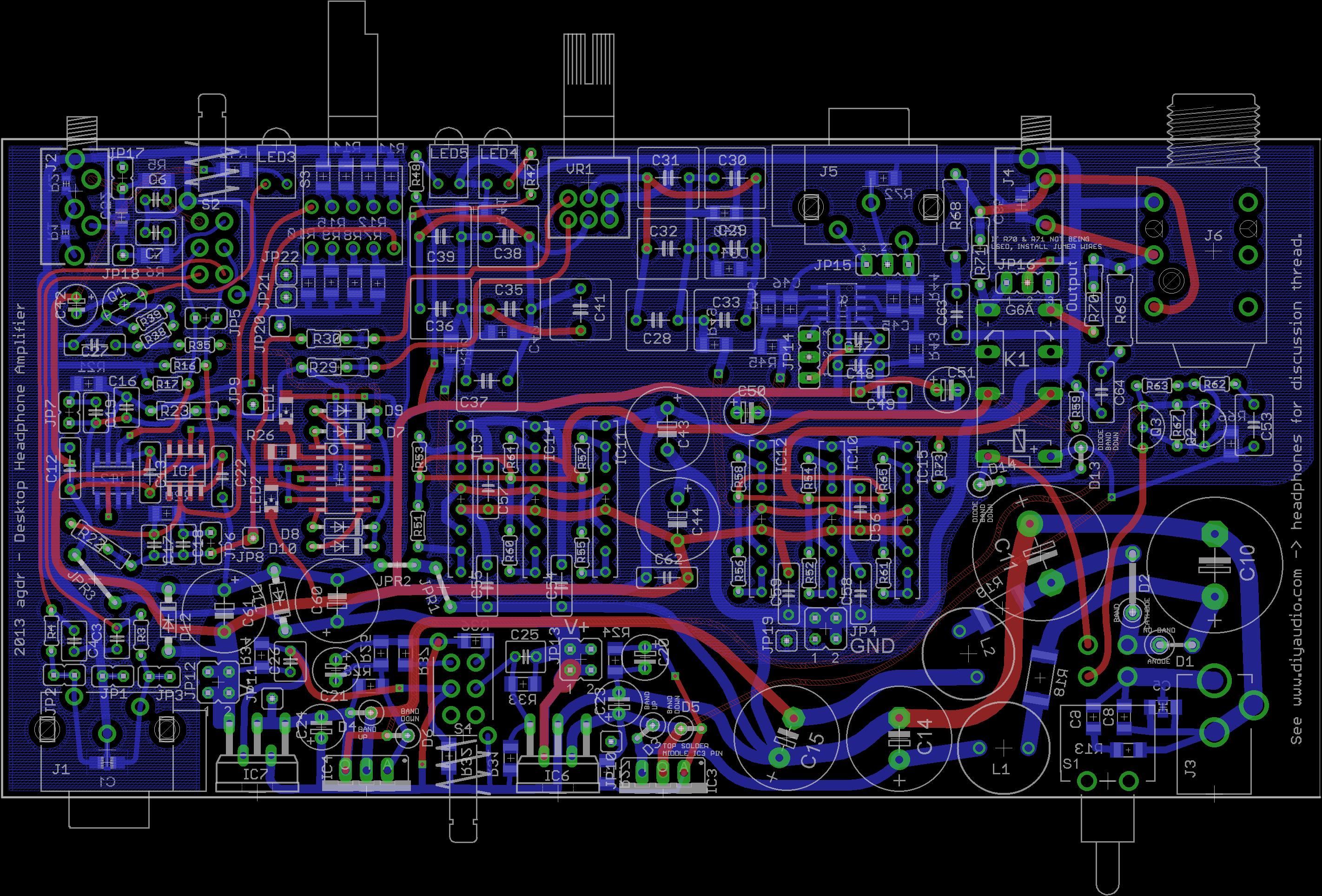

This one just went out to fab. :) 4 layer Gerbers below.
I double checked the whole layout and made a few updates. The gain switch and pot are now a bit farther forward. The 3.5mm input jack now has more spacing and the PCB holes for front external input (like an ODAC or front panel input jack) are back, as well as those existing on the rear RCA input connector. In other words, an ODAC can be wired into either the front holes near the 3.5mm connector or to those near the rear RCA connector.
If wired into the rear connector then the front 3.5mm jack still remains fully functional and switch-selectable with the front panel input select switch. That method would also make the ODAC output available at the rear RCA connectors, so they would effectively become an ODAC out (for pre-amps).
I'll post again once the boards are back and I have one built up and tested.

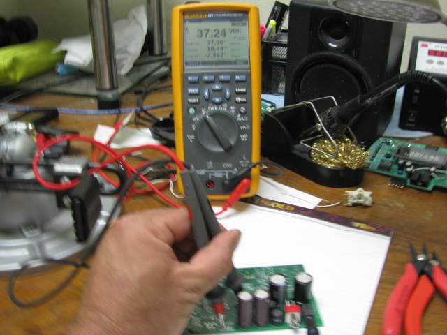

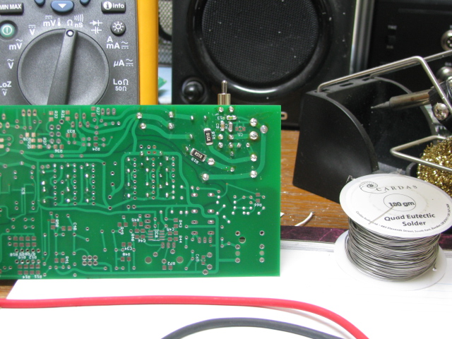

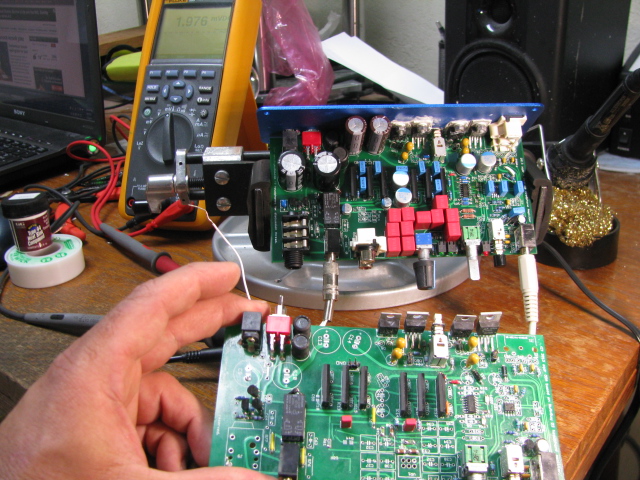

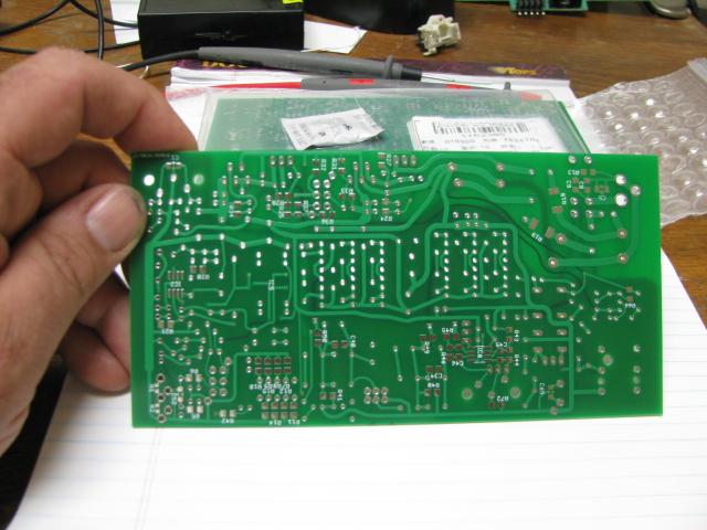

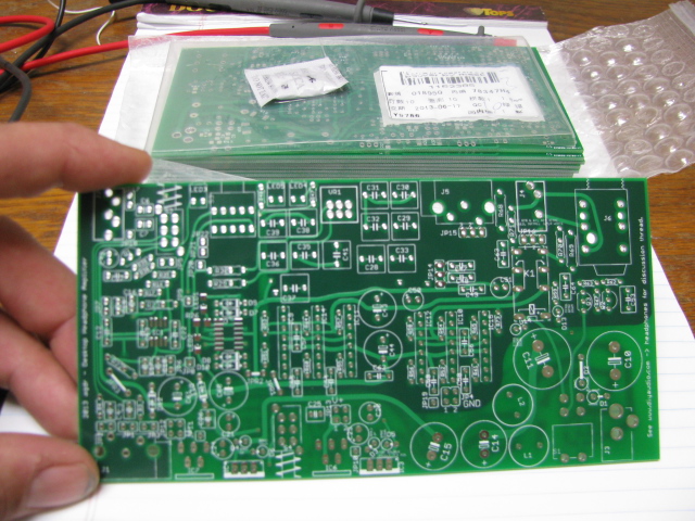

The boards for this project are back from fabrication already! Speedy. I have to say that I am extremely impressed with the results. Even nicer than the previous 2 layer boards I've had done. Super alignment, nice crisp printing, great surface finish. Maybe they spend more time on the pricer 4 layer boards, or maybe I just got luckier this time. :) The various 3rd layer traces ohm-check just fine.
I'm going to build one up and see if it flies. So far so good... The voltage on the meter for the positive rail is the correct answer, of course, for unloaded voltage off the caps with the 24Vac transformer and 121Vac on the primary from the wall socket.

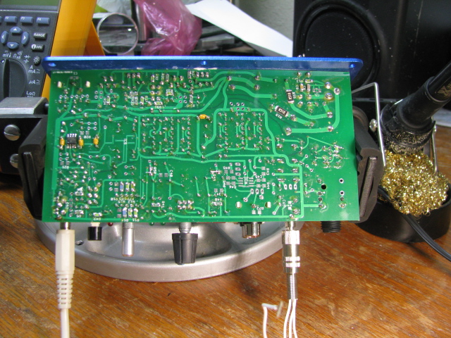

Well, it lives! :D In the photo below the new 4 layer board is in the vise at the top, with the old 2 layer board below (partially scavenged of parts). Sounds fantastic. I've been listening to a bunch of old Simon and Garfunkel songs with the new amp for the last hour or so. Almost fully built up. I can't find one of the 4.7uF caps, I need to order in LEDs or zeners for the clipping circuit reference (may try zeners this time) and need to solder in the pre-amp parts.
I'm want to do a bunch of measurements on it now, which I'll post. I want to look at full load power supply ripple on the scope and frequency response for a few waveshapes across the output load range.
The power rails were right on the nose with the meter. +7.023Vdc/-7.004Vdc and +16.092Vdc/-15.936Vdc. The output DC offset is +1.447Vdc on one channel and -1.630Vdc on the other, with the 0.5R output balancing resistors in now. The new headphone output relay circuit across the pre-regulators is also right on the mark. Exactly 6 seconds of delay, as before with the previous +24Vdc circuit.
There are no major screw ups with the 4 layer PCB! At least none I've found yet. I've also learned from another forum of an alternative place (to Front Panel Express) that has a 40% off sale, which would work out to be about half the cost of FPE. I think I'm going to test that (and my measurements) out and get the panels fabbed.
I'm still just flabergasted at the complete lack of *any* background hiss on this thing, even with the volume control fully up on the high gain setting. And that is using my uber sensitive AKG K550's. Every now and then something actually works out better than expected. :) During a full volume test at the highest gain setting this evening I thought that I was finally hearing just the faintest traces of hiss, right at the edge of hearing. Then I remembered that the input cable was still plugged into the laptop, which was on mute. Pulled the cable out, which grounds the inputs via the jack, and back to zero backgrouund hiss. That was the amplified hiss of the muted laptop output stage (the source) I was hearing, not the amp's internals.
