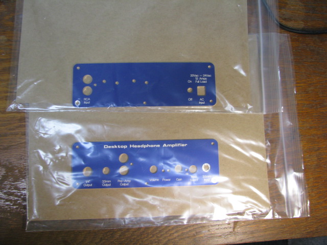

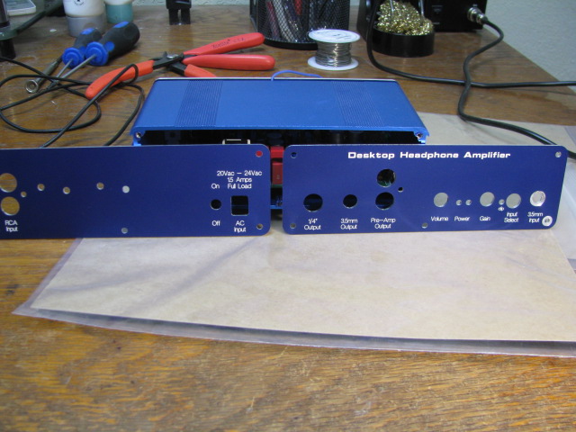

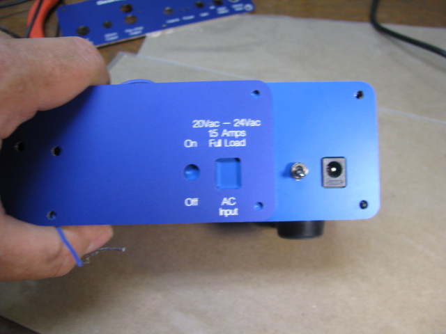

Panels and parts arrived
The set of front and back panels I ordered from cam-expert.com arrived today. The good news is the machining job looks excellent, and so does the fonts that I picked for the text. That bad news is that their color of blue anodization is more of a navy blue, while the B4-080 case (and the panel from Front Panel Express) are a lighter semi-metallic color of blue. Pictures attached below. In the last picture that is the FPE rear panel atttached to the box.
So... it would probably be worth the extra 20% cost to get the panels from FPE to get a closer color match.

Can you sent the panels that come with the B4-080 to these companies and have them just engraved for a lesser fee? Then the color would match?
Front Panel Express will allow sending them blank panels, but they only knock about $3 off the price. That gets eaten up by postage in sending them the panel so it doesn't save any money. But the color would be an exact match and the edges would be colored. If they mill the panel themselves the edges wind up bare aluminum.
I'll check with cam-expert to see if they allow sending in blank panels.

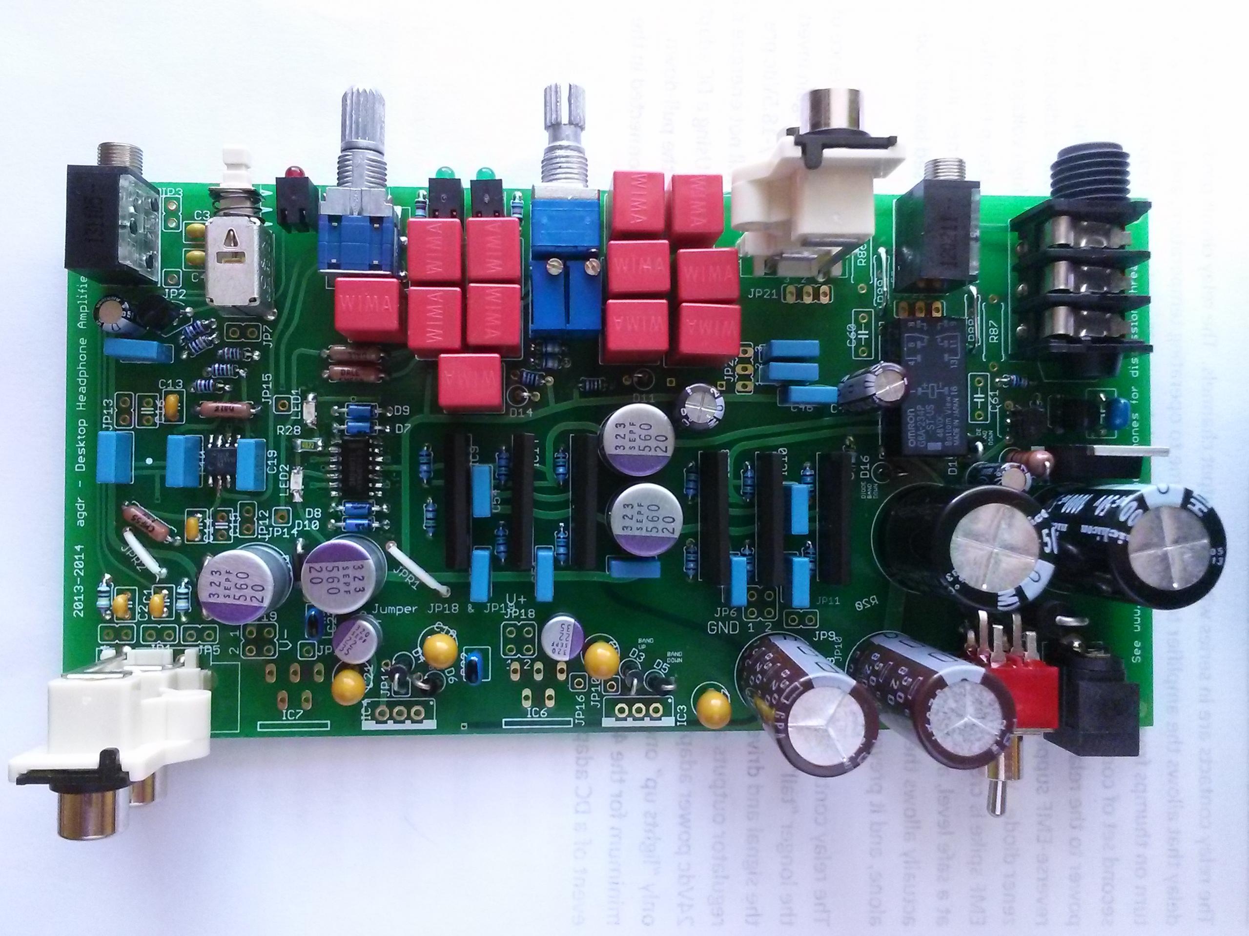

In other news I've starting building up another board and I'm taking high resolution pictures this time, as promised. They are at the project Google Drive link under photos->high resolution. Should be able to zoom those up a great deal to see detail.
I've also updated the build instructions at the Google Drive link. I've added a summary of what the ODA does at the top now, similar to what I have in the O2 booster board instructions.

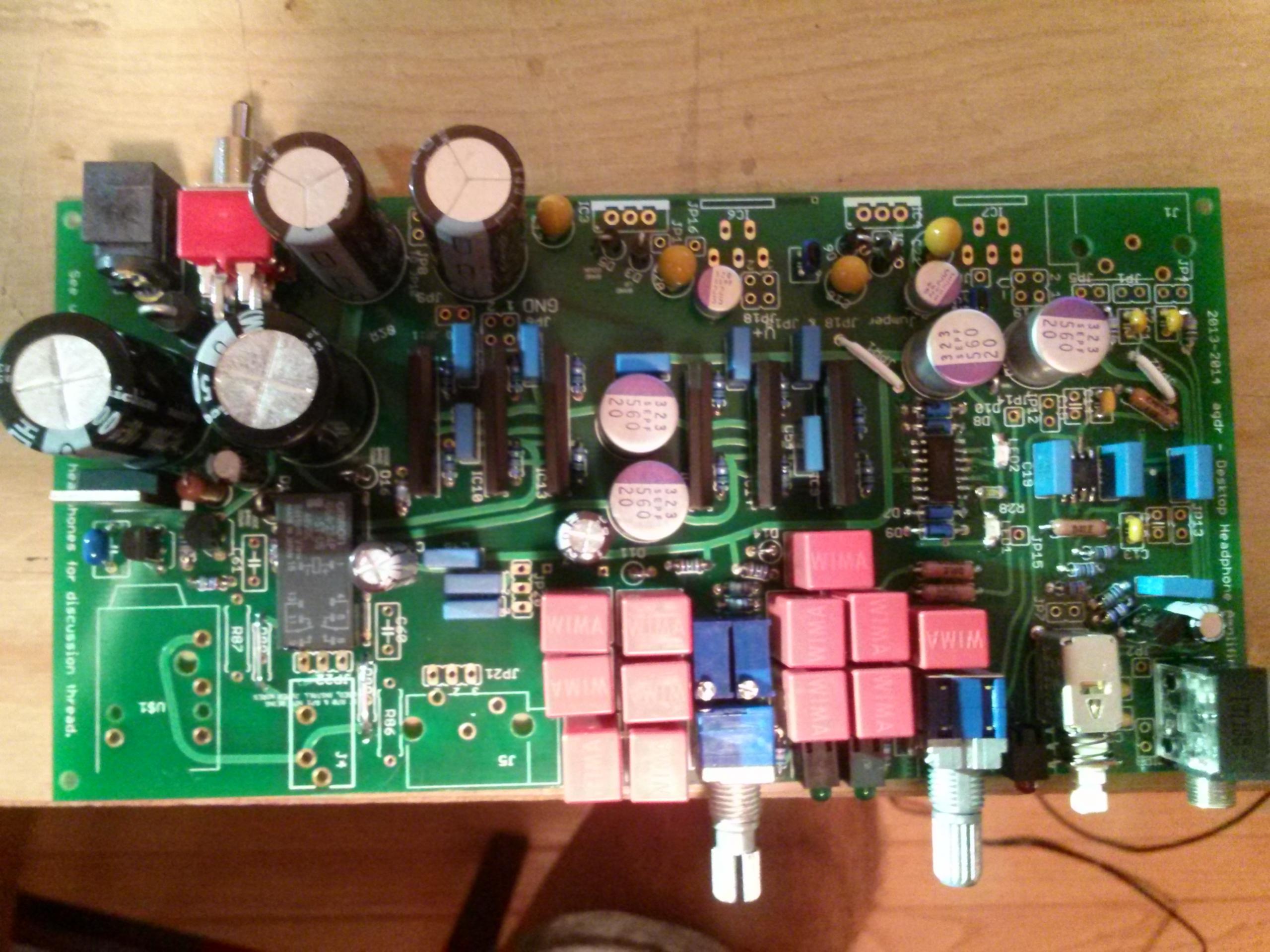

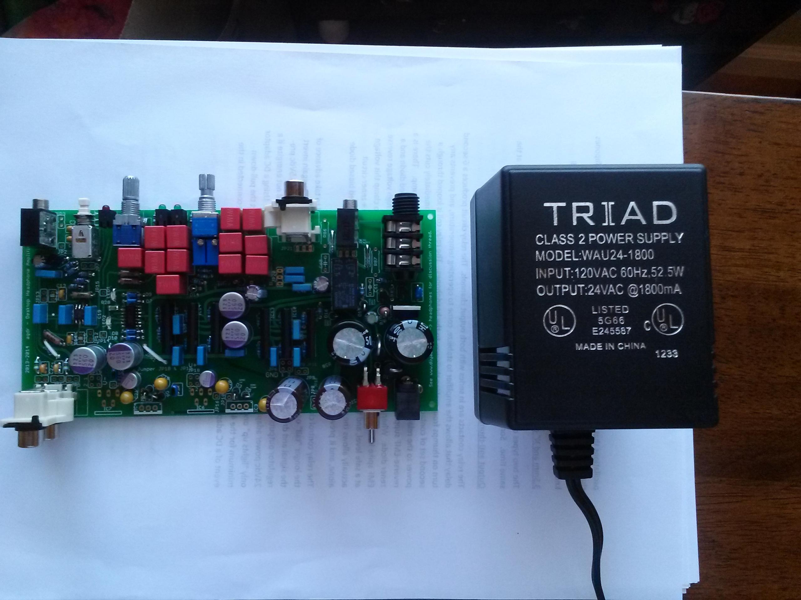

Well the care package arrived from agdr with the BOM resistor changes and the 24VAC xfmr arrived from Mouser with my T0-220 mount kits.
I applied power to the first step power area and checked the voltages and got +/- 35.8 volts and 47.7 volts dc for the relay and the relay clicked after bout 5 seconds...so its on to the final stretch!!
Heres a pix so far, still lackin ga few items...but really close!

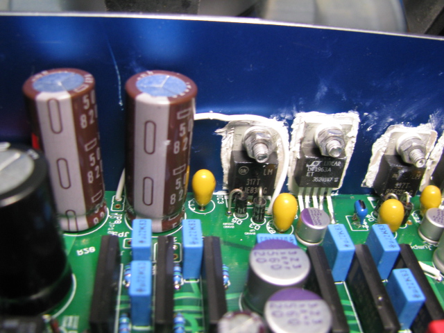

Alex - good work on your build! Those voltage measurements are right on the mark.

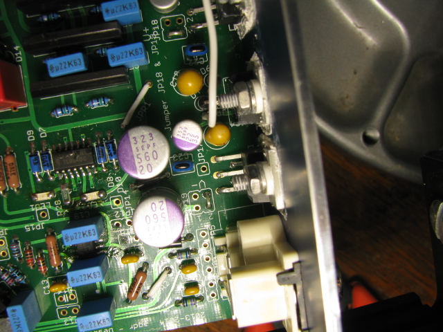

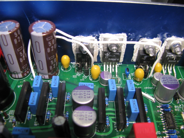

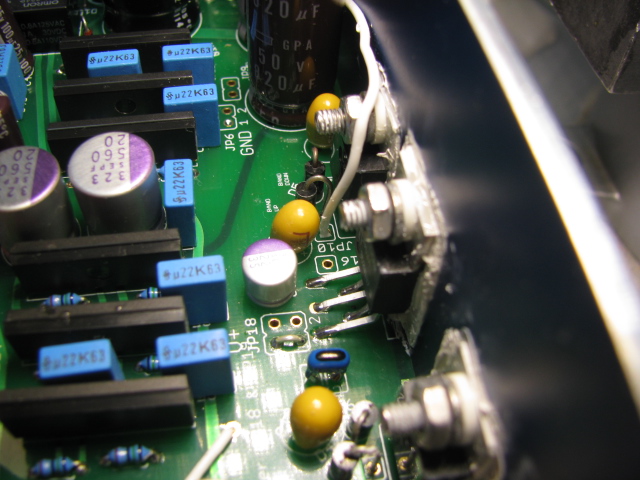

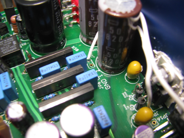

I've just realized that I never photo-posted what you need for the next step, connecting the JP8 bottom hole to JP10 and the JP9 right hand hole to JP11.
I have things set up this way just so I don't have to put traces with the power supply sawtooth wave right on top of the clean power traces going out to the amp chips. It is essentially a by-product of this "sideways" layout with the power parts all spread out along the back panel for heatsinking. Usually with power supplies the traces just flow from input at one side of the board to output at the other.
* The first 3 photos show a 22 gauge wire going from the bottom hole of JP8 to JP10. Route the wire behind C12, between C12 and the back panel. The big thing to watch out for here is that you get JP10, not JP16 which is right next to it. JP10 is the one in front of IC3. JP16 is just a test point on the output of the positive pre-regulator, which it goes into the final positive LDO regulator. Nothing connects to it.
* The next 3 photos show a 22 gauge wire going from the righthand hole of JP9 to JP11. Again the thing to watch out for here is that you get JP11, not JP17. JP11 is the one in front of IC4 (take a look at the Part ID diagram if the text labels are covered up by the parts). JP17 is just a test point again on the output of the negative pre-regulator, which it goes into the final negative LDO regulator.
In some other project news, cam-expert.com did confirm today that they can use the blank panels mailed to them. They knock about $3 off the cost. They quoted $36.50 for the front panel and $26.30 for the rear, plus shipping, for drilling and text engraving customer-supplied panels.

Is it possible to put the jumper wires underneath the board??
To make it a cleaner install?
Use shielded cable?
Alex
One idea here is to use some "spaghetti" tubing to slip over the two wires in the mid-section. I have some clear silicon stuff that would fit those just perfectly. May have some white too. It is perfectly OK if those two wires are right next to each other (in the tubing).
I do have some mini-coax, but after some tests it didn't make any difference electrically and stripping the stuff will make a person go cross-eyed. Then there is the problem of the shield accidently touching surrounding parts, expecially on the voltage regulator end. But a way around that would be to leave the shield a bit long, bend it back over the cable, then slip some heat shrink tubing around it.
Alex - or anyone else - if you would like to mess around with the mini-coax just let me know. I'll drop some in an envelope for you. They way it works is the center lead goes in the holes indicated in the photo build by C12, and the shield goes to the other hole, which is ground. Then on the other end of the cable (the voltage regulator end) it is just the center lead that goes in the hole. In other words, the shield is grounded at just one end.
So for example, with JP8, the center lead of the mini-coax would go to the bottom hole and the shield to the other hole. Then on the other end of the mini-coax you use just the center lead of the mini-coax in JP10, wiht the shield cut away. But you have to make sure any exposed edges of the shield on that end won't touch anything surrounding - hence that heat shrink tubing trick above.

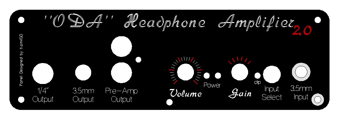

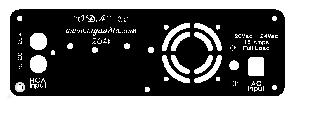

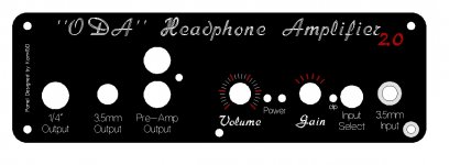

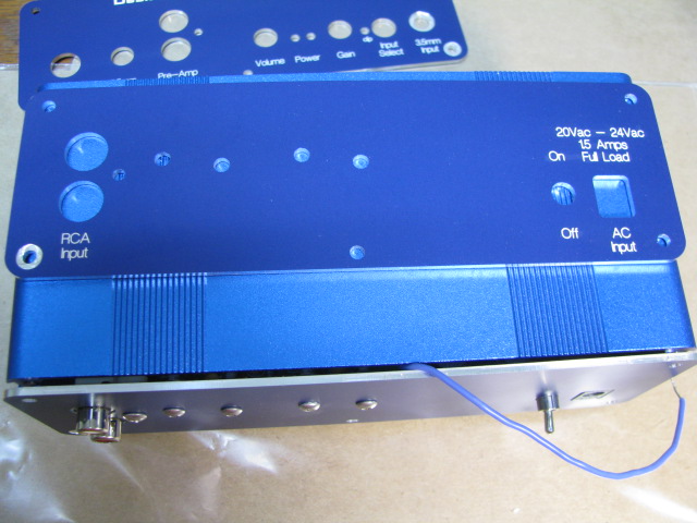

And heres the back panel for the ODA
I really like how those panels look! A (low noise) fan is good addition.
I've heard a lot from some corners about how fans are bad because they help build up electrostatic charge on the surface of components due to airflow and that the rotating magnets in fan bearings interfere with sound quality, but in the "objective" spirit I've never seen any quantitative evidence for that being true.
I'm a fan of Noctua fans in particular and have used them in various projects, usually with a temperatures sensor, since they make some small ones (e.g. 40mm and under) which only put out ~10db which is pretty much silent. They'd squeeze inside a B4-080BL enclosure, but probably not once you got the board in there and regulators heatsunk to the panel. You'd also need to make sure there was an intake somewhere near the front.
