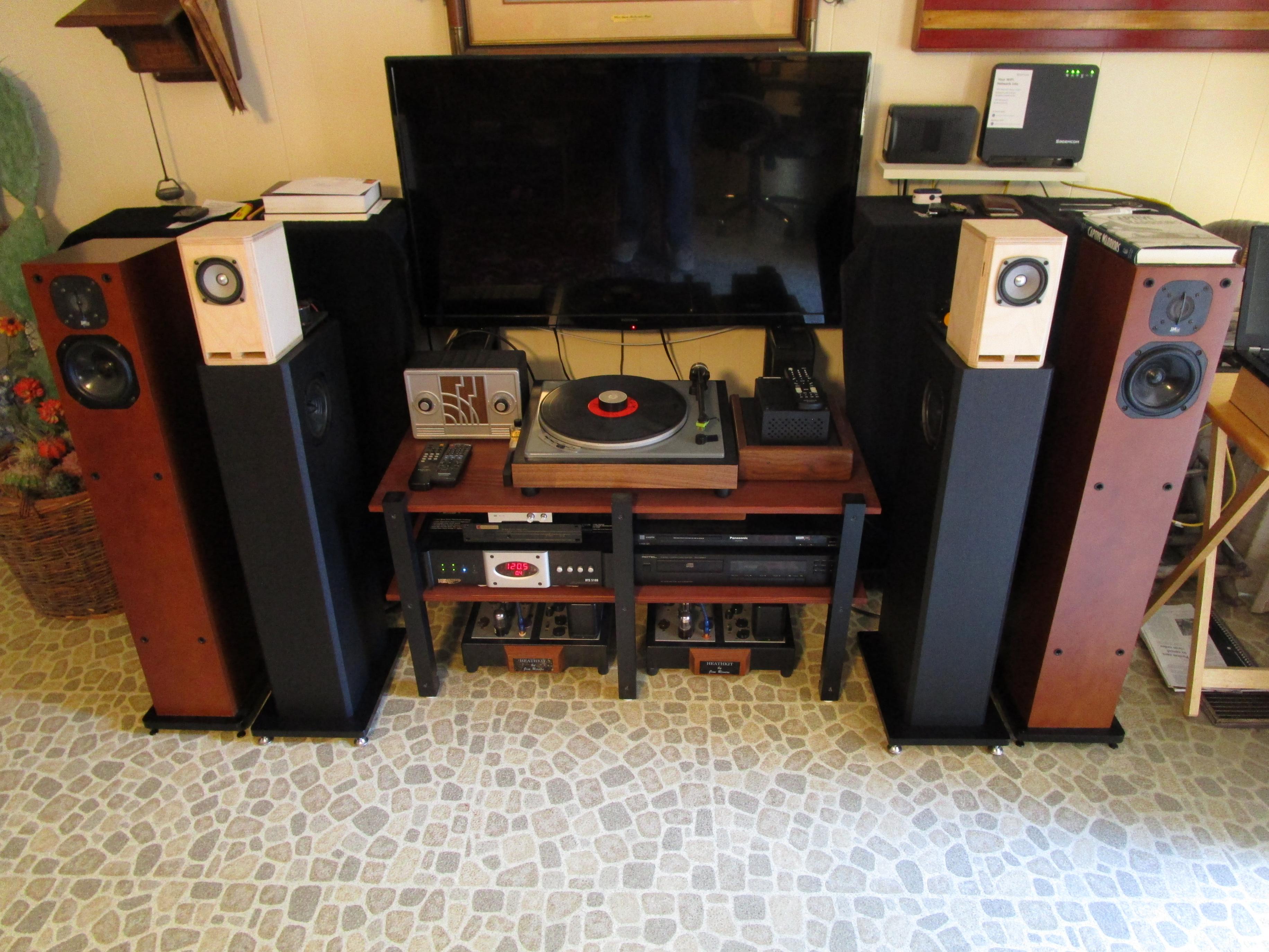

A proprt review will have to wait till i put back the music server back in (which Chris took out to make it easier for Ruth to operate when i was in the hospital). So far i have listened to one CD which was very good and lots of TV.

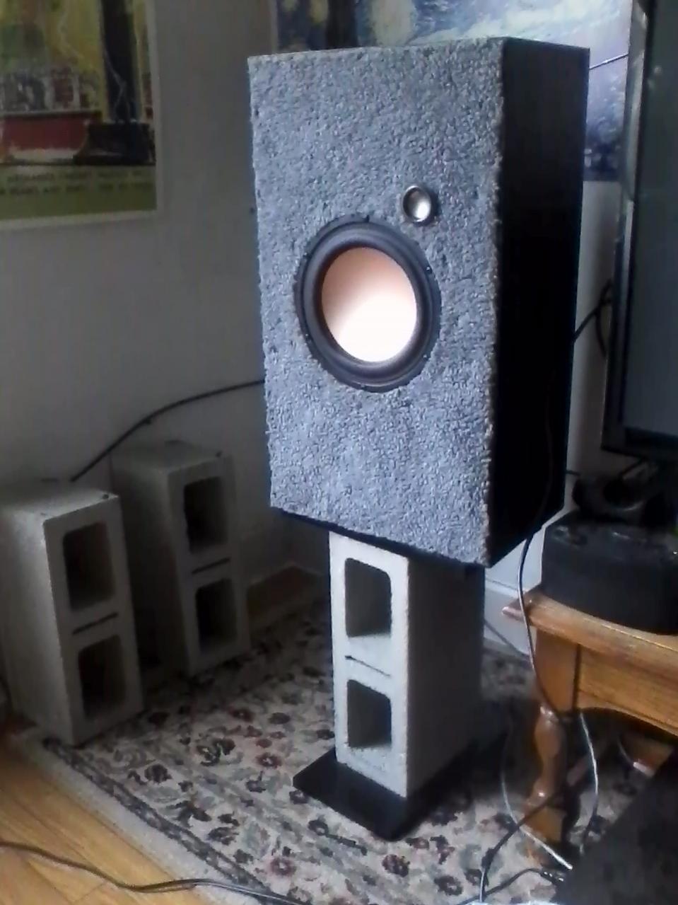

I have to say I'm impressed with some of the fast systems on here. I recently built a system using an aurasound whisper and hi-vi m8n.
What baffles me (no pun intended) is if you listen through a PC like I do, then why more people don't use the PC as the crossover? I use a simple program called equalizer apo and then duplicate the channels coming from the soundcard. So I have 2 identical left and 2 identical right channels. Then I use the equalizers to craft the FR of each driver. I cut off the bottom for the tweeters and cut off the HF for the woofers. I even overlap them at certain points.
This is all done in the digital domain, completely free of distortion and phase shift. I then send the signals to the amps. Pretty easy, perfect control. Only downside is that you can't use your speakers without a PC. You can also use this software to perfectly equalize out the response of the drivers.

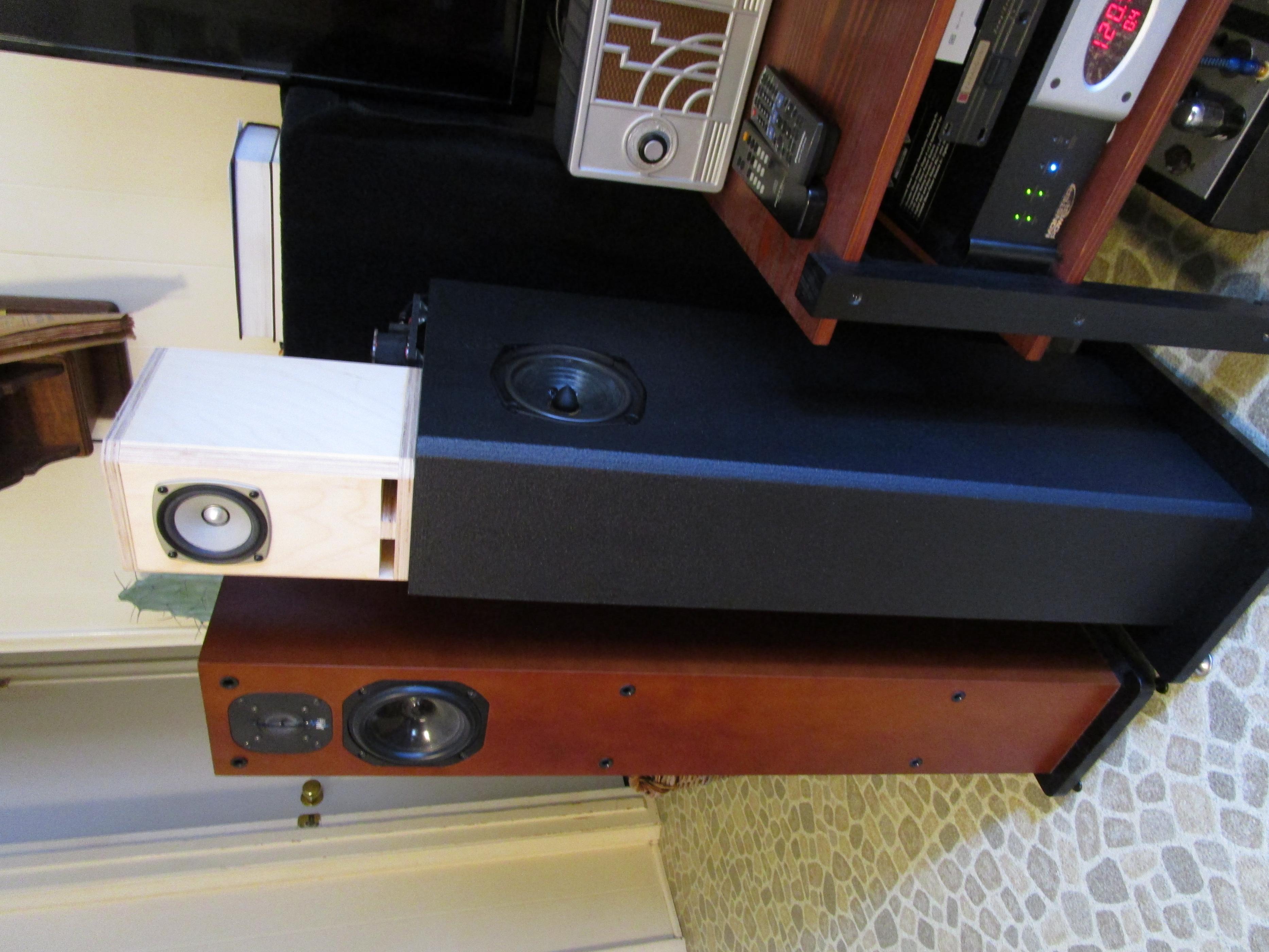

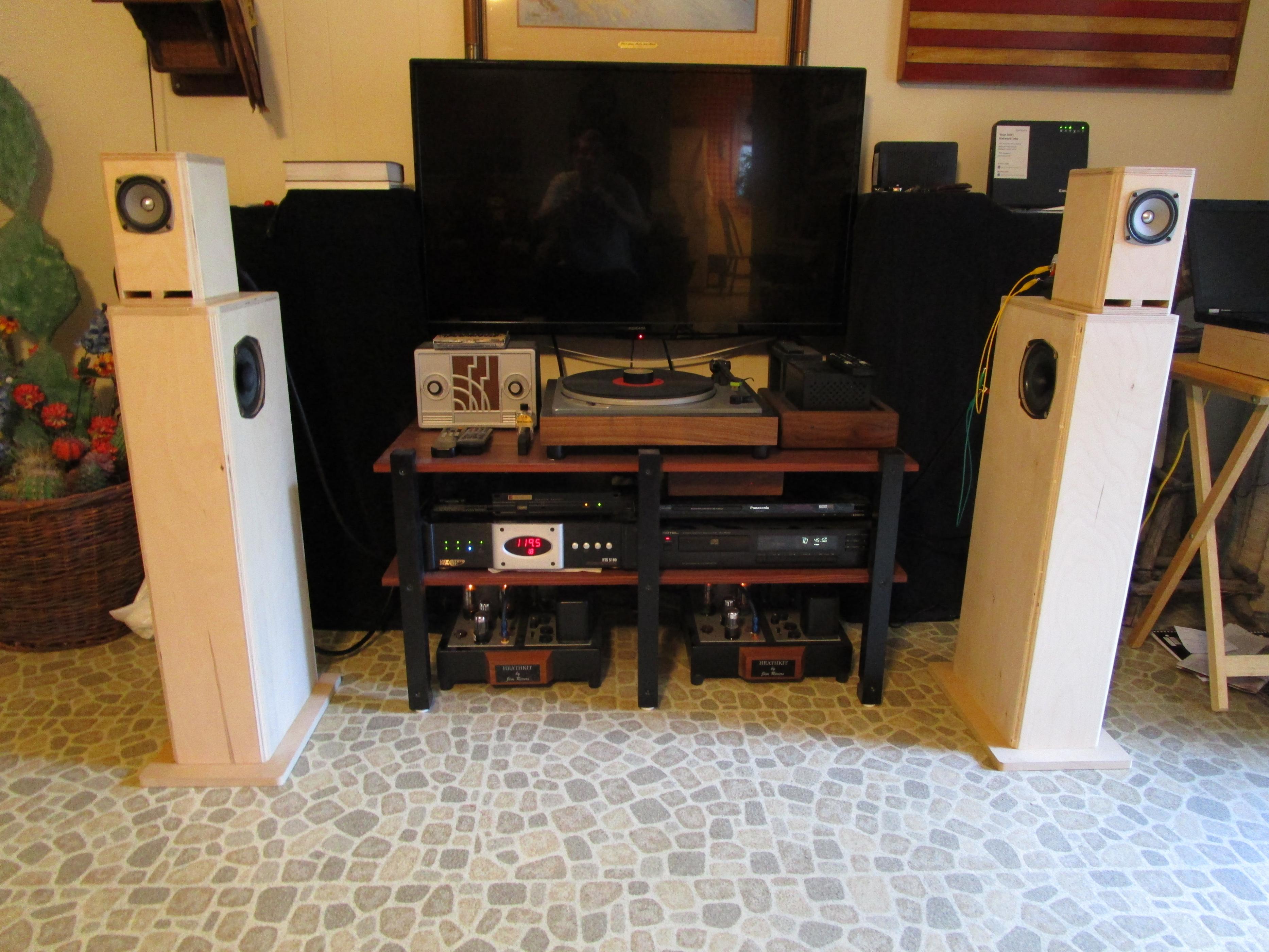

Stumbled on a small stash of RS 40-1354 so I decided to give the Tysen a try using what I had on hand. Since I'd already built the mini Onken from Planet 10 using the Fostex ff85wk I left off the top section from the plans. I was limited to 30" tall because that's the size sheets the local supplier had. Currently using a simple 1st order XO and bi-amping. So far I'm liking them. Thanks to David Dlugos for all the help and great plans.
Made some progress on my project using RS 40-1354 in a Tysen. After listening and inquiries, I determined that 2 of the 1354 in one box was too much unlike the recommended driver Silver Flute W14. Not wanting to give up on my project, I patched the extra hole and tried again. So far I'm pleased with the result. One thing that most impresses me is the clarity of bass lines. I de-whizzered, phase plugged, and Mod Podged my 1354's. While they don't go super low, I'm pleased with the amount of bass I'm hearing. I'm bi-amping, using SS for LF and tubes for HF. I just wish I could figure out a way to bi-amp and using my turntable. Thanks to David Dlugos for a great concept and assistance along the way.
