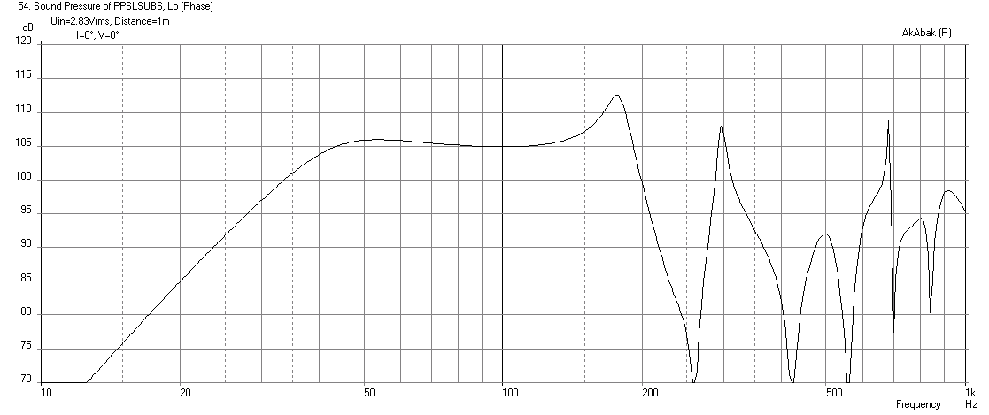

It is tough to get a PP 6th order slot loaded sub to cover 30Hz to 350Hz - the length of the slot will typically have a resonance cancellation at about 250Hz for a typical slot length necessitated by need to fit driver.
i heard that Les apparently crossed his ppsl higher but in all the threads i read i have not seen any measurements which would confirm possible extension into the 350hz range.It is tough to get a PP 6th order slot loaded sub to cover 30Hz to 350Hz - the length of the slot will typically have a resonance cancellation at about 250Hz for a typical slot length necessitated by need to fit driver.
would it be beneficial to open up the slot into a V shape to extend the upper range ?
but off course the question then remains what angle is necessary to get to 350hz?
Been there, done that...
http://www.diyaudio.com/forums/subwoofers/264737-pp-slot-loaded-sub-alpine-swr-12d2.html
There are some cool variants in that thread by Tb46, and all built by Lawbiding:
Sadly, still no 350Hz:

is that response a simulation? doesn't look like a measurement.
the alpine driver does not like playing high , couldn't find any real specs, but it looks like a pure sub driver from which i wouldn't expect higher extension.

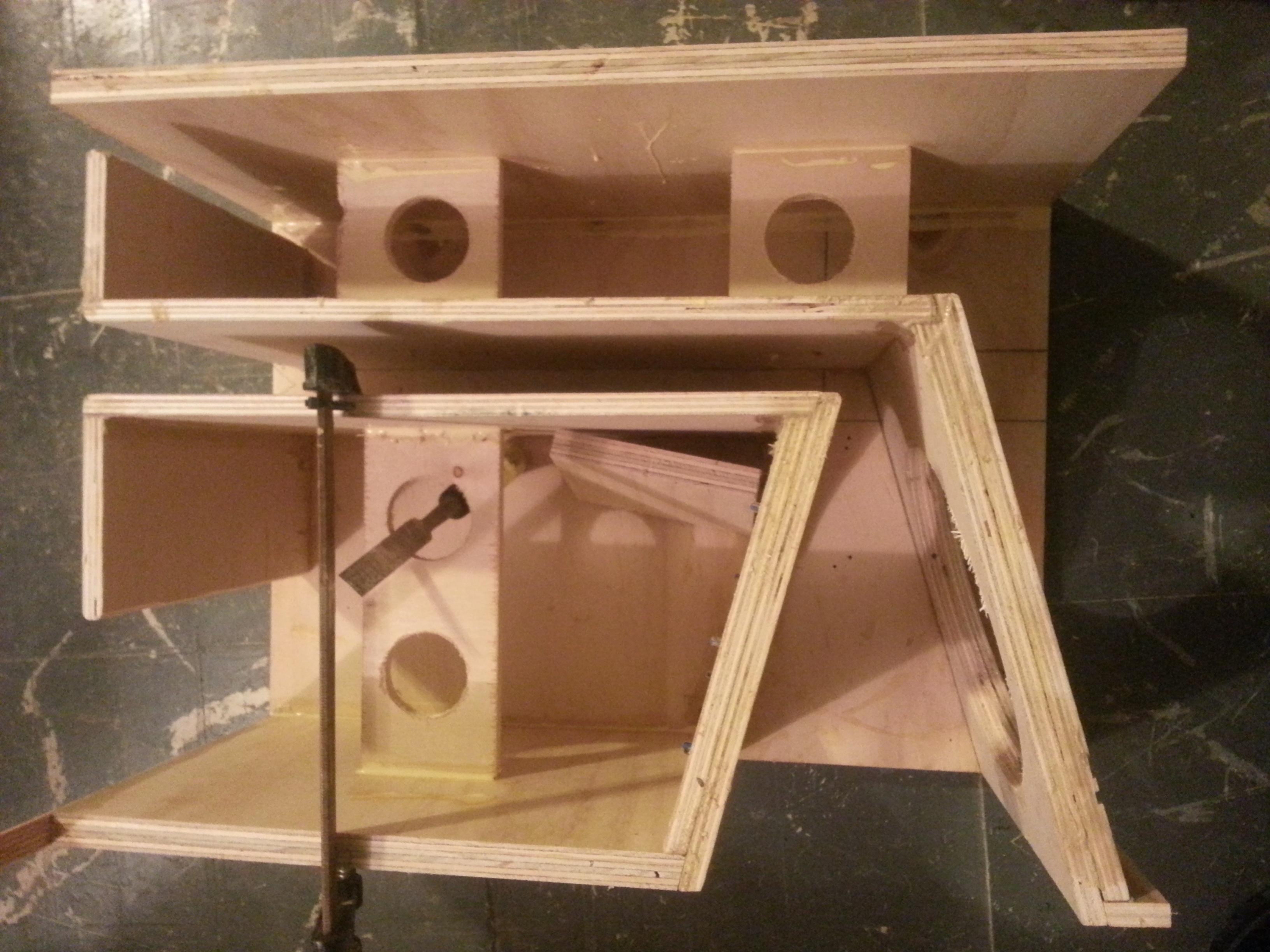

i would really like to see a measured response of the dayton ppsl that norman bates uses.
The center brace runs down the length of the port, across the back, and up to the front.

My latest PPSL, a 27hz quad-12 owned by Norman Bates!
That is a sim but if you look in the thread you won't see it exceeding this. It is not really because the driver is a car woofer - the cutoff is due to cancellation from topology and any driver will have a dip there.
that is bad news. i will have to build something else then i guess.

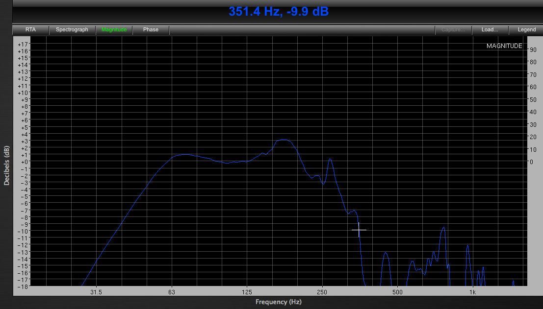

unless , there is someone out there who measured a ppsl going to 350hz ,
please let me know.
This one does 350Hz at -10 dB:that is bad news. i will have to build something else then i guess.
