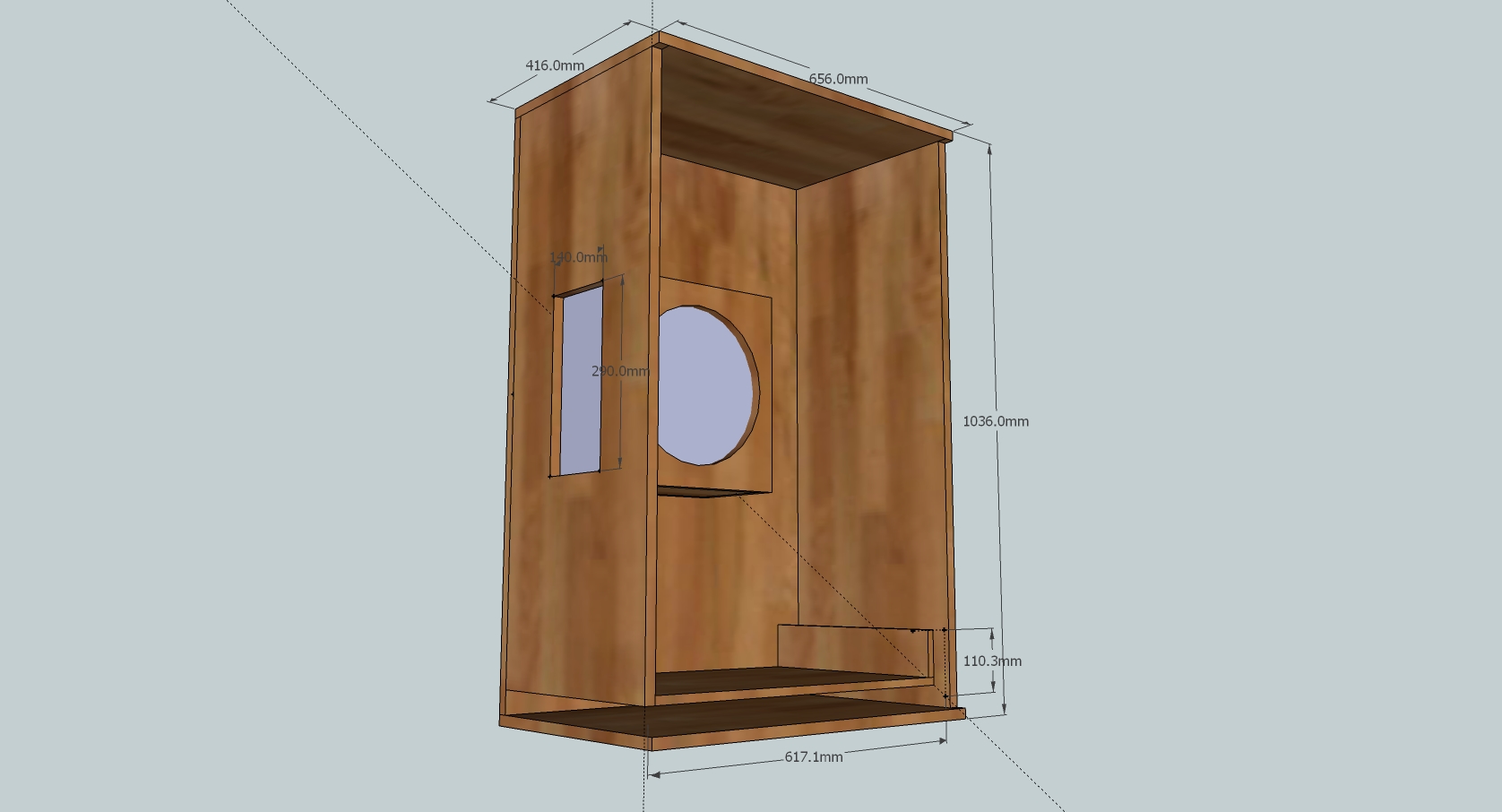

This dual 18" cabinet is my attempt to combine an older idea from DJK in another thread, to his PPSL design in post #115 of this thread. Perhaps I'm not moving forward properly doing this. Anyway, this is what DJK had to say about the W18N8-1000.
"With two FAITAL PRO W18N8-1000 in a 6th order vented alignment you can have a 40hz F3, 104dB/2.83V/1M, in only 4.5 cu ft (net).

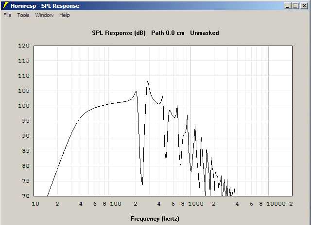

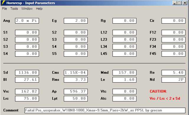

Hi grecon,
The 22.5" outside dimension should be about 24" as you are using 22.5" for the inside board heights.
Here it is in Hornresp (just as a simple BR) w/o the HP filter:
Hi grecon,
I would not widen the plenum, on the contrary, I would reduce the opening.
This box will need quite a bit of additional bracing if you want to take advantage of the maximum power capability of these drivers. Added bracing means (obviously) lost volume. A slightly smaller port would not do any harm, and the port length could be reduced depending on the HP filter used.
Also, I for one would be way to clumsy to mount these great drivers securely through the front entry of the plenum.
I'll attach a quick sketch that addresses some of these concerns, others might not find this helpful, so YMMV.

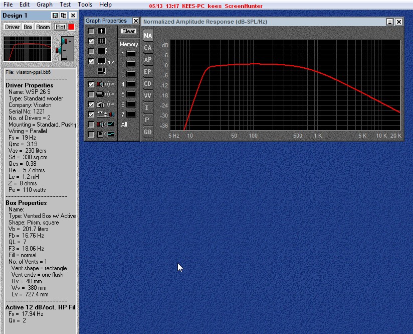

A time ago I did make this for the visaton wsp 26S woofers of 10 inch.
I have never test it but wil do this in future to see how this sounds,
it was for the home, not PA.
I have a friend who does metal music in a band, can you tell me what is best
as bass box PPSL, or Tapped horn or normal horn. I hear good things about the PPSL. He did ask me if I want to build a Bass, I think a sub bas is not needed in a metal band, dut a kicker type of box, from 35 hz and higher.
DRawns are for the visatons two in one PPSL box High pass material wood 1.8 cm thick.
thanks.
kees
