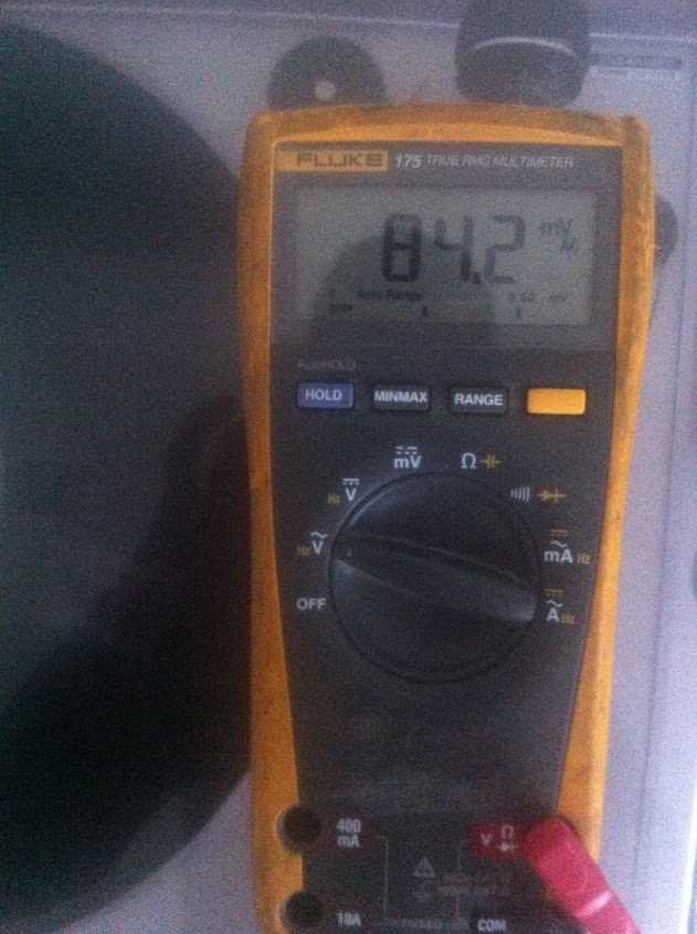

Ok tested again,
120hz file.
still a low reading I think.
I'm doing this test to determine if my next amp could be (something like) a SingelEnded triode connected 807 tube amp.
Administrator
Joined 2007
It does sound low but then again it depends on how loud you ultimately play your system.
If you have set the volume to the highest you ever use while playing music discs then assuming your DVM is OK, the test is accurate. That's the beauty of a real measurement test... it takes the guesswork out of the analysis.
That single ended amp could be a reality :)

The peak is 4x your measurement or 2.4 volts and the rms 2.83x
So you need an amp of just under 0.4 watts rms... which sounds low but its not really given efficient speakers or more modest expectations of loudness. (I typically listen at way below that)
or,
0.6*0.6/ which is 0.36 watts. That is the rms amp power needed for an 8 ohm load (which we are basing this particular method on) based on your measurements.
The secret of Pano's test is in the -12db chosen for the test file and how that relates to the max full scale level from a digital source.
Remember that what you are actually measuring is voltage... and for the quick calculations an assumed 8 ohm load. All that matters is that your amp can maintain that maximum voltage across your chosen speakers.
(Hope I've done the maths correctly ;))
Administrator
Joined 2007
It doesn't quite work like that.
The "power" isn't something the amplifier puts out directly, its the resulting power that the load (speaker) dissipates or draws. So you need to ensure that the amp you are looking at can maintain the 0.6 volts you measured down into a 4 ohm load.
Your measured results are valid for your speaker and you find you need 1.7 volts rms output to meet your requirements. If you connect an 8 ohm speaker across 1.7vrms it "draws" 0.36 watts. A four ohm would draw twice that, 0.72 watts.

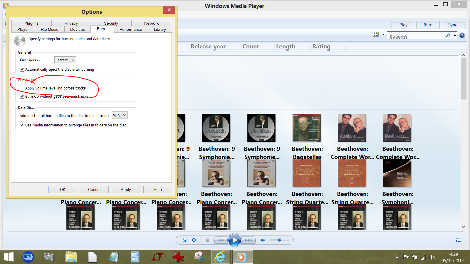

Joined 2002
Another data point: I measured 1.8V on the 120Hz track and a small fraction
less on the second on.
I had problem with the first CD I burnt on my windows7 box. It seems
Windows Media Centre by defaults does some level adjustment when
burning tracks and it came out much louder than it should have been.
Dennis
