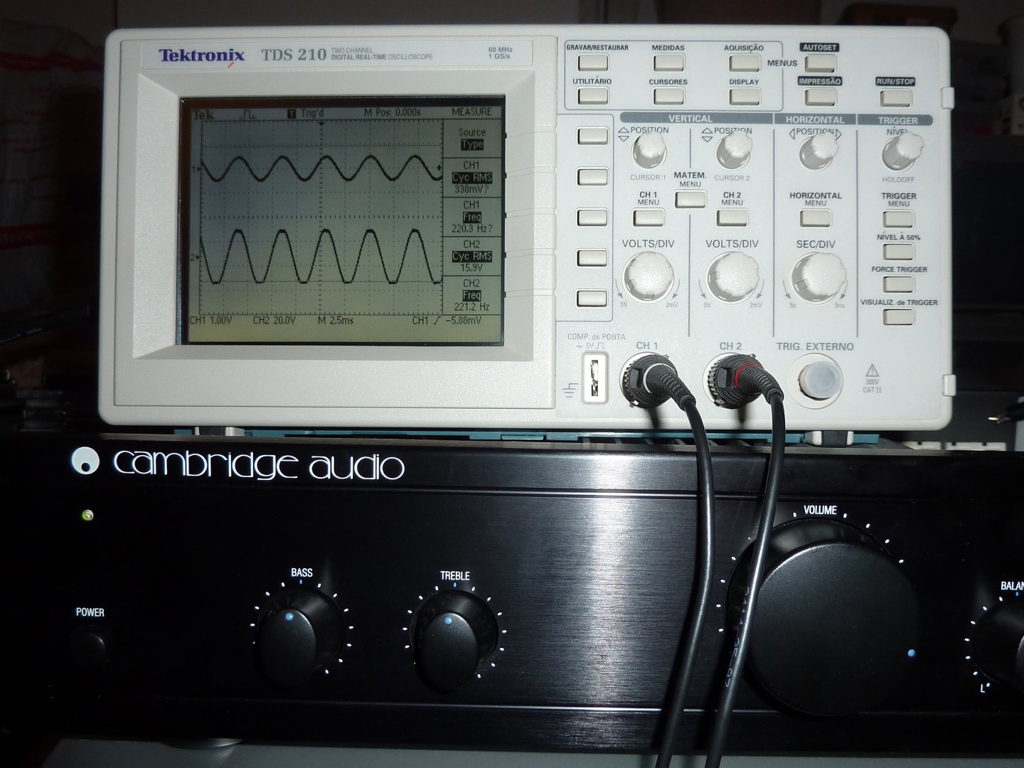

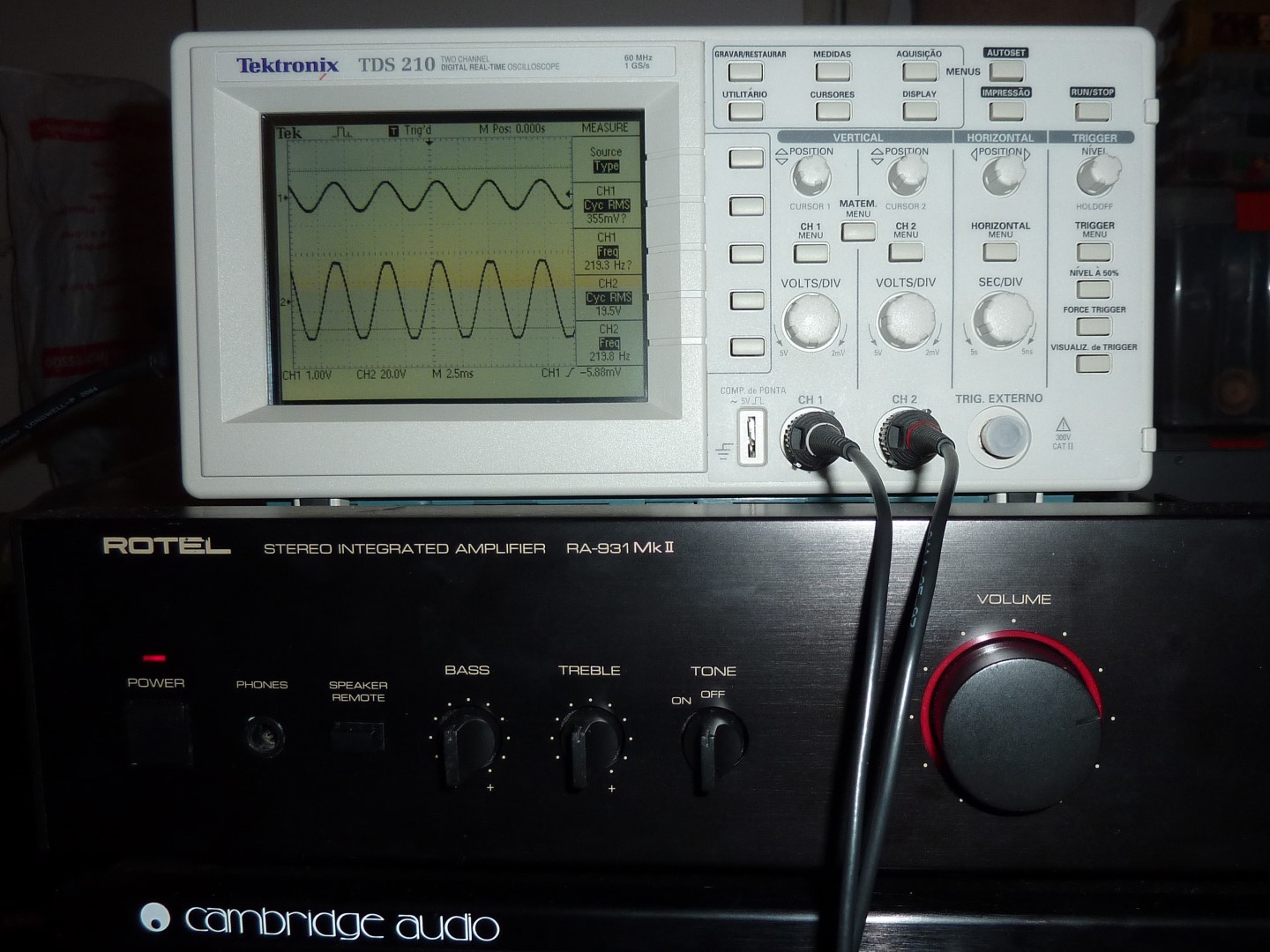

I would say that I'll need with each of this amplifiers, something around 5v at the output to have good listening level in the room (4.5m * 7m) were I use them.
How did you arrive at that number, and what does the 5V relate to? Do you mean that's the level of a -12dB full scale (-9db RMS) test signal at your loudest level? That seems to be confirmed by your later tests.
(approximated values)
Max voltage input: 170mv
Max voltage output: 18v
Max current output: 2.2A
Max power calculated from measurements: 40W
How did you determine maximum? Did you look for clipping on the scope, or some other method?
I would say from your measurements of the amps, the Rotel has just enough headroom at 11:00 The Cambridge may be clipping at the same SPL.
The method to find the maximum power was what you described.
Volume knob full turned, raising input signal until at the output of the amp the oscilloscope shows the signal clipped.
I only have a photo for Rotel RA-931, of the signal clipped (ch.2)
The Cambridge Audio A1 v3.0 is less powerful and I can set the volume, lets say up to 2 o'clock.
I didn't done a thorough test for CA1 as for RA-931, but when I got the chance, I can do the proposed test with the CA1, and take a photo of the signal clipped.

Tests done running the 220Hz audio track from a CD player, and turning volume up until the output signal clips. 8 Ohm dummy load used.
Tests done with:
- Volume up to between 3 and 4 o'clock
- Output signal clipped slightly above 15v
Rotel RA-931 MKII
- Volume up to between 2 and 3 o'clock
- Output signal clipped slightly above 19v
Since the input signal provided by the audio track recorded is around 350mV RMS, and that exceeds the maximum input voltage supported by each amplifier to attain the maximum volume without distortion (200mV and 170mV), surely that they had to clip somewhere before that.
Guess that this was the intend test on the first place. Or am I still missing something? :headbash:
Pictures attached are from fresh made tests reported here.
Regards
