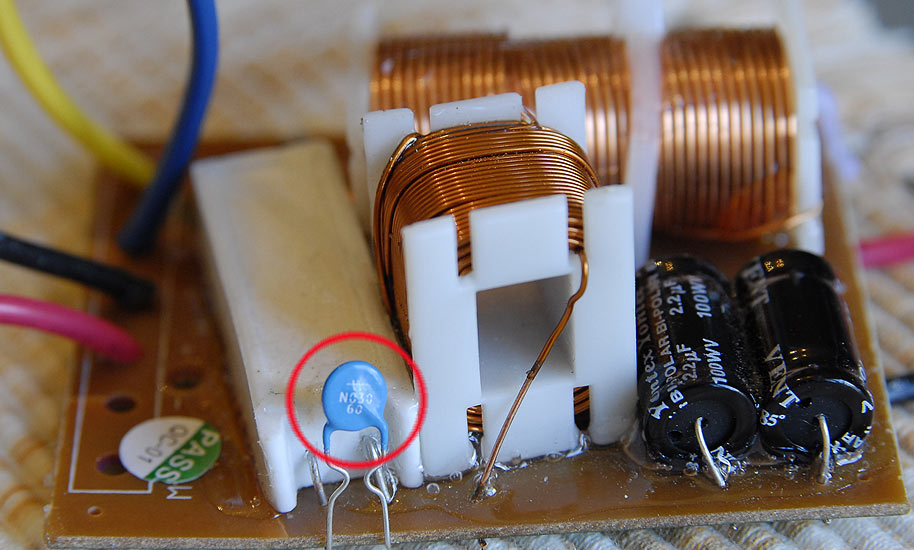

It could be a polyswitch (type of fuse) to protect the tweeter.
http://www.circuitprotection.com/polyswitch.asp
Timn8ter said:It could be a polyswitch (type of fuse) to protect the tweeter.
Ahh, gotcha ... so is there any benefit from removing it?
Timn8ter said:Probably not but it won't hurt to take it out either as long as you keep the volume level reasonable. Some may argue that it affects the sound. I can't see it having more of an impact than the cheap inductors and caps do.
Thanks, that's what I was wondering. If there's any potential benefit I'll remove them ... since I'm replacing the caps and inductors with Jantzen stuff.
