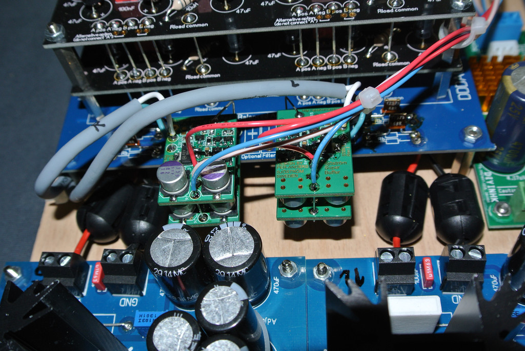

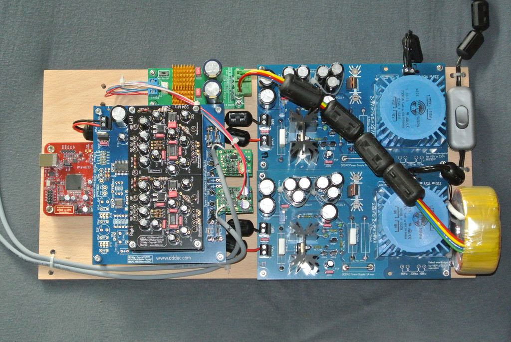

That are four diamond buffers from Per-Anders (Forum Member), more details see here.
Regards
Thanks.
Regards
Intresting build, some novel idea's here. Why are using all the line filters? Have you tried with and without the output buffers, how was the difference?
The line filters are to reduce high frequency. I also recommend to use a power line filter for i.e. Schaffner FN2090 and a EMI Power Cable i.e. Eupen GNML (with ferrit poweder around each wire and good shild) this helps to detach music from speaker, open sound stage.
With Buffer the sound stage increase, in addition i want to be unattached from the load, the DAC should 'always sound equal' to different load conditions, so this is out of my mind while play with different system setups

I used EMI filters in some builds, but was advised against them for the risk of smothering the PSU, which makes sense to me. Same goes for the line filters, there are mixed opinions about these. It also all depends on how clean your AC is and how much interference you have. Needless to say removing sources of interference close to the equipment or in the house is a good place to start as well.
I complete agree !
On other Hand the Primary Current of a DAC or Preamp is very low (Let's say 23 Watt ~ 100mA at 230V line volatge).In addition there are a lot of filter and sotrage capacitors which need to make DC voltage, at least my consideration was that i don't expect that a EMI Filter smothering in this kind of application... an power amp is different story.
