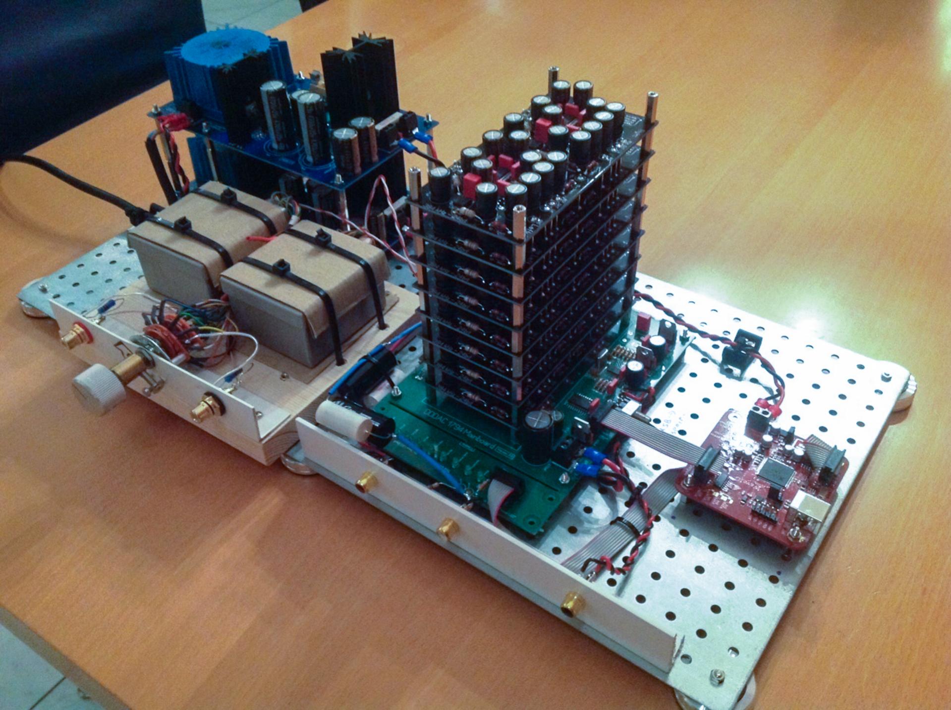

Tomorrow is test day with my Audio friends. Just wanted to share latest Info on the SPDIF input and multiple decks. Did some final in-house tests with the following Setup (see Image):
Double power supply, the latest 384 kHz WaveIO with Version 2.15 Drivers, the new DDDA1794S (s for spdif :D ) and.... a preview of a TVC, based on my own Sowter transformer :cool:
So far everything works 100%. USB up to 384kHz, the spdif up to 192kHz and all with 8 decks and no HF compensation :)
The standard DDDAC 12 Volt power supply can feed as expected 8 decks, but it is the limit. Current is aprox 950mA when playing high resolution Music. Tranformer and Heatsink become like 45 degrees.
Will report back over the weekend on the sonic side of things
I will also publish the first circuits PDF, so you can see how I implemented the WM8804...

I see in your photo has two outputs, caps filters and Sowters with passive volume pot...
no pot... a TVC (Transformer Volume Control). In this case 12 secundairy windings. Specially at normal listening levels, this results in very low output impedance, driving the next stage with extreme ease. Result is very detailed Sound
