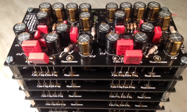

Hi guys,
I just finished building my 4deck DDDAC and I have a very strange problem. The output sounds like a badly tuned radio with a lot of static. When connected to an oscilloscope, it seems like there is a lot of digital noise (large signal steps) at the output (hard to see them clearly since I use an old analogue oscilloscope). I have the same problem with SPDIF input as well as with waveIO.
In thread 322, I have read about an issue with loading the I2S bus too much in case of 8decs which resulted in what looks like a similar issue. However that was with 8decs and I'm using only 4. Do you think that I might have the same problem? I checked the I2S signal by an oscilloscope after the resistors (directly on the top deck) and the amplitude appears 3.3V so it doesn’t look like the lines are being pulled down too much. I don't have a 5V regular available at the moment otherwise I would have tried swapping the 3.3V regulator as described in the mentioned thread. Can anybody think about something else that may cause this kind of problem?
4 Decks is absolutely stable. 8 decks can be instable,(fix is on the way) but it never that strong as like what you described. Therefore we need to take this as an individual issue. Please send me an (normal) email and we will take it from there. There are a couple of things we need to go through to diagnose the Problem

Had the same problem here with 4 decks. Doede´s advice was to increase the i2s voltage on the "motherboard". Problem solved with a +5v belleson!

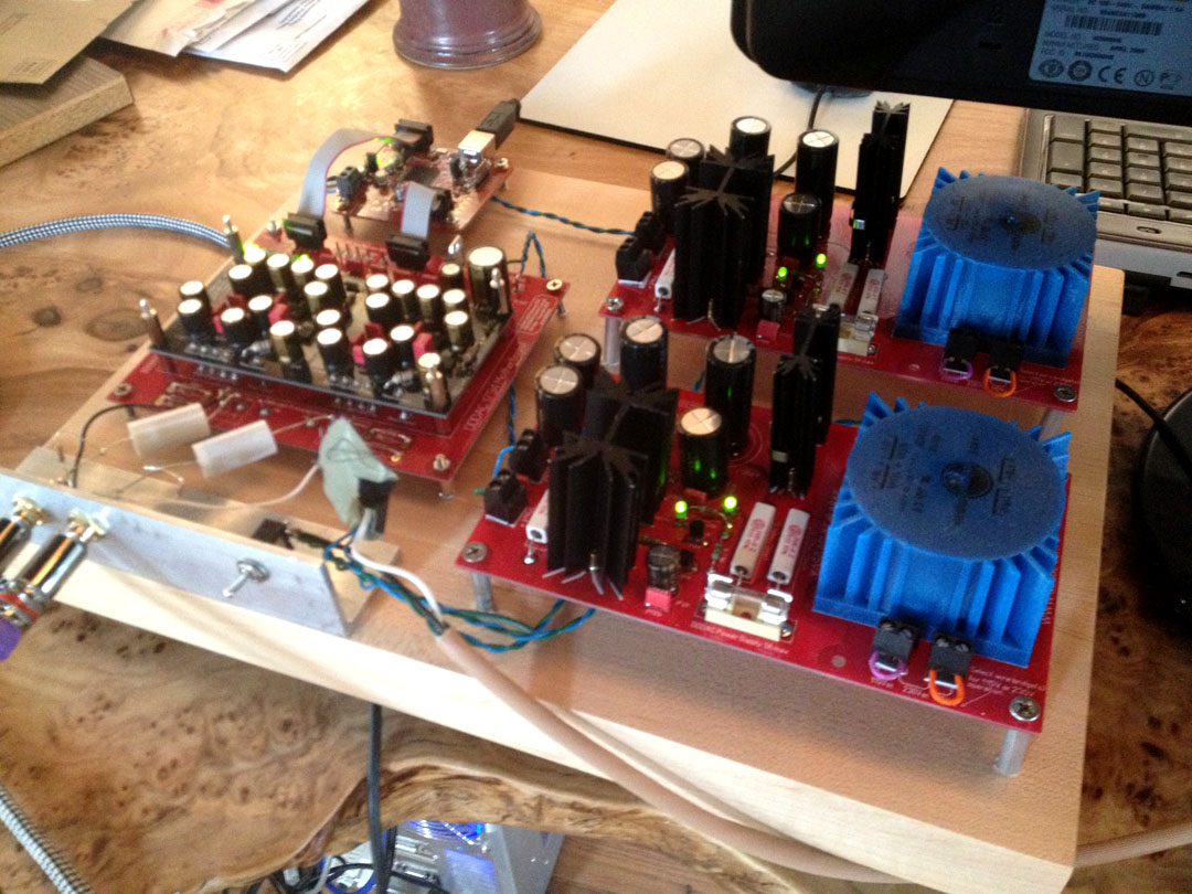

Noise problem finally "solved"
I finally managed to "solve" my problem with digital noise at the DDDAC output.
The problem was that I was going for a kind of unconventional build of the stack with two decks above and two below the motherboard. In my mind, this was supposed to be better for summing and distributing the signals since the wires were shorter which meant a tiny bit lower inductances. However, I ended up having very strong digital noise at the outputs. This phenomenon looked like rectangular steps superimposed on top of the main signal. Noise was mostly present when the amplitude of the signal was low, still it was very audible at the output. The situation was worse with SPDIF board (the board designed by Doede for DDDAC 1543) than with WaveIO. The noise became also much stronger when the BCK signal was touched by any kind of measuring instrument (multimeter, oscilloscope probe). I tried many different things. Some of the modifications reduced the noise but it was never really removed. At some point I found out that the stack works perfectly with 3 decks and the removed deck worked well by itself as well. When I ran out of ideas and decided that I remove the bottom deck and run the converter with only 3decks, I had an idea to try to connect the deck which was removed to the top of the stack. I was very surprised when turning the converter on, the noise was completely gone! To say that I solved the problem may be a very strong claim since I don't know what was the problem in the first place. For now I run my setup with 3 decks above and one below the motherboard and all is well.
I have also something to say about the capacitors between the A and B channel. I tried this as one of the solutions to my problem. It didn’t really work, but when the problem was finally solved the difference with and without the capacitors was very clear. Apart of the difference in sound, where before were quantisation steps in the signal when measured; now everything is very smooth. In addition to that, before when there was no signal played, the noise floor was +/- 2 quantisation steps wide. After adding the capacitors, the steps are not there anymore and the noise is closer to zero.
I hope that some will find this long story interesting and that someone may have an idea what was really wrong in my original stack. Thanks to Doede for email support, some of the ideas were very inspiring even though the final solution was very unconventional.
