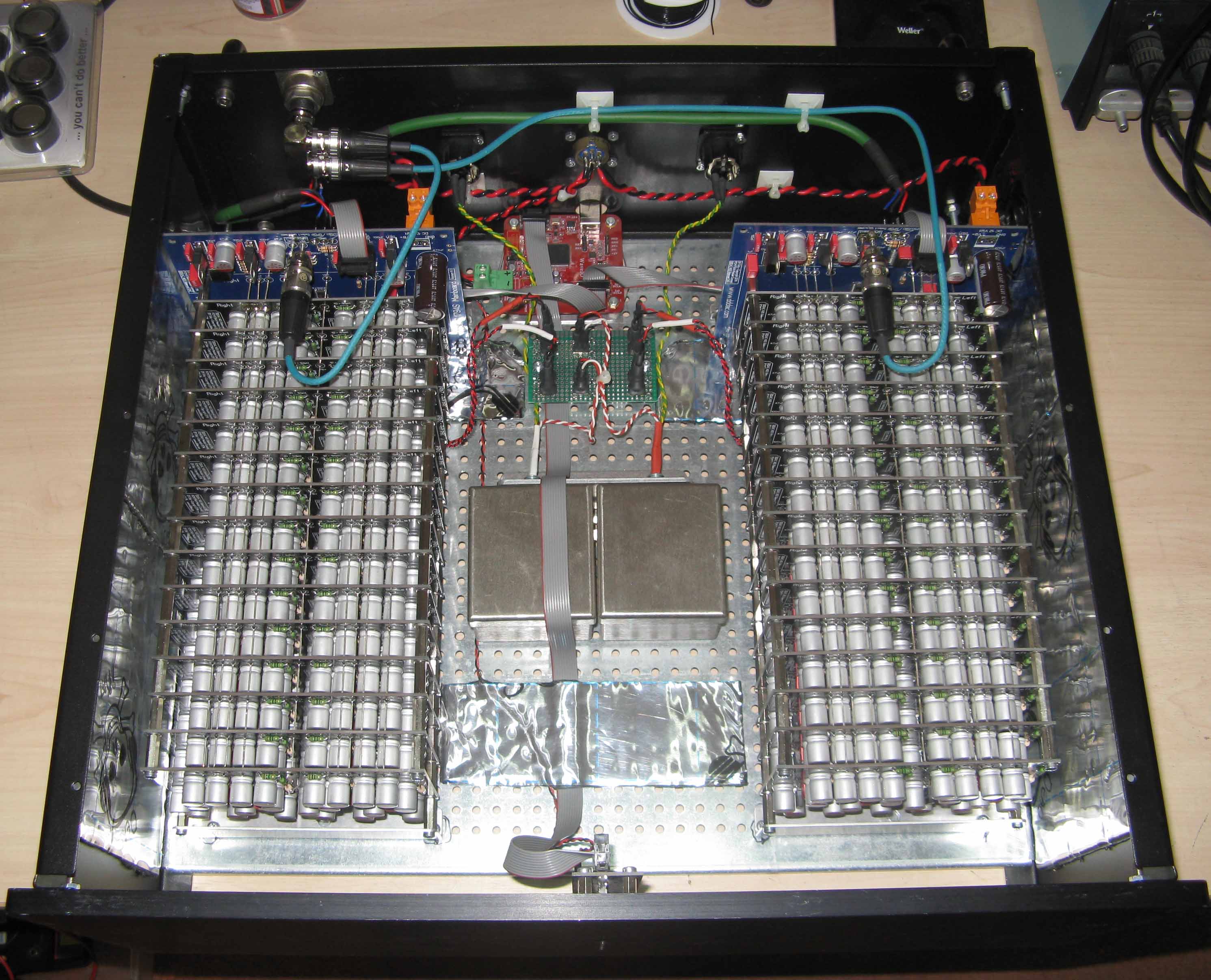

I am going to declare that my DDDAC journey is now over :)
30 Dac boards total with the following alterations:
All electrolytic capacitors Nichicon Polymer FPCAP 50v as I leave the Dac powered up permanently.
The 6k pin 20 resistor is a Charcroft S102J 0.1% for stability and low noise level.
I had a pair of 1-1 Sowter transformer made as I do not need the high output voltage and probably gained a little but of bass slam into the bargain :)
The IV conversion once again Charcroft resistors are the CE-VSR6 for the extra dissipation.
I was hoping for 32 Dac boards total but I fell foul of the I2S maximum length rule ... so 15 standard boards each side seems to be the maximum.
I did try the Tent powered boards at the top of each stack but the I2S problem reared up again so off they came and replaced them with the standard ones and all is OK.
It would be an interesting experiment to see how many Tent boards could be driven by the main board but I really must stop somewhere.
Only thing now is the fact I have one Blue main board, two powered by tent Dac boards built and tested and current source set at 40mV, and a pair of the standard Dac boards going spare ...
Also have my original 16 standard board DDDAC with an uprated power supply although it is SPDIF only as I used the WaveIO board in the 30 stacker ...
Was it worth the longs journey ?
Hell yes , I have never heard reproduced music so lifelike and I am only using SPDIF.
By stacking the boards, the stereo image just gets better the more stacks you put together.
The stereo effect now is just as good as pair of expensive headphones, it seems to lock all the sounds together into a coherent whole and provide a solidity to percussion that has the be heard to believe what is possible.
The USB is working fine so now I will have to experiment with Hi Res but I am very impressed what 44.1 sample rate can do with a top flight Dac.

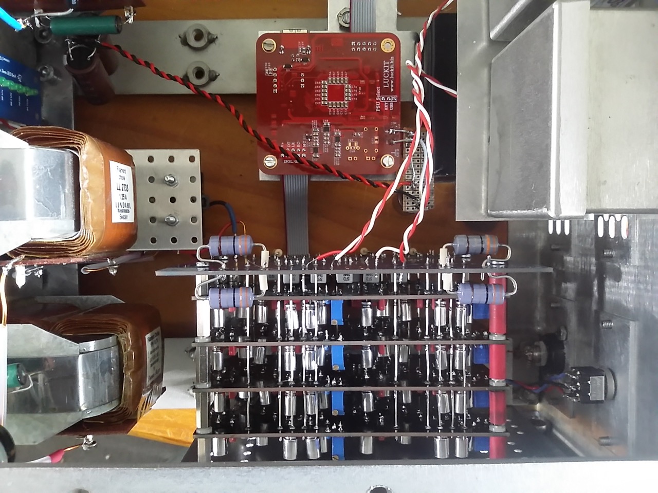

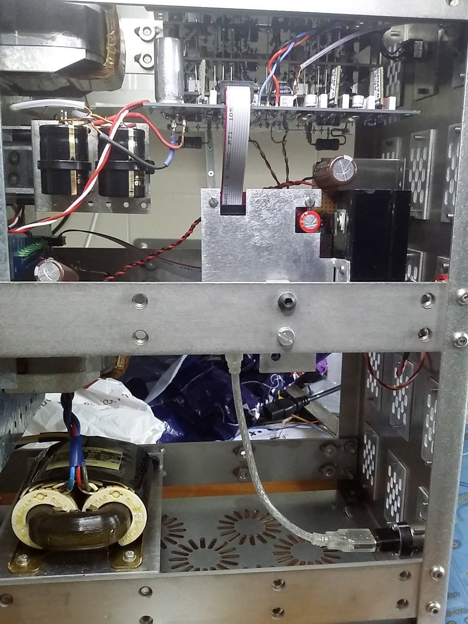

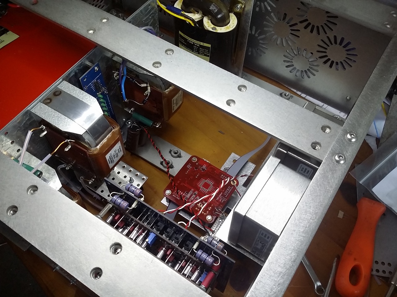

Hello,
Here some pics. Both wave Io and mainboard are choke input with LL2733 lundahl.
Wave IO has Belleson 5volt 2A directly at its input.
Both power supplies are with R core 500VA for dddac and 120 VA for wave IO.
They even have their own power supply cable and switch because i will start using USB with Aurender i think beginning next year.
I agree choke input sounds more in control, like you have your own energy plant.
Did solder the schottkys right on to the lundahl solder tags.
The first cap AND the 360 ohm bleeder on the other side of the choke.
Greetings, Eduard

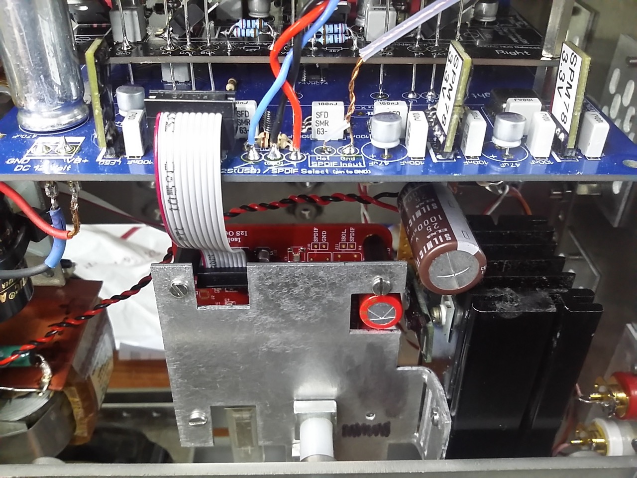

So I have built the choke PSU like this pic like others here to try this design first. My transformer delivers 15 v AC but the DC output across the load bleed resistor is approx 19 v DC but the design shows should be approx 12 v. I know it depends on the bleed resistor and more so the resistor is 33 ohms.
Any ideas why 19 and not 12 v out I suppose I should reduce the transformer output ?
Simon@
Do not reduce the transformer output. Remove the caps before the first choke, and you then have a true choke input. Sounds better, and your voltage will drop much closer to 12vdc, or even under.
What dac boards do you have ? The new ones draw twice the current and if you hook them up to your psu as it is now, you will see a large drop in voltage. With choke input , the voltage drop is only half of cap input psu, but you maintains the same current through.
If you have the old board(s), 19vdc is probably to much, it depends on the number of boards.
With choke input and old board(s) you will be very close to 12vdc, measured at dac input.
