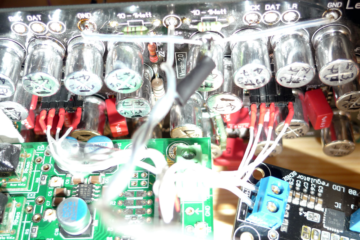

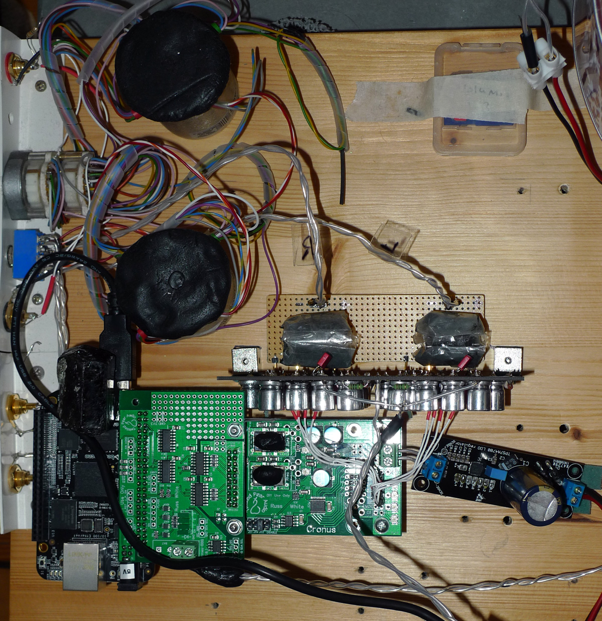

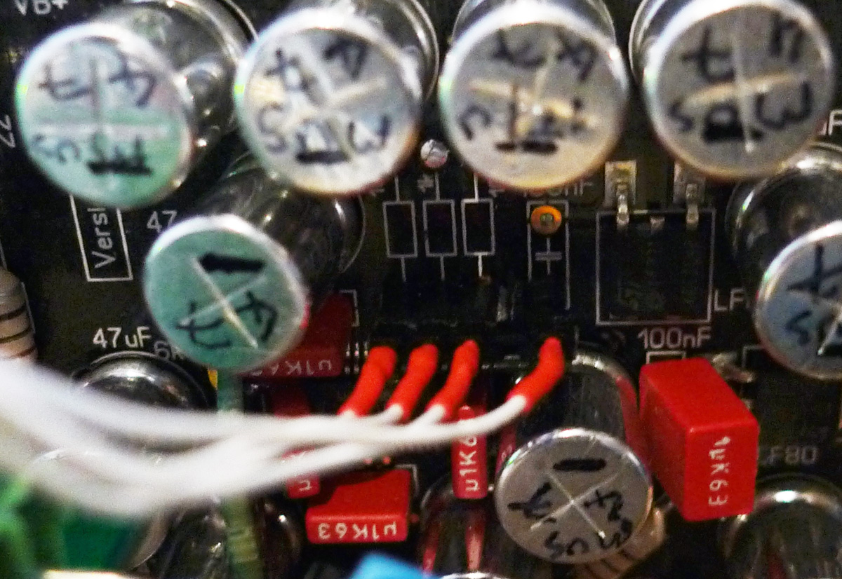

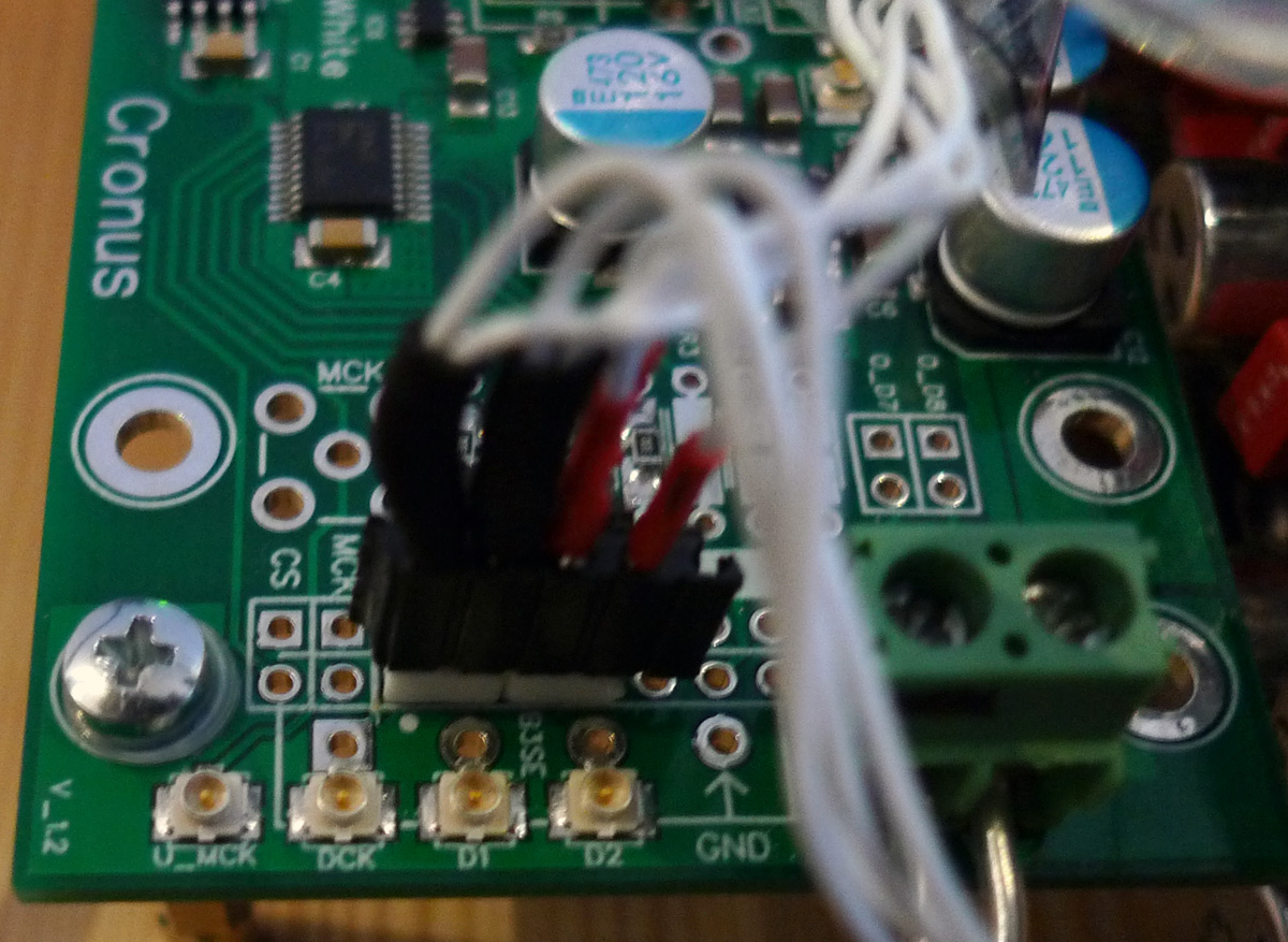

Very cool! Do you have any more pictures of your cronus to dddac wiring? I'm very tempted to try but so short of time latelysince a week i have been running my dddac connected to a bbb-hermes-cronus.
hi james,
it seems that the 33 ohm resistors on the cronus output are sufficient enough, so i just removed the 100 ohm resistors on the dac and wired the i2s directly close to the pcm1794.
for the ground(s) i took also the short way (by replacing the 100nf cap to the back side of the pcb ).
the connection of the wires on the cronus is according to the jürgen's post (#4705).
regards
since a week i have been running my dddac connected to a bbb-hermes-cronus. the sound to me is almost fantastic and almost nothing to complain.
Thanks for sharing.
I have a small question, I can not see the main board ( blue or red ) in your build. Are you connecting your dac boards directly to usb amd cronus (without the main board ) ?
Thanks for sharing.
please read the post #4705.
the dac is connected directly to the cronus without the red or blue main board. the task of the main board (data singal right justified 24bit I2S ) is done via software modification in the linux on the BBB.
