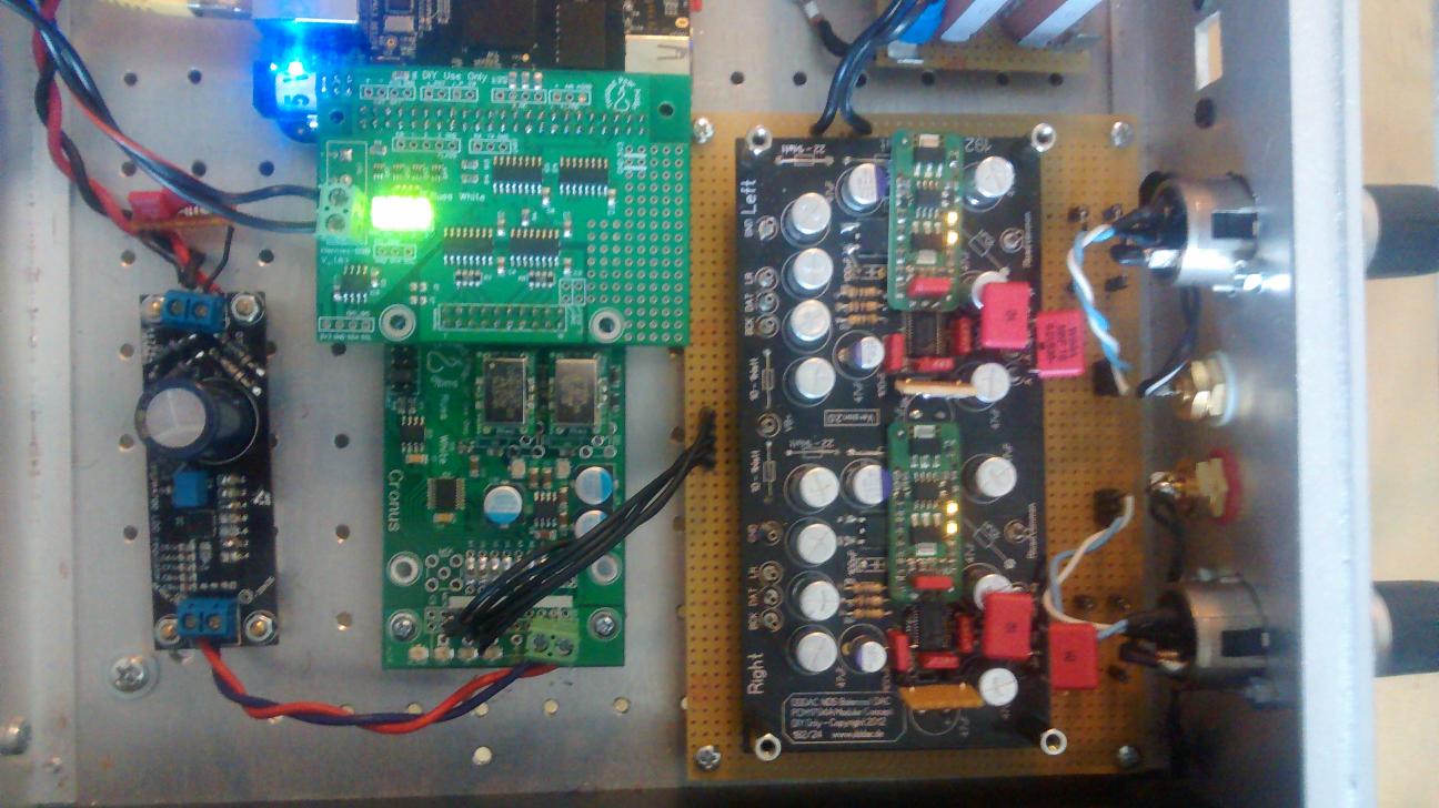

It's working! I am just listening to it!
I am sure it's also beneficial for a multi board DDDAC.
But I am not sure if the Chronus can drive as many board as you have. So far I only tried with one board. You have to test it.

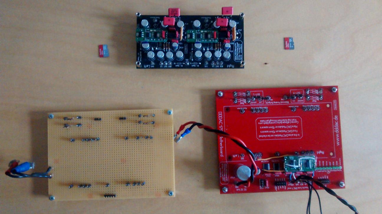

How to connect the DAC-Board directly to the BBB-Hermes-Chronus:
This is how the DAC-Board can be directly connected to the BBB-Hermes-Chronus. No DDDAC mainbord needed.
The conversion to the Right Justified format is done by the botic driver. The split into right and left channel with the rerouting function of ALSA.
Note: There is a bug in the botic driver. The conversion to Right Justified doesn't work if the 32bit format is used. But we can use 24bit without any quality loss.
Here I only explain how mpd can be used with this modification. Almost every other player will also work. It only has to use the format 24bit or lower and botic-split as output device.
Hardware:
I used a perfboard to connect the dac board to the Chronus (see picture). But I think it's also possible to just connect the boards directly with wires.
Connections:
(May be it would be even better to replace all this resistors with wires. There are resistors on the chronus already. Didn't test it.)

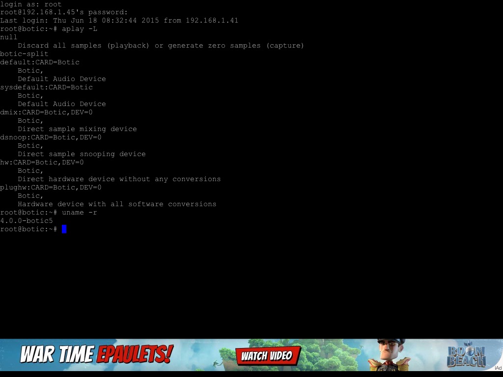

6. Checking for the new ALSA device:
Command: "aplay -L" should list the new device "botic-split"

Hardware:
Connections:
Chronus Ground -> to both Ground-Pins on the DAC-Board
Chronus DCK -> to both BCK-Pins on the DAC-board
Chronus D1 -> to both LR-Pins on the DAC-Board
Chronus D2 -> to the left Data-Pin on the DAC-Board
Chronus D3 -> to the right Data-Pin on the DAC-Board
+12V and GND for the supply
The I/V-Resistors have to be connected in the same way as on the DDDAC-Mainboard.
If R7 and R9 on the DAC-Board have different values than R5,R6,R7,R8 they should be replaced.The I/V-Resistors have to be connected in the same way as on the DDDAC-Mainboard.

Last I tried was On Botic 3.2 and failed. Still haven't upgraded to Botic4. Now with Botic 5, there is no more excuse!
Btw, many thanks to All with your kind compliments! There will be an acrylic cover and real jarrah finish on sides and rear of the inner panels.

It's easy to do A-B testing if you use pinheaders for the connections (see picture) and make two sd-cards with the different software that is needed.
You can switch between hard- and software solution in less than 2 minutes.
Jürgen

Yes, I think this should work to get a first impression. Later I would make the connection wires between the chronus and the DAC-Board as short as possible to get the best result.
You also can change the parameters for the botic driver on the fly.
This two commands will change to Right Justified for the direct connection:
echo 16386 > /sys/module/snd_soc_botic/parameters/dai_format
echo 32 > /sys/module/snd_soc_botic/parameters/blr_ratio
This will change back to i2c if you want to use the DDDAC mainbord:
echo 16385 > /sys/module/snd_soc_botic/parameters/dai_format
echo 64 > /sys/module/snd_soc_botic/parameters/blr_ratio
It's not necessary to reboot the BBB in between!
You also have to change between the mpd outputs for botic and botic-split of course.
Don't turn up the volume to much while testing!
If you play accidentally a song with the wrong parameters it can give a horrible noise!
Regards
Jürgen
