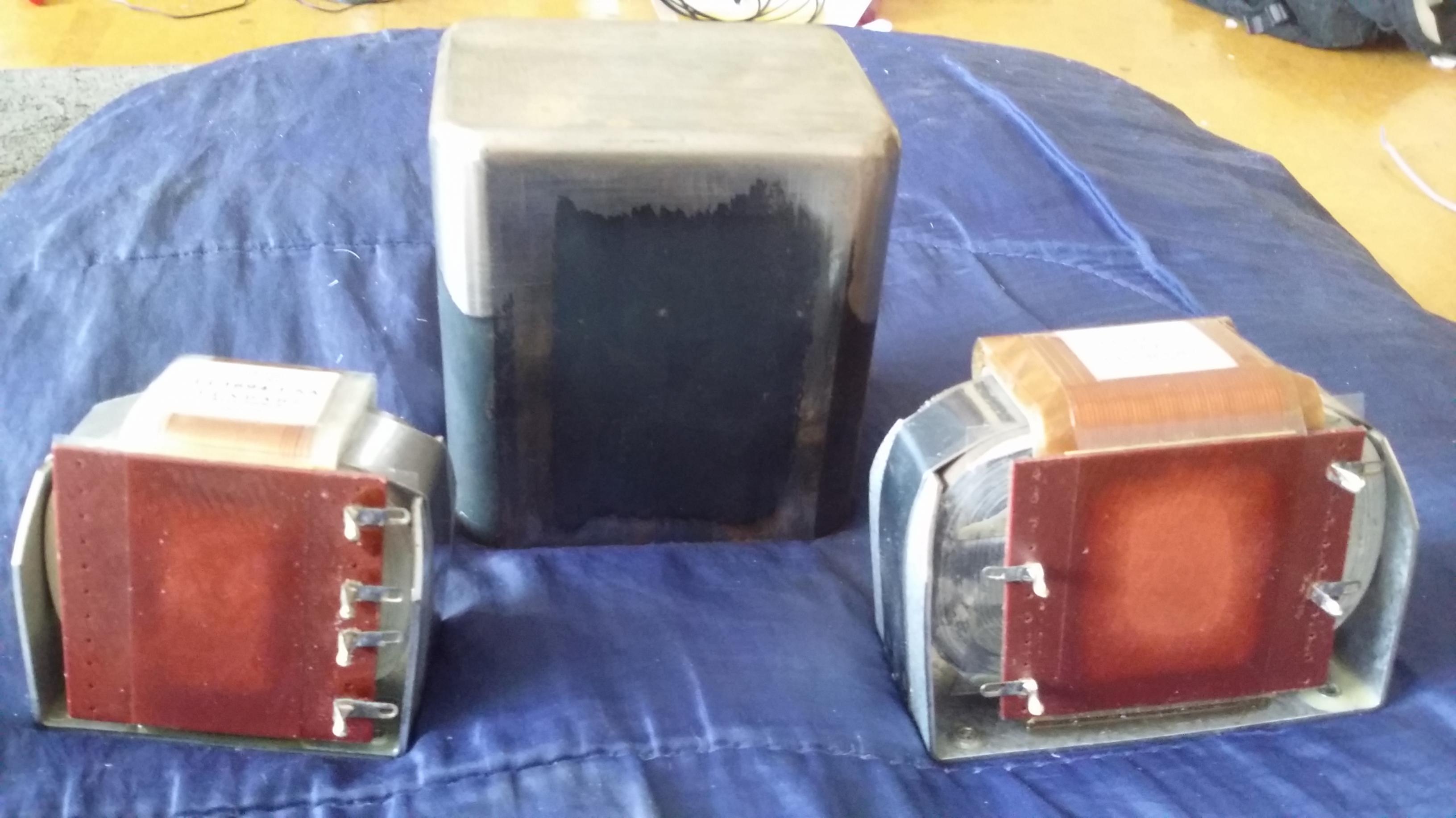

Hello,
Monday i did receive my set of chokes. One that is been used by some people here and the other one that is a bit bigger.
And gues what i did find some nice 4mm thick iron cans that have been welded for me two decades ago that can be used for potting them. The smallest choke can be fitted in every direction. The biggest one will only fit one way after a minor adjustment inside the can.
The cans have to be sended because they have been in the shed for a long long time.
I will wait for the new boards to appear i think. It is okay to mutulate one board but having 4 boards like this. I think i rather wait a bit longer.
Maybe can start a pre ordering so the first run will be sold 50 %before they are even made.
Sincere greetings, edward
P.s the cans are heavier than the choke it will hide
