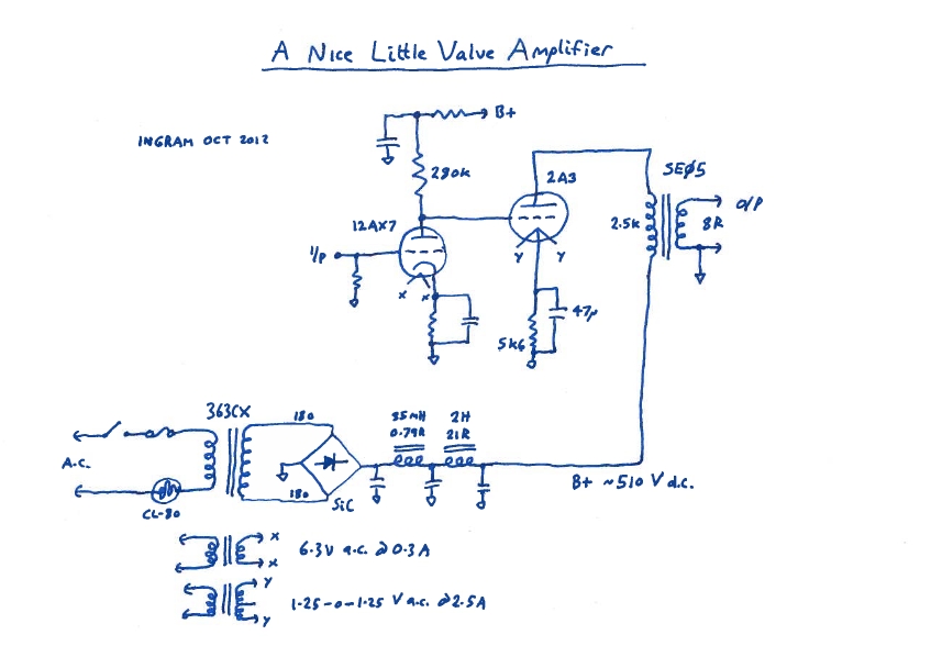

A nice little valve amplifier
same circuit, implemented in Spice. Similar results.

For what it's worth, I built a 2A3 amp that is very similar. The biggest difference is that I used a 12SL7 for the driver (sounds amazing), and I did a bit of a shunt to the PS, just a big bleeder 15ma or so, can't remember exactly. I have tried dozens of different amps and this is the one I'm still listening to a year later. I used the Angela Instruments power transformer and a 5U4 rectifier.
Hi Disco - good point, the devil is in the details as always - I shall investigate.
I was also worrying about the topology. The concept of a wimpy driver was looked at before but not in a L-W set-up. The L-W topology I have proposed does not have a bypass capacitor on the cathode resistor of the driver tube which raises it's output impedance.

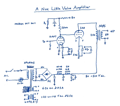

I'll need to review this. In the meantime, attached is an alternative plan which incorporates a fully bypassed cathode resistor.

So, you're abandoning both Loftin and White here ;)
Mind that any PS ripple > 15mV will be heard on sensitive (>95dB) speakers.
Besides, all music will be modulated by 120Hz because of that ripple AND
by 60Hz if you light 'm up with AC AND with crossproducts of that.
Take your time, it's no race (look who's talking :D) ).

I agree that a regulator can be a very good choice. If I were to use a regulator, my personal preference would be to use a shunt regulator. I feel that a shunt regulator puts it's impact on the sonics at a minimum. And if I were to shunt the B+ I would want to use another 2A3. I've seen this approach more than once, the last time I think I read it in Sound Practices. I like it. But I'm not going to use it here because it adds a lot of power dissipation (whether tube or SS it's still a Class A regulator), expense and some complexity. I don't believe we need a regulator if we design the power supply and the amplifier right.
However, we will consider some regulation for the power feed to the input tube ;)

With a mu of 100 the 12AX7 is probably going to provide far more gain than you require, consider the 6J5 if a sensitivity of a couple of Vrms is adequate or the 5842 if you need something on the order of 700 - 800mVrms. I used the 5842 (mu of 42) with great success to drive 71/171, and 45s - nice lively and dynamic sound with very low distortion, works well with LED bias run at about 10mA.. (Choke loading works very well with this tube since rp is low and huge chokes are not required, 100H is enough)
I'd recommend CCS heating for the 2A3, and I've used both IC based CCS and Rod Coleman's boards which I can recommend.. The 2A3 can be AC heated and the audible hum is not too bad, however with AC heating there are significant IM sidebands at 120Hz either side of the fundamental tone being reproduced. Tubelab has discussed and presented results from measurement indicating this is a significant issue. This would generate significant levels of IM on music.
Quick calculation.
I read on the internet that the miller capacitance of a 2A3 is around 70pF. And since I read it on the internet, it's probably wrong and there are probably opinions on several other choices for this number. But let's go with it for now.
The 12AX7, bypassed cathode resistor, has a plate impedance of around 62k (depending on operating point) and the output impedance is this, in parallel with the plate load, of, say 280k. The answer is around 51k. The signal at the grid will be cut in half when the miller capacitance presents 51k of impedance - which I calculate is well above the 20 kHz audio range.
With an un-bypassed cathode resistor the output impedance shoots up due to the high mu of the tube, to something I calculate as over 150k. Now the high frequencies roll off around just above 14 kHz. And whilst I don't hear too much up there, it's not where I want to take this design. And as for alternative drivers with lower plate resistance, these tend also to have lower mu.
So either the L-W has to get voted off the table, or the high mu driver has to get voted off. I'm going to vote the L-W off the table. I want the sensitivity of the high mu tube. It's not strictly required when you examine the design on-paper, but it has been found to produce nice results by many others who have built amplifiers like this using 12AX7, 6S5F, 7B4 etc.

Hang on a minute - why can't I bypass the input tube cathode resistor AND apply a L-W topology. Broskie showed the way already, just have to use the capacitors as the divider. The hassle is choosing the right value of the capacitor connecting the cathodes together in order to get good B+ noise cancellation, or else maybe it can still be fine-tuned with a resistor.

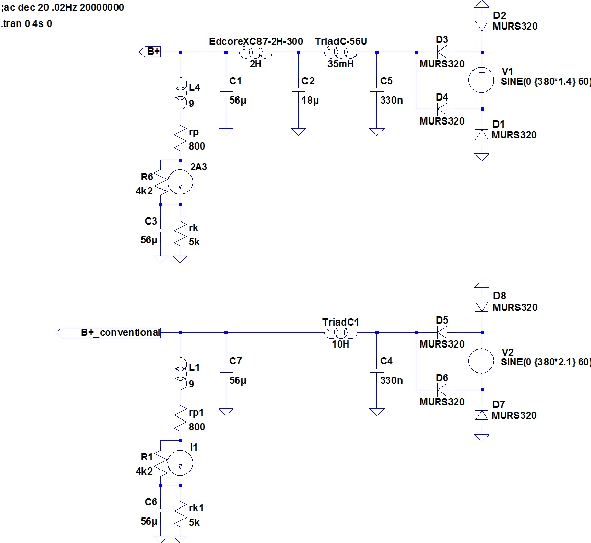

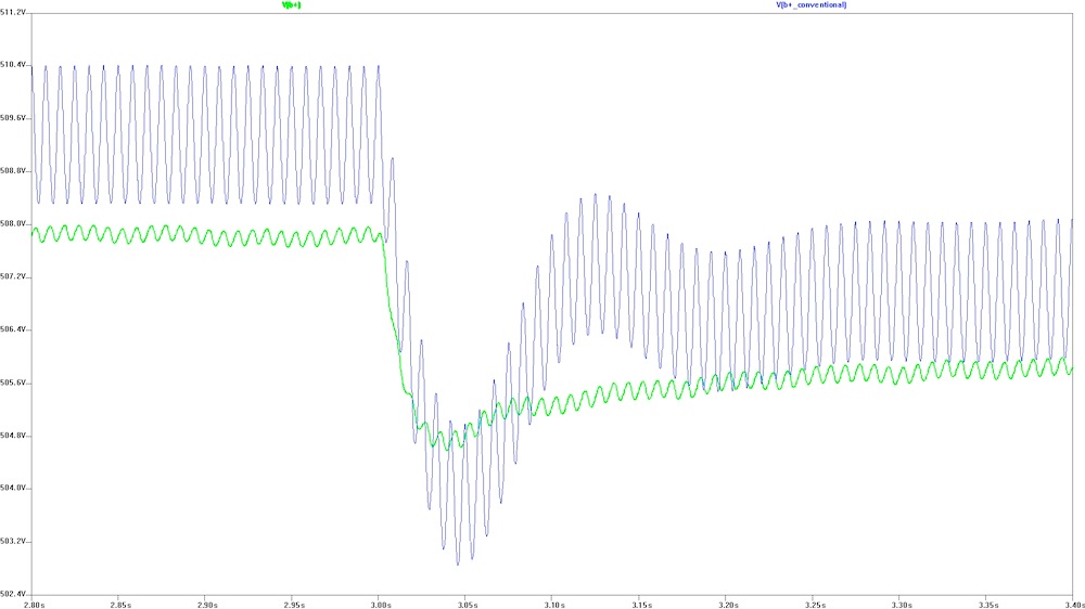

A couple of updates.
I've swapped out the Hammond for an Edcor power transformer (just added it to my order for the 2H choke today).
Added some audiophile bypass caps to a couple of spots.
Added Asano / Shishido - style shunt resistor Rs, which draws current off the supply rail to the driver tube. Along with the resistor to B+ this sets up a voltage divider that stabilizes the supply to the driver tube.
Also added are a couple of snubbers in the power supply, one across the secondary of the power transformer, the other across the output of the bridge rectifier.
Have you spun out that power supply yet?
Inductance is quite low so you'll have to use large capacitance to end below 15mV.
Maybe a third filter step, a RC right after the rectifier?
