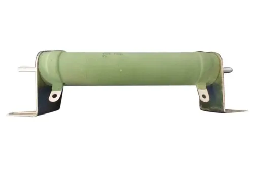

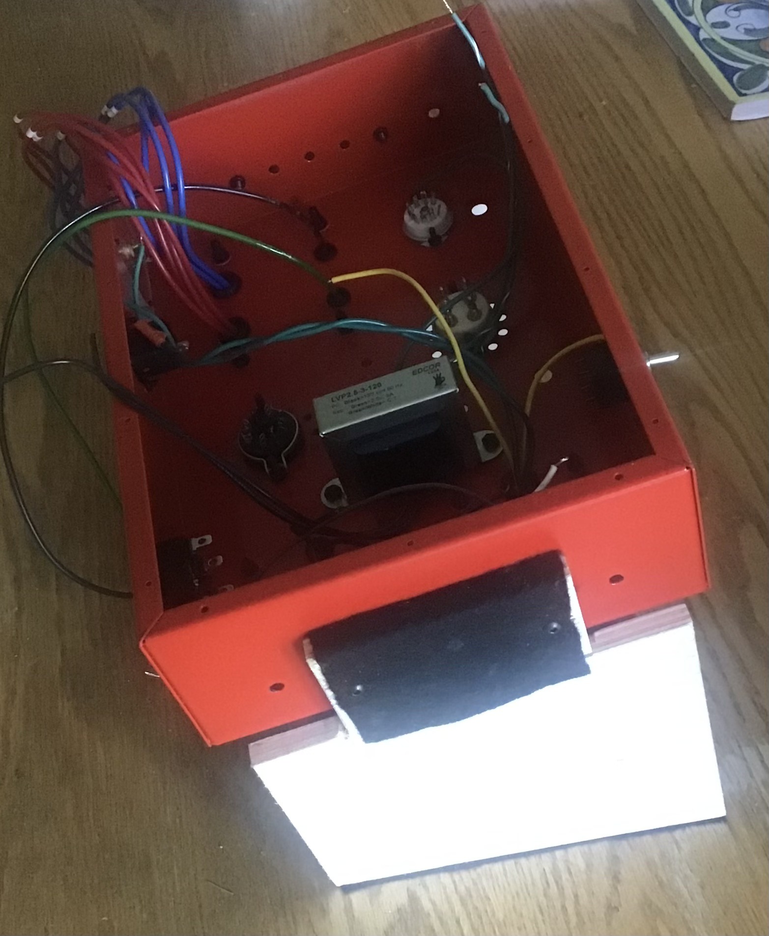

IMO embrace putting cathode resistors on top or building into the design, somehow. Recently reworked a PSU and added two new resistors that get pretty hot. They are under the chassis and ventilated with holes but the chassis still gets plenty warm in that area.

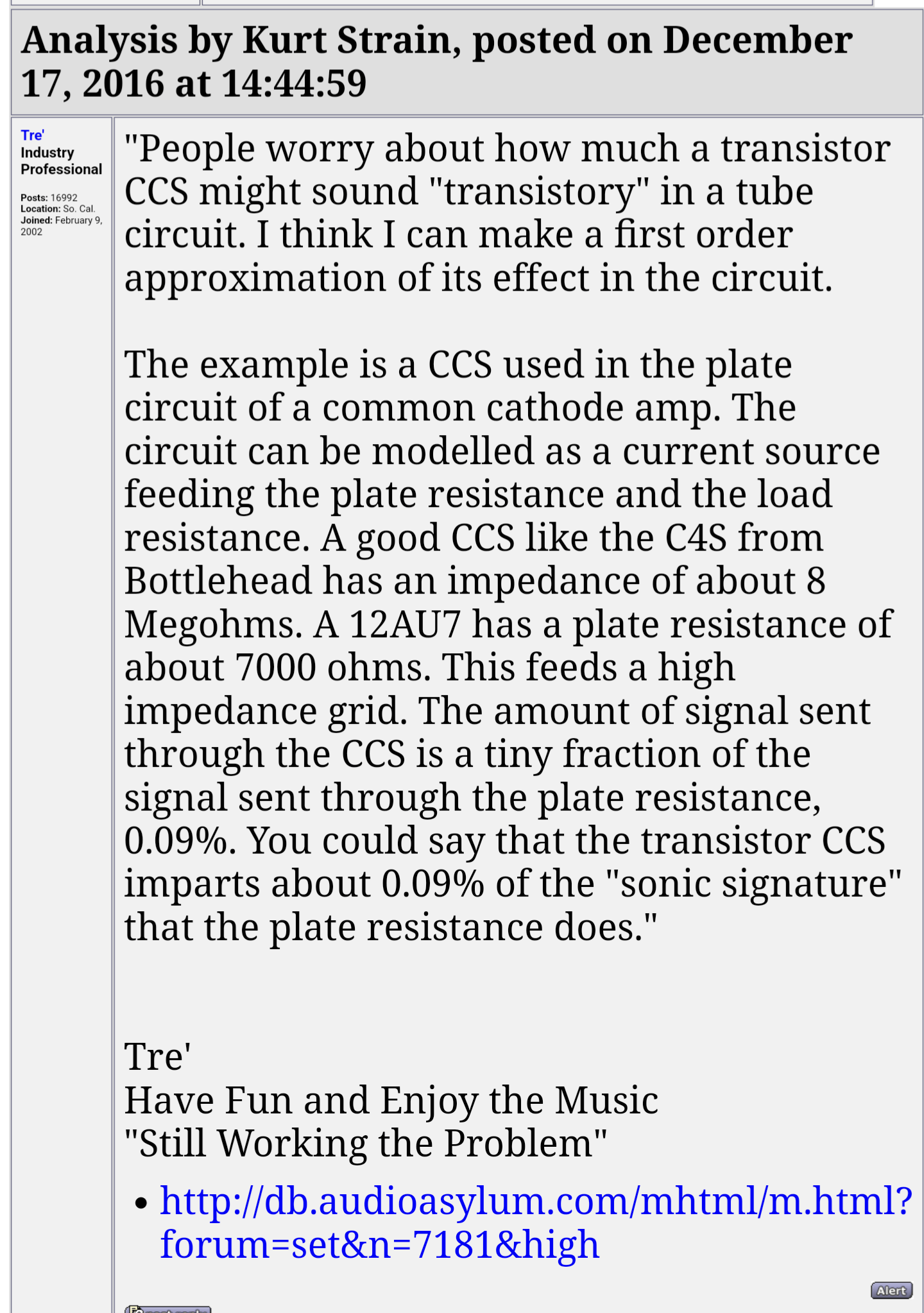

Also found an interesting post in this thread. It sounds like a tube CCS offers substantially lower output impedance. I wonder about two aspects of a 2A3 stacked on a 6V6:

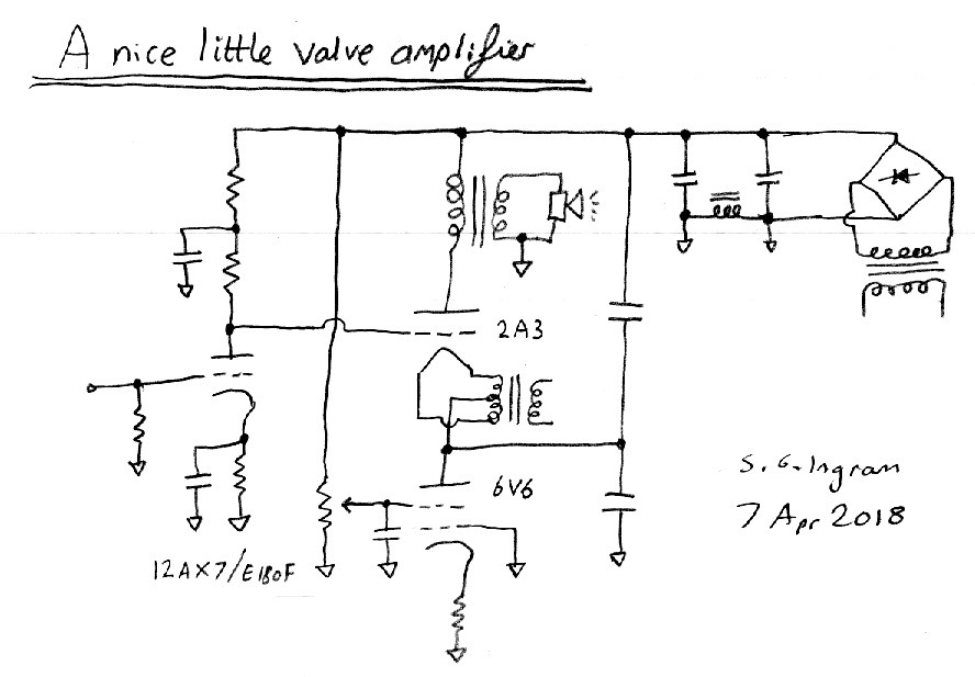

Interesting you should mention it, but I still have a keen interest in the 2018 the design for this project included just that, a 6V6 underneath the 2A3 specifically to keep the heat above the chassis.
However, it adds more heater power and current demand to the power trafo via the heater winding. It remains of intellectual interest but I’m not concerned about a cathode resistor in this project. Now, my chassis does have an Octal socket for the rectifier. If I went with a SS only rectifier, I could use that socket for a 6V6. Hmmmmmmmm?
