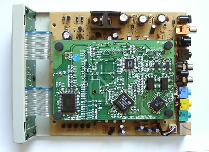

I just had an idea. Many Threads have been submitted on the forum about building a Dolby Digital decoder. All of them have ended in failure for the reasons : you need some type of document from Dolby just to buy these chips, you need a microcontroller to run the chip, and the schematic for it is huge. While I was on the net I fount this little device. It’s called the External DD5.1/DTS Decoder, Jazz Speakers DE-005. It’s made for a computer MM system. It uses the Dolby Pro Logic/Dolby Digital/MPEG2 stereo/DTS decoder CS4926 04 CL from Crystal Semiconductor. I don’t have a price for this thing, but it can’t be very costly, my guess would be about $150. So what’s to stop us from tapping the Pins of the CS4926 and stealing the PCM output of the decoder and sending in to the front and of the DAC where working on ??

It looks like i guessed the price just right. Exactly $150 and that was just a guess at the time. I’m still looking for a better solution. If money where no object I would go with the MDP-3X MULTIPLE DIGITAL PROCESSOR from http://www.msbtech.com/ . It comes with a decoder and 3 PCM outputs right on the back so I don’t have to do any work. Why couldn’t more makers of DVD players think of that? However its way over priced.

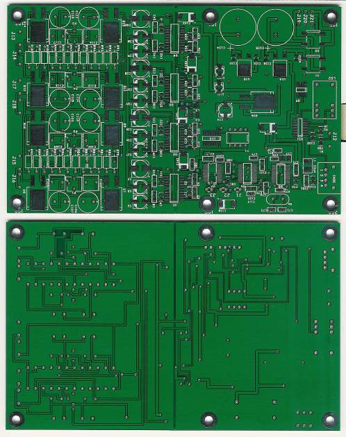

This is the PCB.

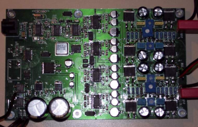

The project was more a "proof of concept" and a test if I can get it running, not to be the ultimate DIY DAC. But i tried to use most information and tips I found, except about special oscillator circuits. Just one thing at a time
Short description: optical receiver TORX176, receiver TI DIR1703 switchable between coax and optical input, next step is the Analog Devices AD1896A Sample rate converter to upsample to 96kHz. It feeds the TI DF1706 digital filter to drive four PCM1704 DACs for balanced output. I/U Conversion is PASS D1.
Voltage regulation for digital part (3.3V, +- 5V) is on board, +-30V for output stage has to be supplied. I use one of my ONO power supply boards, which gives a nice regulated +-30V.
There are two errors in the layout. one trace between the two rectifier bridges has to be cut, and I forgot to place the output caps of the D1 stage. But otherwise it seems to work nice, and it sounds fine.
I will not make another large group buy from this, like the ONO, VERY limited time this year on, but I have left seven of this boards. I ordered ten pieces. If there is any interest, please email. But because of time, I can not give much support beside schematics. You should know what You are doing, and be able to read and understand the data sheets of the used parts.
-Peter

Of course the DACs are PCM1704 !

Exactly two! Looks harder than it is.

moe29 said:i bet that took more than an afternoon
to solder up!
verrry nice
moe29
