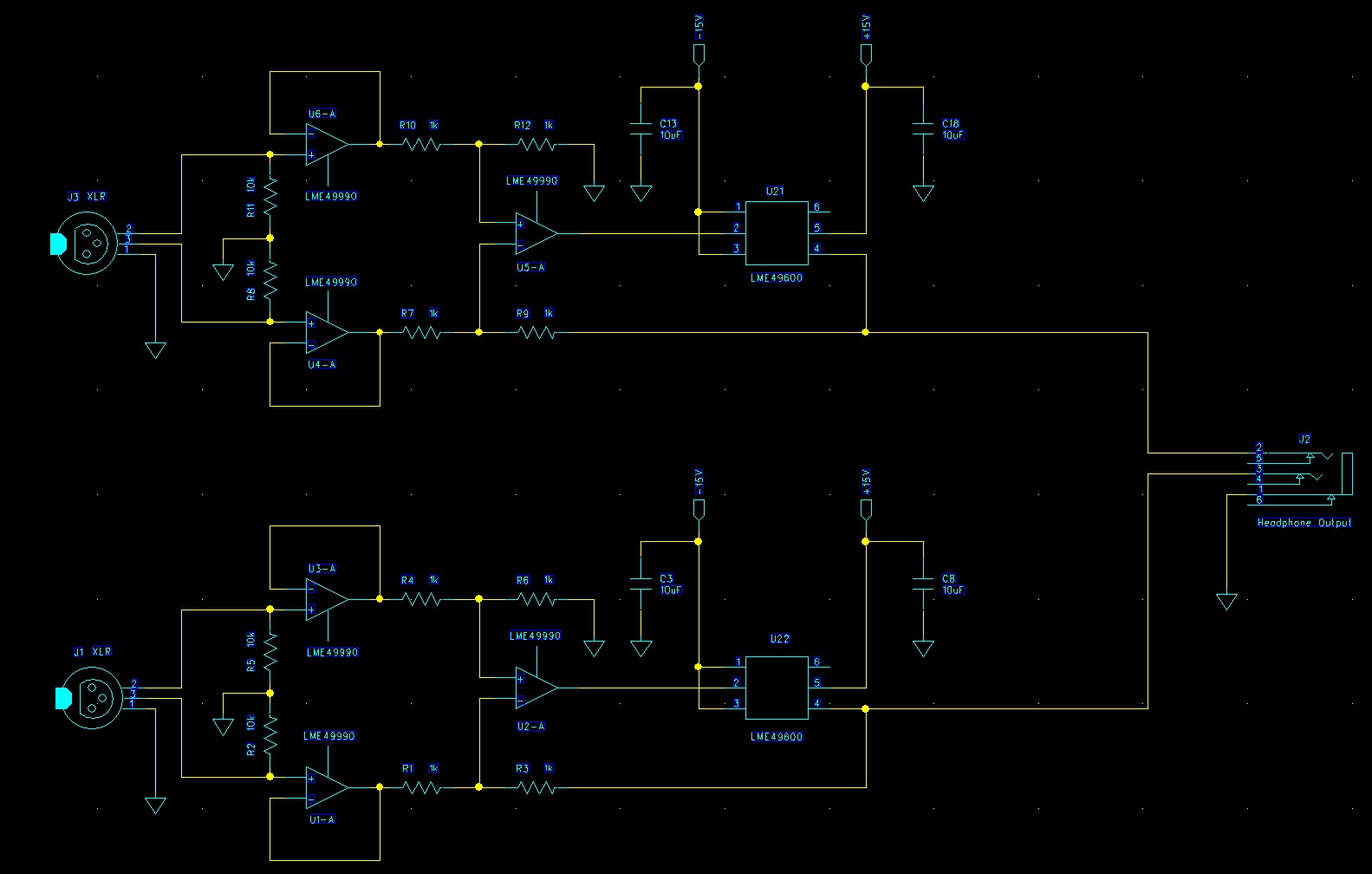

Is it actually possible to run SE from the balanced outputs?
Either by connecting the negative to ground or leaving it disconnected and just using the Gnd and positive.
I've asked this in several places and never really got an answer. I wanted to try it with the IVY but was unsure of the risks.

yes of course you can, the concern is not really valid Spev, absolutely any IV stage after a balanced dac such as the sabre or really any modern dac will require a SE summing stage after the DIFF IV if you want to fold down all of the DNR. you can always just take the SE output by taking half the bal output, but performance suffers considerably. that has nothing to do with this design, it has to do with all the dacs being designed for balanced output for best results.
you will not find a single IV stage that does not have to do this. you can always do the above, but its not recommended. the IVY is the same, there is a separate SE stage, just happens to be on the same PCB.

As you have already discovered, it will indeed work, but performance will suffer somewhat. Distortion is still quite low however, so whether or not you'll actually hear it is debatable. Just the same, I would suggest using the circuit in differential mode unless you really have no other option.
A better solution for SE operation would be a few op-amps arranged as an instrumentation amplifier to do balance to SE conversion. If you went this route, you could actually drop the resistance values way down to reduce gain, and run lower rails and higher current, then get your voltage gain from the instrumentation amp. I personally love the LME49990 op-amps, and my headphone setup uses those as a balanced to SE converter driving an LME49600 buffer. Together with the DAC and I/V, the input to output THD+N is a pretty incredible -111db.
If you'd like, I could post a schematic.

As qusp mentioned, most DACs take advantage of the CMRR of a well designed balanced to SE stage at some point in the audio chain to lower the noise and distortion that occurs in the D/A conversion.
There are very few systems that are truly balanced right to the loudspeaker outputs (this requires true independent bridge operation), so for most people, the balanced to SE conversion takes place in the first stage of the amplifier. If you don't have that option (eg a tube amp with an SE input) then you're far better off building a proper balanced to SE conversion stage so you can reap the benefits of CMRR. Take a look at any DAC datasheet and you'll see a suggested circuit that consists of a balanced op-amp based I/V stage feeding a third single op-amp that handles diff to SE conversion.
Other DAC output stages are no different, they either provide balanced output, assuming you'll have the CMRR somewhere else, or they do it on board using a balance to SE circuit. I've just omitted that circuit which allows the end user to properly control how it is done.
I personally will be feeding a pair of F5 amplifiers in bridge mode, which basically moves the CMRR duties all the way back to the loudspeaker itself if everything is well matched.

no problem Rich, there really isnt such a thing as a single ended dac anymore, so the IV stage should always be balanced, then for those who will tolerate them, opamps are a great solution. could be done with a few transistors too, but for my taste opamps do a better job, even though it might seem a bit incongruous to this design.
balanced all the way to the headphones for me, which are recabled balanced, also balanced to XLR input of my active studio monitors. with everything having at least dual mono power supply

I wanted to re-cable my Denon AH-2000 headphones, but I can't bring myself to chop off that beautiful cable. I went for SE output for the sake of compatibility, since I use my headphones in multiple applications. Congrats if you went differential all the way though... should be the best IMHO. The circuit below is my headphone amp, which could easily be adapted to work for balanced output by using a single LME49990 and a single LME49600 per phase per channel.
Owen
