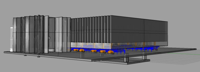

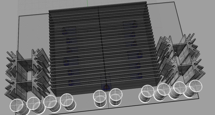

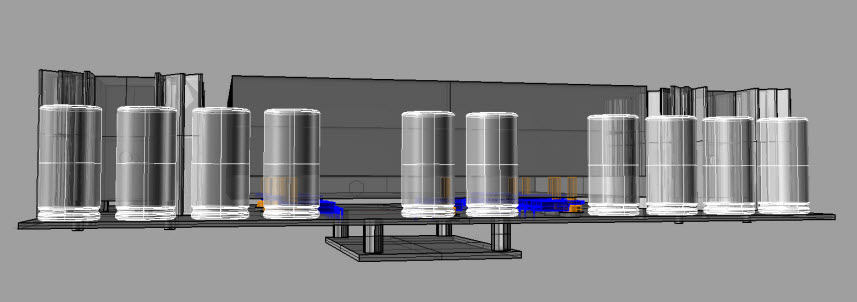

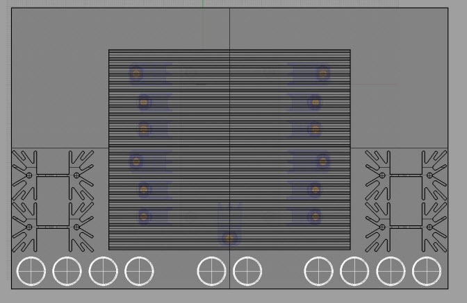

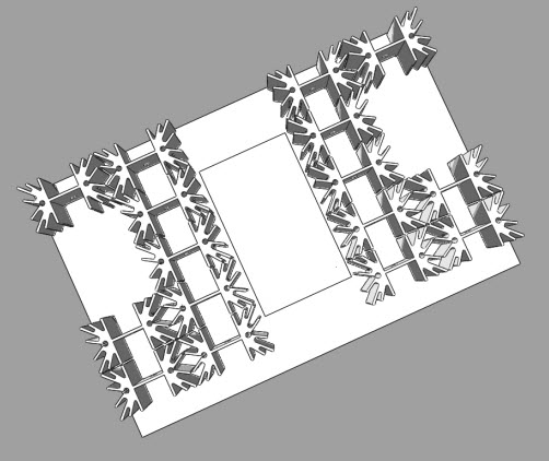

Hi Guys,
Some more input on pcb layout.
I do not want to look as unapreciative of opc's fantastic work, this is just an atempt to do teamwork.
Here is a quick 3D rendering of the major components on opc's initial layout.
3D gives a better "feel" for final product, i think.

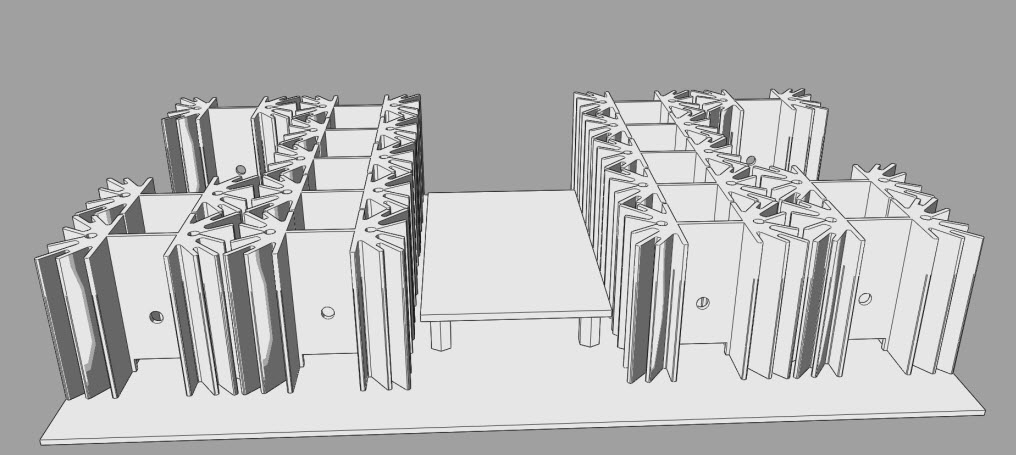

Joined 2006
Ilustrating my ealier post on an alternative layout:
This one permits components on both sides of the pcb and leaves more space for coupling caps.
It does mean that DAC is facing down ...but objective is not to look at DAC i think...it's the music :)
note: big heatsink is generic, this is just to portray the idea.

I suggest that the original layout was a good choice for what many of us would like to use in an enclosure. The thermal design is fairly critical here and should be improved on only by making the board wider by enough to add space between heatsinks for cool air inflow. Adding holes in the board beneath the end of the heatsinks would also be a very good idea. Alternatively, the existing layout with an area routed beneath the ends of the heatsinks - opening the area beneath the fins completely - would work well. This desigh will require a vented enclosure if the final layout does not attach the devices to an external heatsink because of the Pdis.
Thanks for the hard work and best regards,
Dave

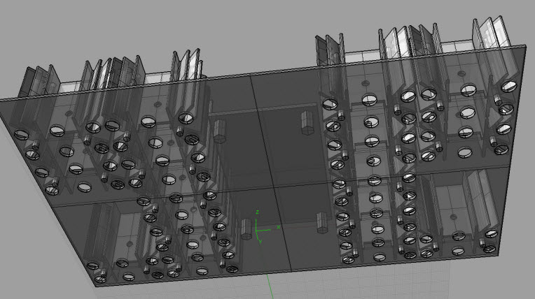

would something like this work fitzfish:

yeah you got it right mate thanks, its from a fantastic Greg Egan book, people get it wrong all the time because even though we are conditioned to all sorts of misspelt and crazy nicks, people just cant seem to bring themselves to put a u after a q without a vowel after it; even though its staring them in the face ;) quasp and quisp are popular alternatives:confused:
hey look, I have no issue with you trying to help, in fact its appreciated. but at this late stage I think you gotta draw the line as to what exactly is helpful. this thread has been around for well over a year with no result (as far as a PCB anyway, as the design works quite well) for a number of reasons. the design is in place, the parts are in place, the specs are excellent!!, the sound is excellent!!, finalizing the PCB layout for heatsinking is really the only thing left to do. Changing the design and entering into power supply discussions is not going to help that. suggestions at this stage to rework it to such a degree including literally turning the thing upside-down; arent really what I would call productive towards that end.
we could also add a sophisticated MUX with spdif to i2s convertor, discrete shunt regulated power supply and an MCU for volume control/input switching, but that wouldnt be productive at this stage either. these are the sort of things people can add themselves if they wanna take it that far
wasnt being disrespectful; facetious yes, disrespectful? not so much. sorry if I offended you
I have to kind of take a bit of a back seat here, because even though initially this was going to be designed with the ackodac in mind as the platform, OPC ended up buying himself a buff II; most likely due to impatience waiting for the ackodac to be finished (totally understandable as it was a long time coming, but it was a bit frustrating for me), so the direction changed for best fit with the buff both physically and WRT power supply. I run a buff II portable, but my home dac is an ackodac, so i'll have to live with a less than perfect fit and I dont mind that, but totally unusable without massively long signal connections doesnt thrill me, I may as well stick with what I have.
I have a feeling that the above would be impossible to route the traces around, but otherwise sure and if some of those holes could be in the right place for screwing the components down on the floor for those who wish to do that, that would work.
Joined 2006
Hi qusp,
you just confirmed my liking for australians, love the plave, love the people.....:)
the main reason i posted the above rendering was exactly to ilustrate where we should or should not put holes.....as it is shown it's a ver holy board....pun intended.
but not very easy to route around as you say.
Realistically i think we should place holes only beneath the heatsink wings, this would ease the routing issue to the transistors and resistors while permiting better air flow to the heatsinks.
