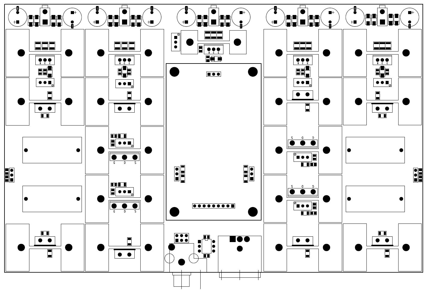

I've attached the rough layout for the entire PCB, so people can comment and make any suggestions. There's also a pdf which is to scale, so you can print it out and get a better idea of size. No routing done yet, but I'll probably get around to it tomorrow.
I priced out a few different options with a few different manufacturers, and it's looking like Advanced Circuits is the best so far. If I fill out an online quote for 30 pcs of 50 sq. inch 2-layer board, they come out to about $22 each.
Both of the other suggestion came out to be quite a bit more, but I think it's just because the board size is rather large. Gold Phoenix PCB works out to $33 per board ($99 for 150sq. inches).
I also looked into 4 layer pricing, but it almost doubles the price of each board. I'll do my best to route it on two layers, but it's not going to be easy with the top mounted heatsinks making it impossible to have anything but a ground plane on the top layer.

I was thinking the same thing, was just about to print it out to see. without that ability and with them all so close around the board like that, it also makes it impossible to do anything with the ackodac unless its elevated up over the heatsinks, which is not at all ideal for both noise and all the heat rising up past the dac. such small sinks will be a bit toasty too would they not? the sigma22 I posted uses oversized heatsinks with the flanges (or whatever they are called) flared much more, so the hole exists within the profile of the sink, but with these smaller sinks and larger devices, I doubt it'll work
Please excuse me Owen, if i'm out of order here ....
I'm a bit puzzled with the layout and perhaps there is a good reason for using all those seperate heatsinks and long tracks, and combined signal earth and power supply 0volt tracks ....
Would it not be better to thermally connect the active devices together on one heatsink and reduce the track lengths to the minimum possible?
And perhaps collect all the regulators onto another common heatsink at one end of the pcb (or maybe a seperate board)....
Perhaps this would also reduce the size of the final design?

Glad to hear people are in for the 4-layer if it's needed. I'll see what I can do with 2 layers, but I too would gladly pay another $20 for a better overall layout. We'll see where it takes us.
qusp and neb001:
You guys both have valid points about the tight heatsink spacing, but even with minimal airflow it should be alright. At +/-45 volts there is 2.7 watts dissipation on the top resistor, 2.4 watts on the mosfet, and 5.5 watts on the lower resistor. The resistors can run hot without any problems, it's the fet that needs to stay cool. With only 2.4 watts on that sink, at worst case 4 or 5 degrees C/W, it's not going to run that hot. I could certainly add venting to the PCB below the fins on the heatsinks, which might help a bit to keep things cool.
qusp: Could you tell me what the board size is for the ackodac? Like I said, I can certainly try to accommodate it, but I don't have one here to measure. Does it have a million little daughter boards hanging off all sides? Maybe a picture along with some rough dimensions would be best.
jameshillj:
You're certainly not out of order at all, any comments are welcome. I did say above that the top layer was a ground plane, but I should have said "ground layer". I won't be combining all the grounds together as that would cause a ground loop / hum disaster.
I've been pushing for the smaller on-board heatsinks since it takes some of the guesswork out of the process, and allows a stand-alone PCB to work the way it is, without having to bolt a dozen different parts off-board to various heatsinks. On the the other hand though, it does waste PCB space like you said, and the airflow will be quite poor compared to side mounted heatsinks. Tracks are also a little longer, but you'll find that even with the parts side mounted, the tracks are pretty long.
What I can do is try a rough layout without the on-board sinks, the regs along the top of the board, and the fets/resistors along the side. I'll see how much space it can save, and how the routing looks. If it's significantly better, then we can go with that.

opc,
The heatsink spacing can maybe be addressed in a diferent way:
Why not place only 1 heatsink per side and turn the board upside down with the transistors and regulators screwing through holes on the PCB ?
The Heatsink would be on top so thermal coupling and dissipation would be optimum.
Also board size would maybe be a bit smaller and tracks shorter.
I'll make a simulation later today...i'm at my regular work now ( lunch-time ) so cannot spend more time on this.
Yeah Owen, multiple plug in boards are a real pain in the A!
If the final cct is the one on post #193, then if you group all 4 fets in the centre with a common sink, you can simply (?!) fit the + and - regulators on the "top" and "bottom" sides of the board with another 2 common sinks and the major part of the top (gnd) plane can act as the power supply central 0v, with the signal 0v kept seperate inside that.
On the power supply, I would think about using a much smaller o/p electro (if any) and have the 1 x 10uF as the supply "o/p" cap to the cct - unfortunately, most of the good 10uF caps are physically large, but you can always stand them up vertically.
