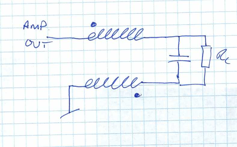

I'm not sure I got your configuration on the single ended version right.
Is this what you mean?
the current of the modulated signal are in phase (audio), so their is no (theorical) way to saturate the core
I'm not sure how do you mean this. If audio current is in phase, (having taken account choke winding directions), then magnetic fields are summing (this is the reason of increased inductance), so it can be driven to saturation easier. Carrier signal never have enough current to saturation, you don't have to deal with it. The important thing (in saturation) is audio current.
You must think of a different phenomenon! In case you connect audio out of phase to two weakly coupled windings (one half of core for one half bridge, ...), then saturation really needs a much higher A*turns product. But then you must have much more turns to achieve enough inductance, because differential inductance is only due to leakage. This way you can get a high common mode inductance, wich results a very low current at switching freq. But an unpleasant side-effect: some harmonics (2*fs=fseffective!) of switching freq is out of phase, hence their induced magnetic field steps out from core (just like audio signal). In this arrangement core can be much smaller, because most of magnetic energy stored in air, instead of iron core. I hope I explained it clearly.
I agree with ChocoHolic with a little addition: In the two cases we can have unchanged core material (as he assumpted inplicitly), or unchanged number of turns. With unchanged number of turns Al at common chokes is half of the one at separate chokes, so it can bear the arising twice A*turns with the same dimensions. Summary: reduction in size of core can be achieved by less permeability (or higher Bmax, but if it is already the highest, then nothing to do with it).

Hmmmm, I think I'm getting (even) more confused now:xeye:
Think I'l still go for the two windings wound together on a single core (T130-2), using banking method, to reduce capacitance.

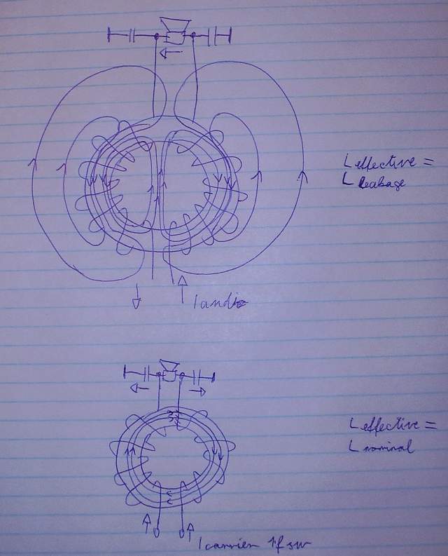

Pafi is correct. If the windings on a single toroid are such that the magnetic currents oppose each other there will be a net magnetic current of 0 through the core. If the windings are such that magnetic currents are in the same direction then they will add and can make the core saturate earlier.
Since the two windings will share the same flux, they will also be forced to have very similar currents flowing through their windings at the same time. This is beneficial for a bridged output topology because you want the same current flowing out of the one half bridge to flow back into the other half bridge.

Even if I agree that the HF component of the flux density is usually low. Say about 10% of the max. load current... Why should they cancel out in the choke? In most designs the HF of both half bridges is invers, in the same way as the Audio signal. (...probably just very few special designs run them in the HF in common mode and modulate the Audio signal by phase shift...).
Pafi:
In your proposal of opposite polarities... yes, I think it would behave like you describe. But why should someone do this? As you describe the resulting effective inductance will be the leakage inductance only, means it will be quite low and you would need quite a lot of turns to get the desired inductance value. Just from feeling, then I would prefer a torroid air coil with both windings wound to sum up...
Some radiated field is of course also happening in the air torroid. But in your proposal the entire field would close its loop outside of the winding.
I have another concern: Some months back I have been thinking about the exactly this topic: Coupled output inductors or separated coils? I did not dare to go for the coupled design because for me it is not clear how it would influence the two half bridges. Basically both half bridges run inversly. But due to some individualism there will always be some nano seconds difference for the switching. The voltage change, which we switch to one winding will of course be reflected on the other winding and will be seen from the other half bridge.
Also the fields in the choke would not fully add up any more, because some portion of the current would be bypassed to ground by the one cap of the output filters.
Please note: My outputfilter would have two capacitors in series, -with their center point at ground. For the filter function it would be of course sufficient to have just one cap in parallel to the speaker. But then the common mode HF signal of both speaker wires vs GND would be quite high. And the long speaker wires will radiate all that dirt in unpleasant perfection....
I think the effect the coupled inductors would not blow the amp (also not with my GND tapped filter), but I am not sure if it would fortunate or unfortunate or just meaningless for the switching behaviour of the half bridges.... So I decided to go the silly, but easy to understand path.

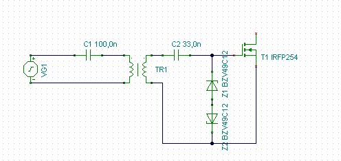

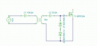

To Tekko's original post
Would it be okay if a shorted gate smoked only a secondary side pulse shaper/driver stage? This is a lot more electronics, including another isolated power supply, and at least a few pF of parasitic load referenced to the power FET source and some more noise, amounts depending on your implementation. Depends on what your objective is. I tend to think everybody is out for maximum signal performance, A pulse transformer can get your drive level shifted in NOWnS compared to that IC. You could try a laser. :)
