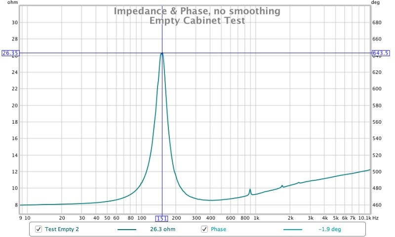

The impedance is the easiest place to see resonances of any kind. A sealed box is the easiest to look at, vents can cause all sorts of problems that makes diagnosing what is what much harder just like what is going on in that ELAC. In an empty box with no bracing they will be quite obvious, bracing can be effective at getting rid of many, internal damping can help with the rest. Vented boxes usually can't have too much internal damping either.I've always thought they wouldn't show up in impedance, but others have claimed they can and I'm pretty sure I've seen some posts here showing that.

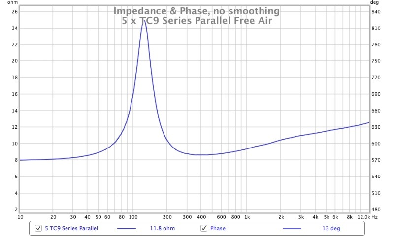

It is also helpful to compare the free air impedance of the bare driver to see what is in the driver and what comes from the cabinet. Example below.
That's familiar looking data, thanks posting! These box resonances look different from Elacs impedance data, these are kind of sharp peaks while Elac has it up and down. Are some of these between driver and back wall, or all from some other dimension? Perhaps Elac impedance shows a port resonance.

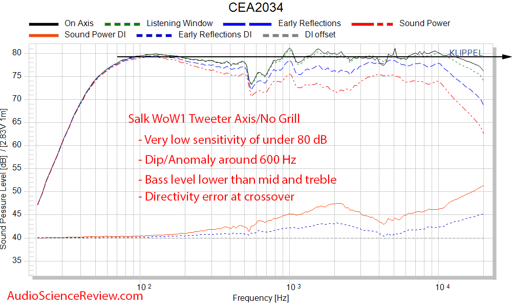

One time our old friends Jim Salk / Dennis Murphy’s WoW1 got an unfavourable review at ASR.
I’ve worked with the SEAS Excel drivers and know that they are a smooth as a baby’s bottom up past 2KHz, and with such a stout cabinet, I was rather surprised to see this dip:

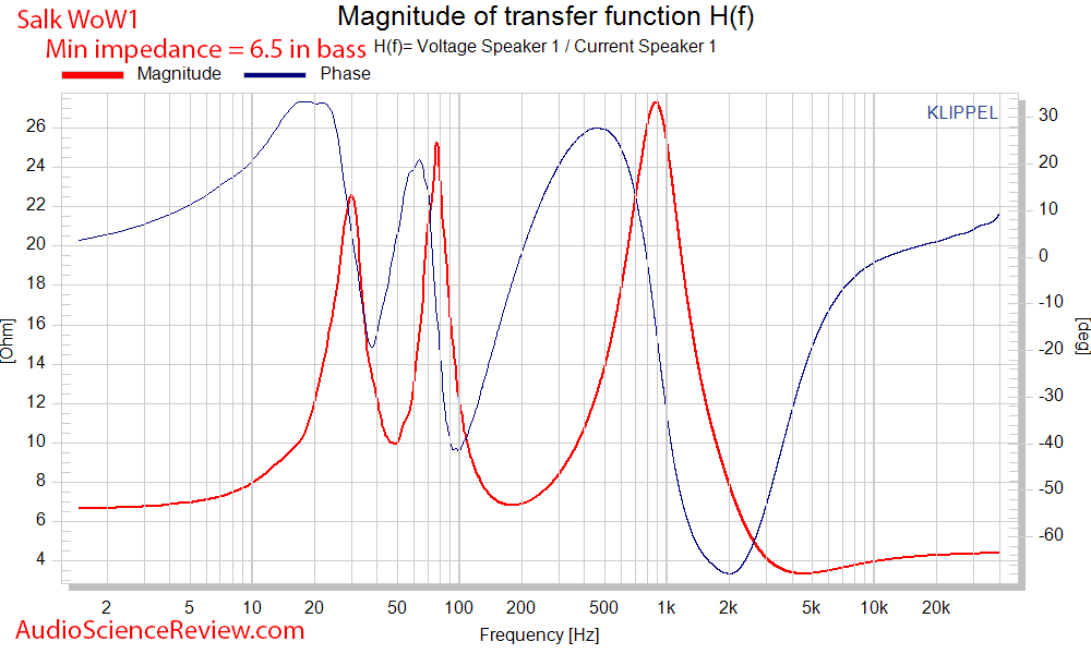

Here is the impedance plot:
That model by Elac has a slot port…

That seems to be a (destructive) port resonance, eventually amplified by coinciding enclosure resonance exiting the port, if you are referring to the 600 Hz valley.with such a stout cabinet, I was rather surprised to see this dip:
