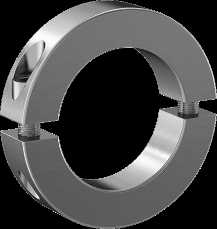

In all of the above examples, the magnet mount insert adapter would probably best be designed with a clamp-type "shaft collar" gripping mechanism to secure to the magnet/motor.

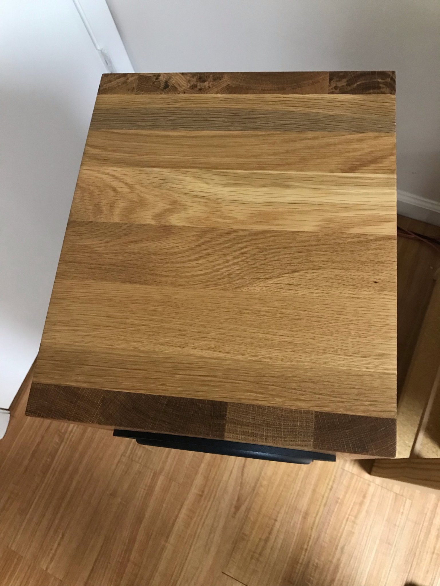

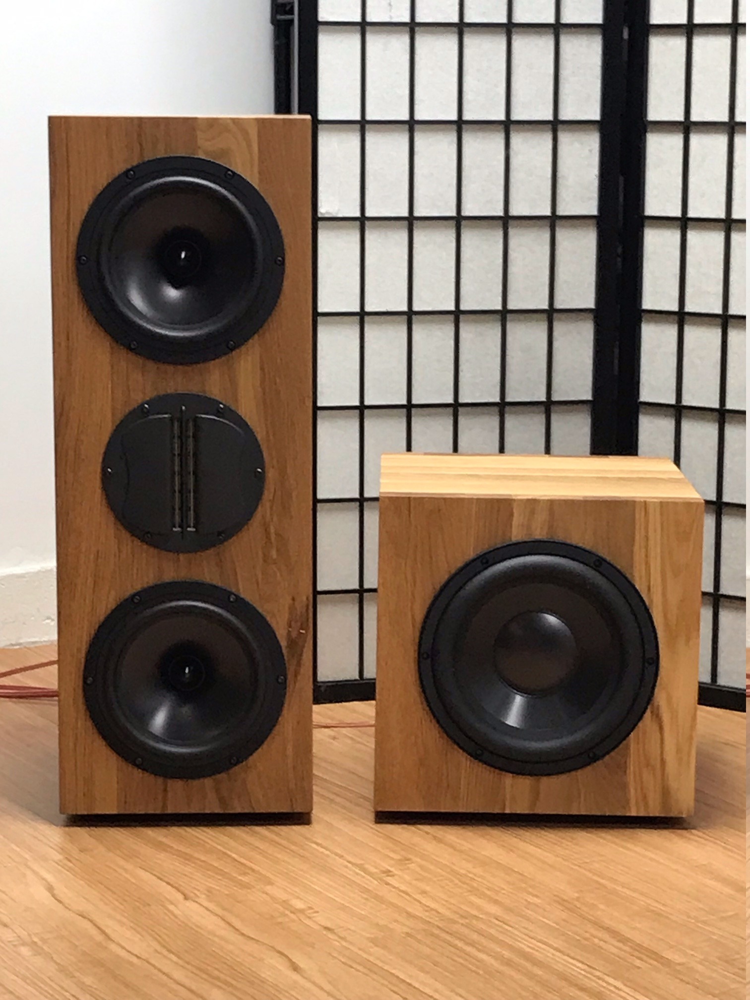

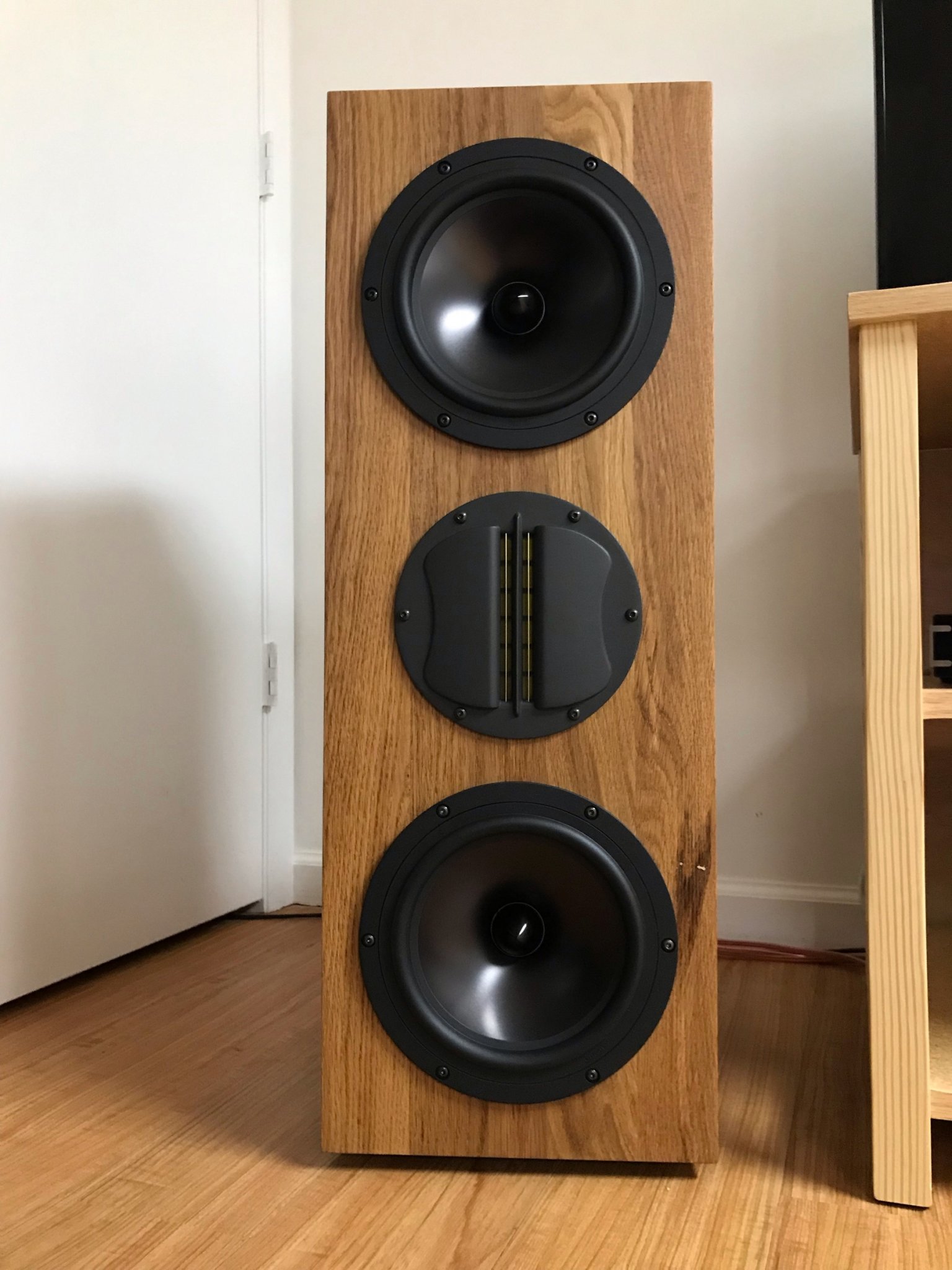

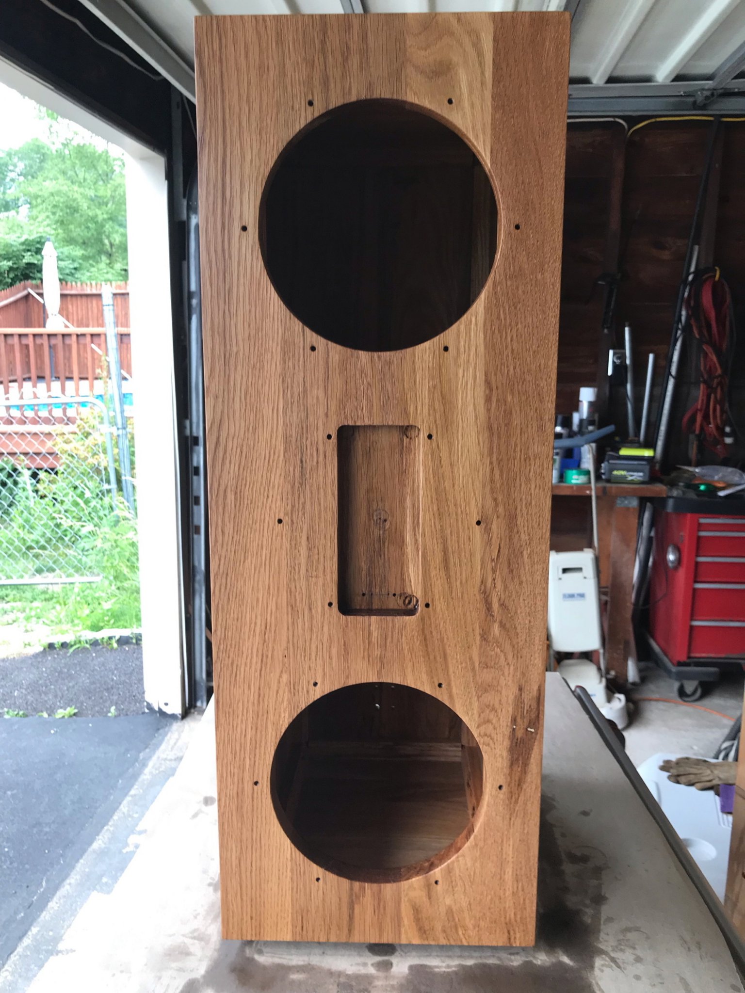

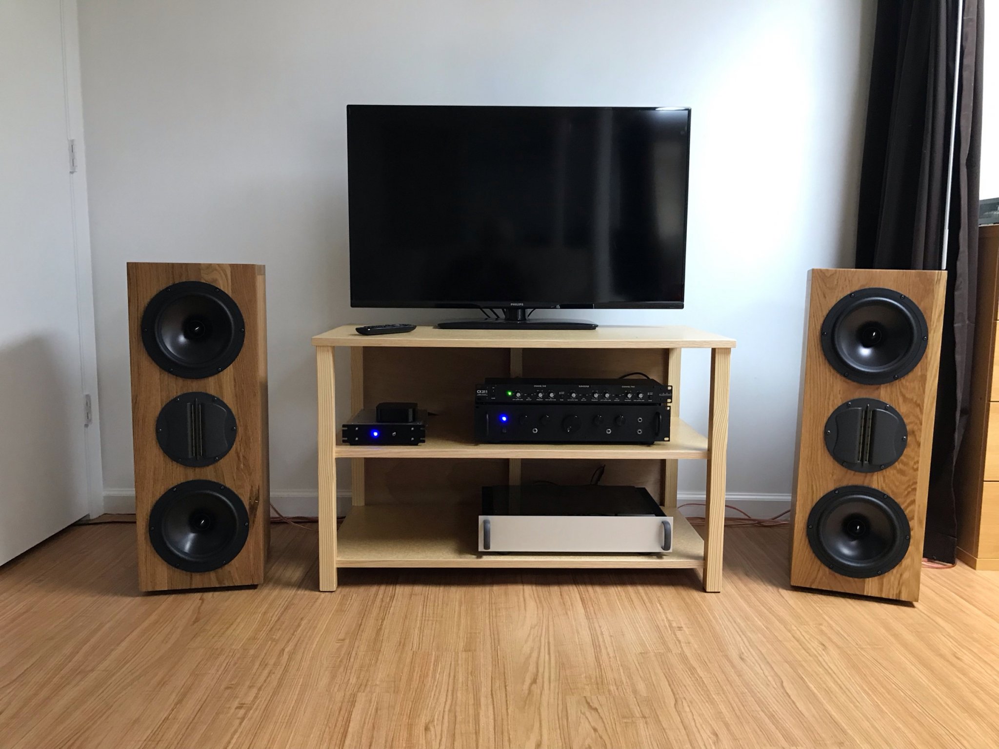

Last year I built these MTM cabinets from 1" thick laminated oak boards. The boards are sold as "stair treads" by the big box stores here in the US.
For this project I just wanted a very rigid material that didn't need bracing. The cabinets are sealed and isolated for each woofer and the tweeter is surface mounted for isolation as well. Sorry, don't have any measurements to show, but they do sound good with very little vibration felt on the outside.
Also built a pair of 10" sealed subs from the same material and have plans for more similar projects.
