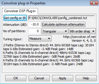

Convolver Settings:
Ok, the convolver filter/wrapper/plugin needs to be set to use your impulse files.
The filter properties will pop up when you try to use the filter with no settings loaded, or access it through Zoom Player, or through Radlight Filter Manager.
As described earlier, convolver can either use a Config file, or a Impulse Response directly, using the "Get config or IR" button.
1. Using an Impulse Response directly
Simply hit the "Get config or IR" button, and pick your stereo (or 6 channel) file.
Then hit the "Calculate optimum attenuation" button.
I don't know enough about Tuning Rigour, partitions, noise shaping to really comment.
The IR must be the same sample rate, and number of channels, as the source file.
2. Using a single Convolver Config file:
This is the easy way to set convolver to use multiple mono Impulse Responses.
Create a text file with the following format:
6 channel 96khz
96000 6 6 0
0 0 0 0 0 0

2 channel 44.1khz
44100 2 2 0
0 0
0 0
F:\DRC\CONVOLVER\44.1khz\LeftSurround44.1.wav
0
0.0
0.0
F:\DRC\CONVOLVER\44.1khz\RightSpeaker44.1.wav
0
1.0
1.0
And so on.
The config files must point at Impulse Responses that are the same sample rate, as the source file, and must have the same number of channels described. What I do is use ffdshow to upconvert all sources to 6 channel 96khz, and just use one config file. Simple.
3. Using a multiple Convolver Config files:
Create a txt file which points at config files for each different sample rate and channel number.
For instance:
F:\DRC\CONVOLVER\config_44.txt
F:\DRC\CONVOLVER\config_48.txt
F:\DRC\CONVOLVER\config_96.txt
F:\DRC\CONVOLVER\config_44_5.1.txt
This means you need to generate suitable Impulse responses for all different cases.
Either by making measurements at all sample rates, and processing them in DRC (with suitable settings) individually (a very big bat file).
Or by resampling the IR files in Cool Edit Pro or similar.
HOWEVER, for a digital crossover, you will almost certainly want to use a standard sample rate - so I would resample everything to 96khz before convolver.
