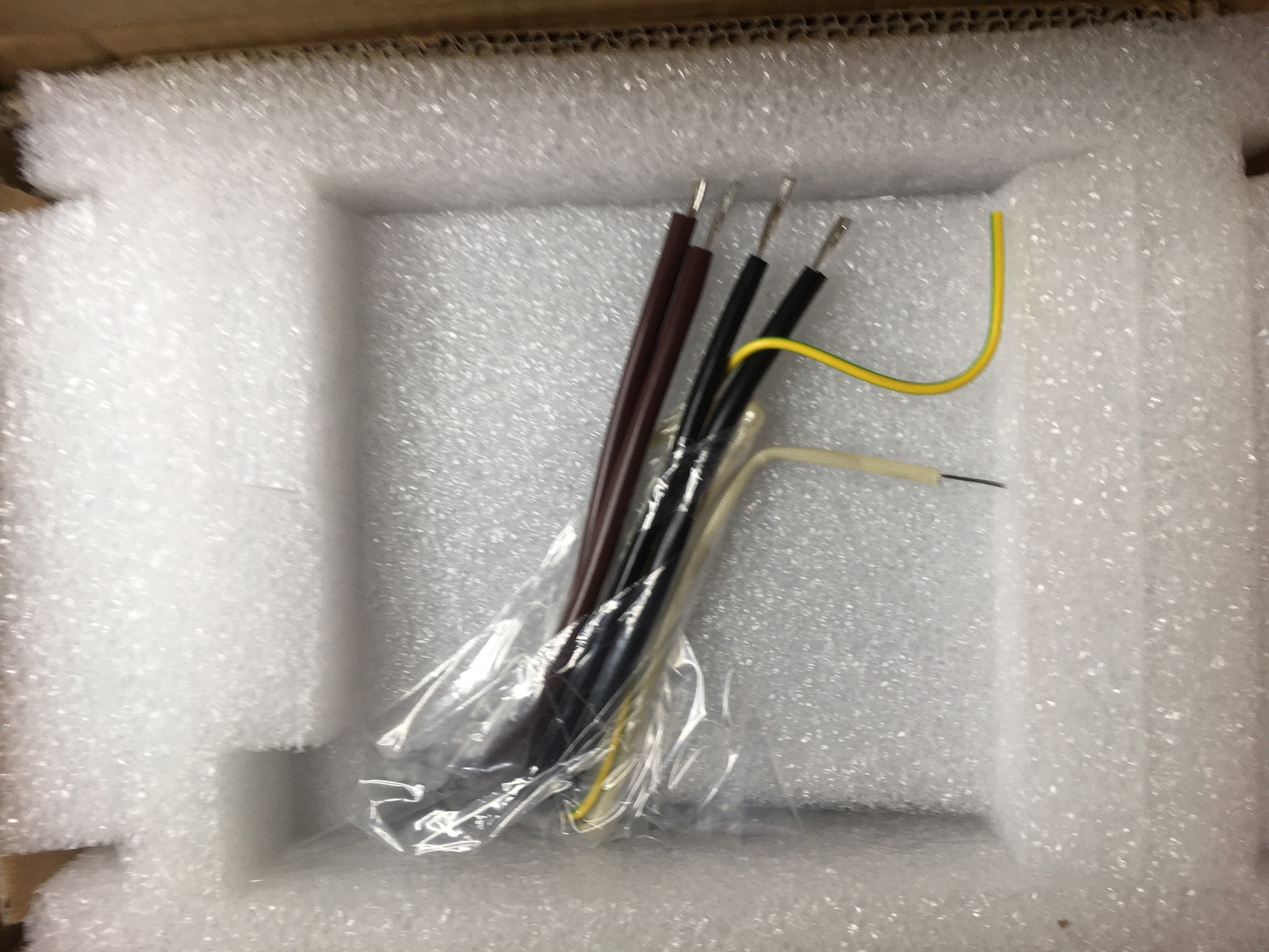

Everything but the chassis is here. (probably 1 or 2 parts glitches and Salas' B1 waiting for me)
At the moment, I'm trying to work out (like, calculate ) the heat-sink-requirements. Looking for power-dissipation per transistor etc etc...
