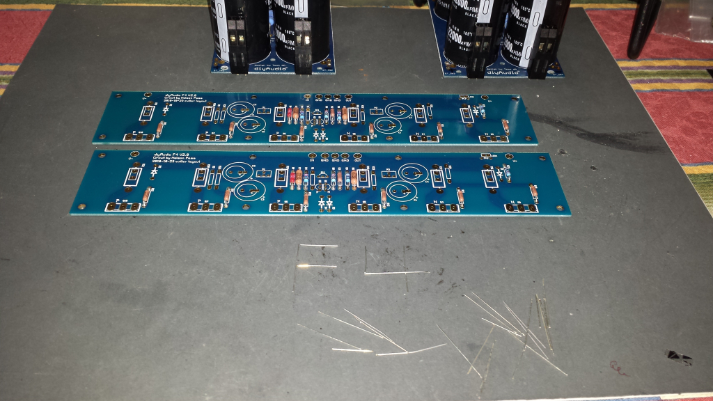

I just purchased the F4 boards. Now that I'm committed to this project, I have a few questions.
1. Will my preamp swing enough voltage? The specs aren't explicit about that. It's a Linear Tube Audio MZ2 OTL preamp (with LPS+ linear power supply) that I have used to inadequately drive my Omega speakers in the past. I want that sweet OTL sound amplified. The specs page says the following: "Voltage gain: (4-ohm load); 10.3dB, (14-ohm load): 12.4dB." I'm guessing it will work. Right? (Edit: I just realized I can probably just measure the voltage swing myself.) The MZ2 used as an amp puts out 1 wpc, if that is a better way to go, i.e. using the speaker posts versus using RCAs out. . . .
2: Do I need to put a pair of resistors between this preamp and the F4? If so, how best to implement that?
3. The transistors are out of stock at DIYAudio's store. Do I wait, or is there an alternative source, like Digikey or Mouser? I'm assuming I need to buy a dozen or two and then match 'em if I don't buy from DIYAudio.

Not pro enough to answer most questions, but for #3. I bought from punkydawgs here: Toshiba 2SJ74 + 2SK170 LAB MATCHED QUAD to 0.03mA AND 4mV (7-8ma range) | eBay
More expensive, but confirmed genuine parts and great matching. Note that regardless of where you get them, you need the B type (Idss ranging from 6.0-12.0). I failed at that myself the first (non-diystore) time around...

Soldersmoker: a few reactions to your questions:
1) the gain from your preamp should be enough to work with the F4, but this will depend on how loud you like to listen and the efficiency of your specific speakers. My BA-3 preamp build delivers about 14dB of gain (I reduced its output to work with a variety of amps) and works great into my F4.
2) I'm not sure about this at all, I'm hoping someone else can guide you here
3) Yep, you can buy the output mosfets at Digikey or Mouser. If you purchase more than you need, you'll have an easier time matching them. I think if you order 25, they'll come in the original plastic sleeve from the manufacturer, so you'll be getting 25 from the same die lot, which will GREATLY increase the likelihood that you'll have close matches. This will certainly cost more, but will also leave additional matches for a future project. If you don't end up building another amp, you can sell your matches to someone else in the Swap Meet forum. If you need to know how to match your mosfets, click on the "Aleph-X Amps" link in my signature and do a search on "Matching Mosfets." I've got a fairly detailed procedure there.
And for #2, unless I'm mistaken about how the LTA works, you'd only need resistors if driving the F4 from the speaker outputs. Traditional line-level RCA outputs will connect via normal cables.

Realizing now that I was only talking about input JFETs and that both the JFETS and MOSFETS are sold out at the diystore.
I bought my MOSFETS from alweit on ebay. Shipping takes a while as he's in Isreal, but again, he's well reviewed from folks around here... genuine parts and good matching. He sells matched quads here, just buy three sets and ask for 4 matched trios in the notes: 4 X IRFP240/IRFP9240 (Matched quad) | eBay
