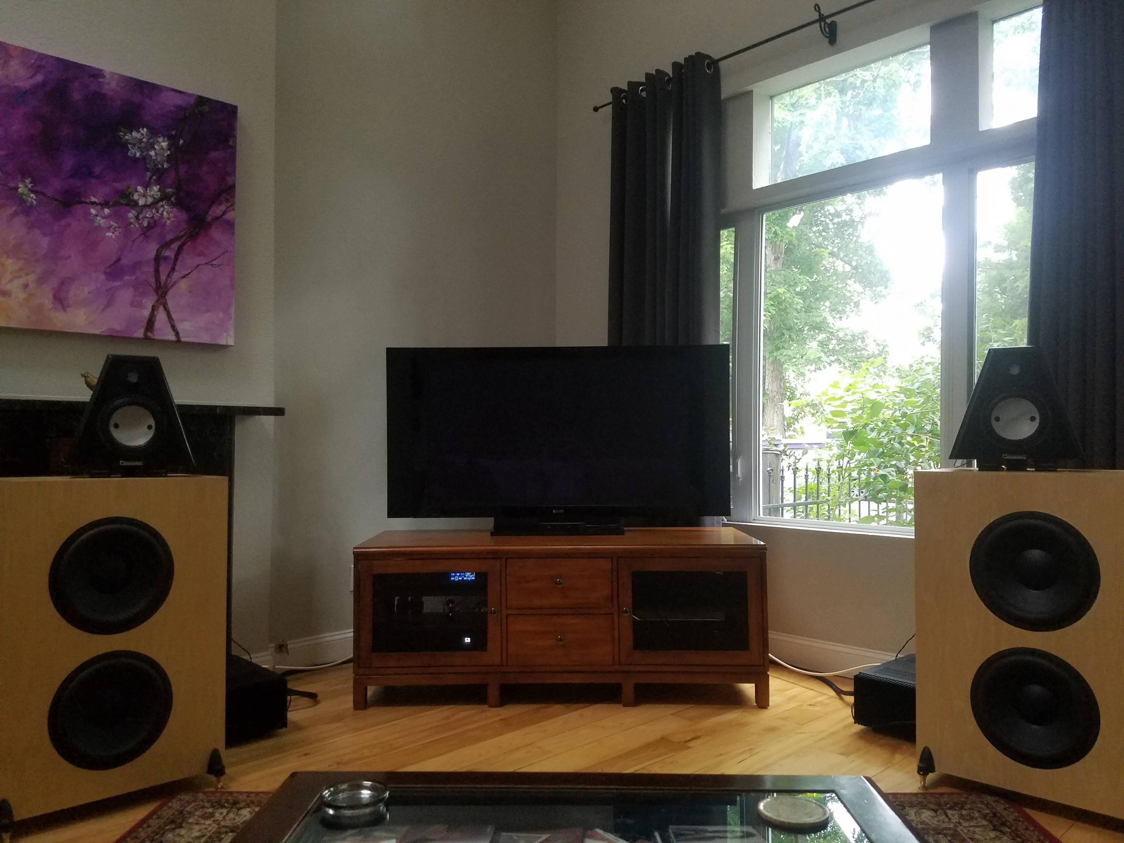

Thanks everyone. Stereo sounds the best it ever has. Dual F4s with paralleled inputs doing vertical biamping on Coincident PREs. A little bitter sweet packing up the 300b amps for their new owner yesterday, but the F4s do a number of things better than they did on these speakers. Maybe I've lost a little touch of front to back soundstage depth. I think that's about it really. Gained clarity, extension, and control.
Packed up the dining room work bench since I'm done building... of course I'm already thinking about doing a SissySIT.
Thanks for all the support. It was fun to build and learn.
