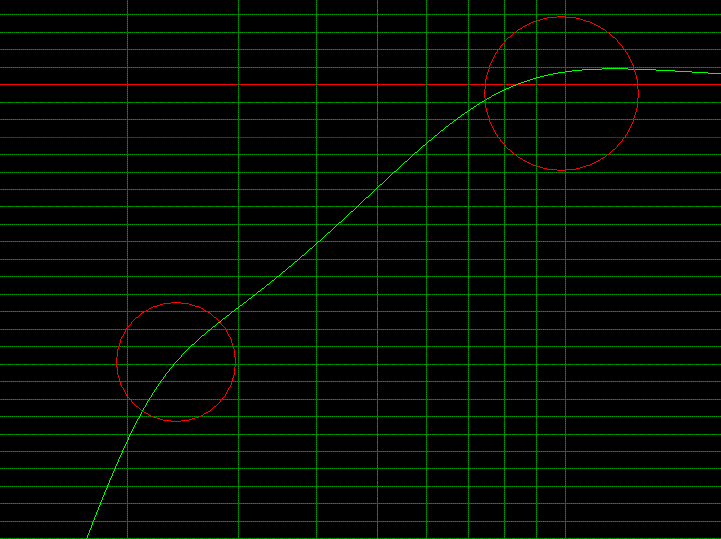

Depends on what sort of 19 litre box. Based on the manufacturer's published data, and assuming a voltage source amplifier & about 1/2 ohm series R for typical wire loop & connection losses, then:
A sealed cabinet with low leakages & reasonable lagging on all internal faces should give you a system Qtc somewhere in the 0.9 - 0.95 region, depending on just what damping you use & how well-built the box is.
Conventional vented is pretty much a non-starter at 19 litres. The smallest vented box I'd be willing to use would be about 33 1/2 litres tuned to Fs. However, if you go 19 litres tuned to 50Hz & resistively vent (i.e. stuff the vent) then you should have something ~ close to the above sealed box until it finally unloads 24dB/octave at some relatively low frequency & amplitude. A purer resistively vented alignment (sort of) would be to drill about 50 x 3mm diameter holes in one panel & fix a decent amount of damping over them for a nominally similar sort of alignment.

That or stuff the vent. You'll have an alignment lurking in the low[ish] 0.9 Qtc region, i.e. slightly peaking, but you say this isn't about precision, and there are a lot worse things in life than that.
