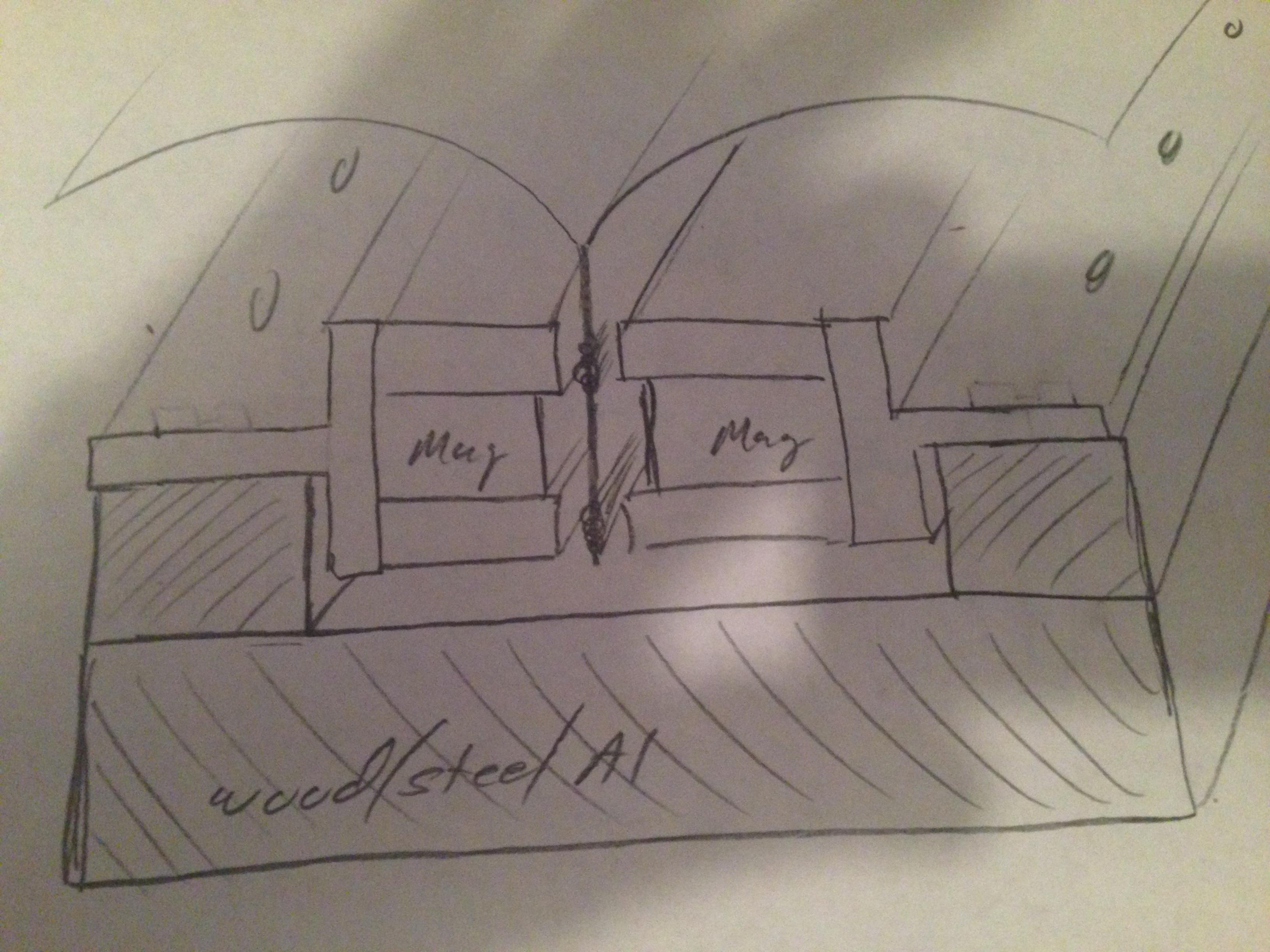

well without doing a structure analysis I cant say for sure. My gut tells me that you may be beyond point of diminished return here. Beam height is where the stiffness is. adding a bunch of material ,reguardless of shape, to a given space really doesnt add a lot of stifness and you have a serious amount of force to overcome.
I supose you can give it a shot and see BUT if I were you I would try to find or make some U channel to fit those magnets into. Ive even made such a thing from wood in past.
The magnet pull force is somthing like 1/ distance to the 4th power. As they get close to each other the force really takes off.

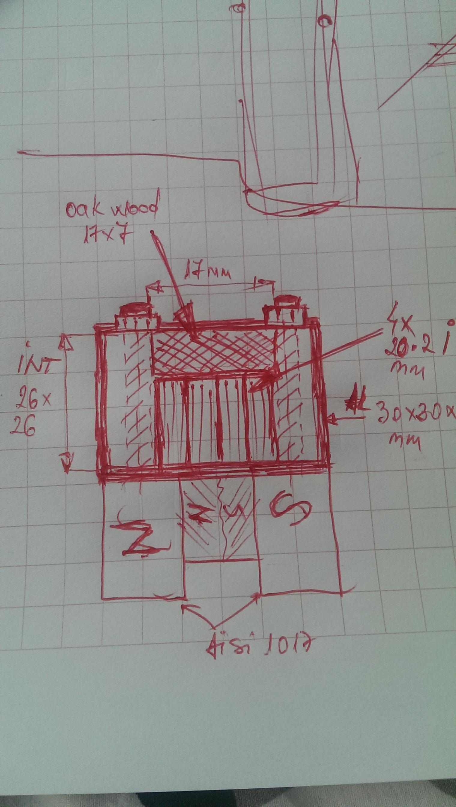

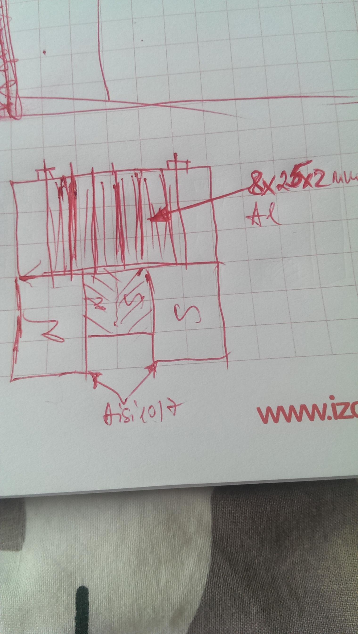

I have leaved the ideea of all Al tensionning frame, and now trying reinforcing with Al and oak wood as spacers and magnetic field insulators and 5mm U shaped steel. Will try these things this week.. i just finished drilling the 5mm steel for just one ruban in a couple of hours yesterday... Its very hard to drill a hole straight without proper tools .
I have to find a sollution for my bending issue.

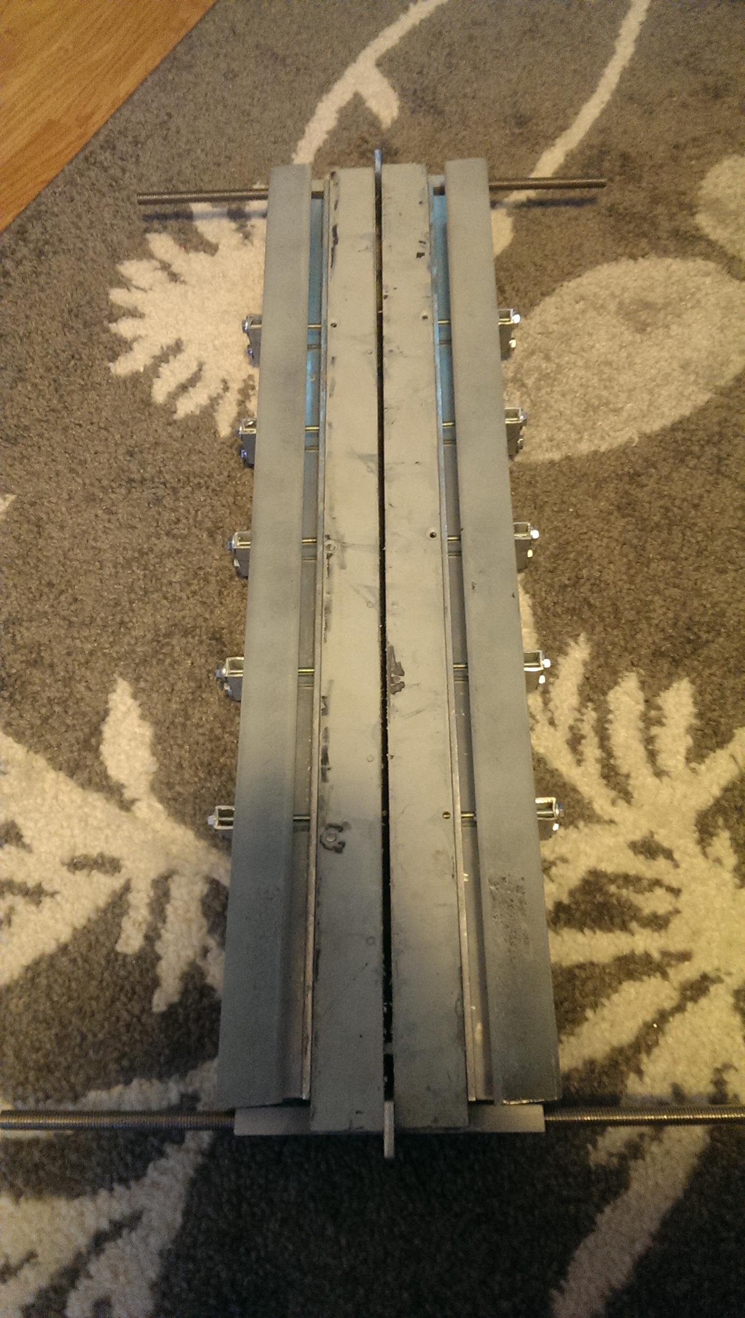

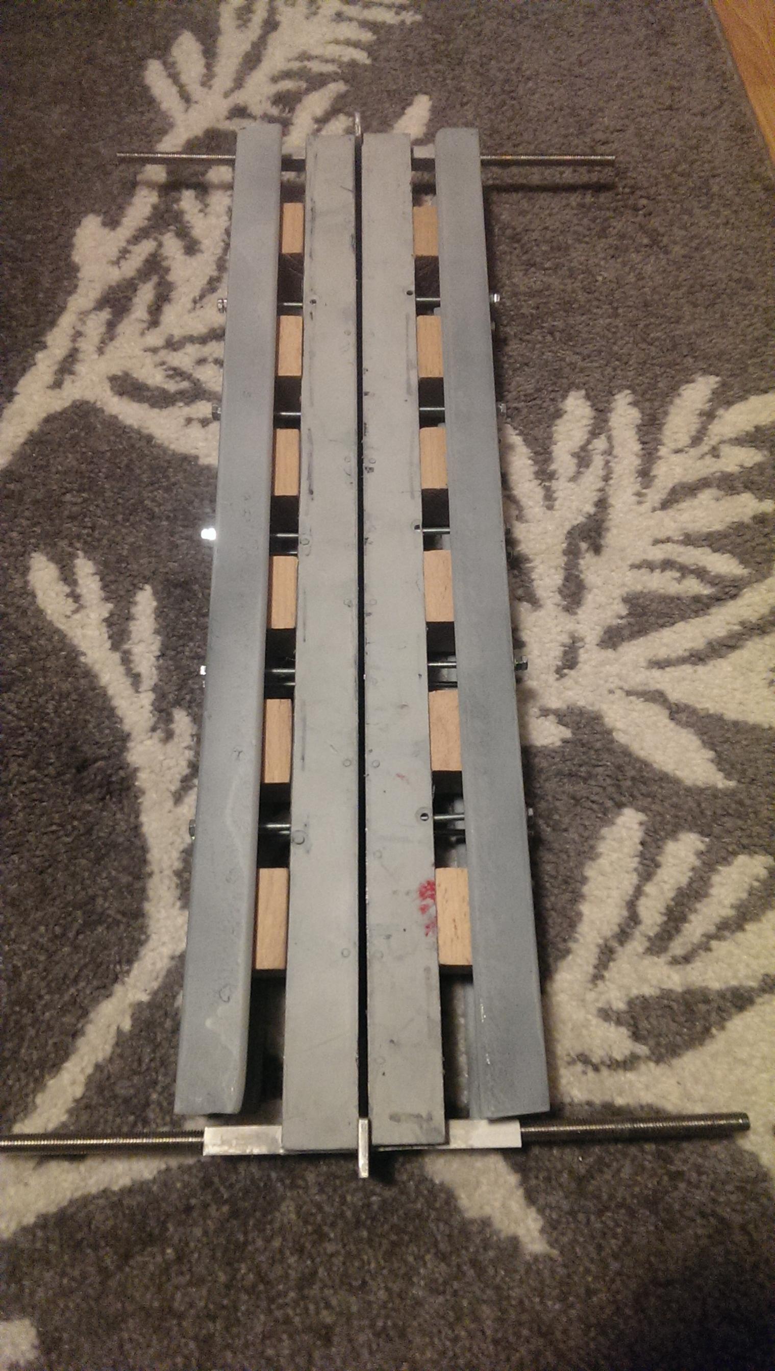

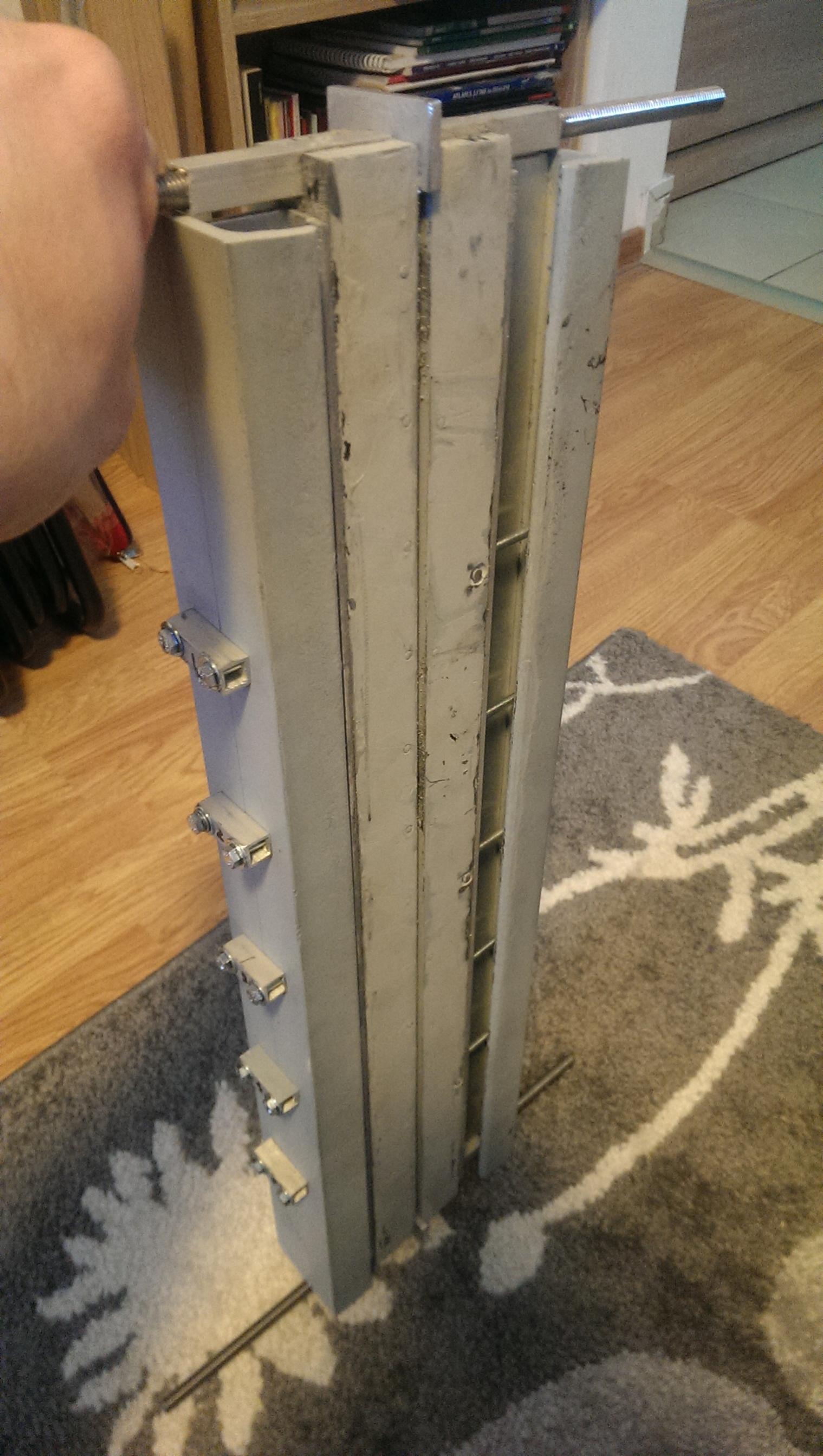

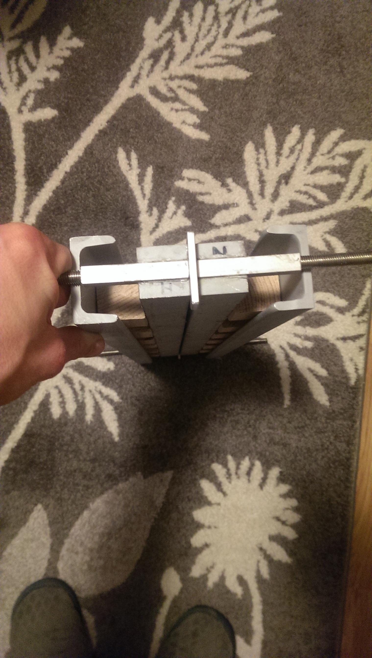

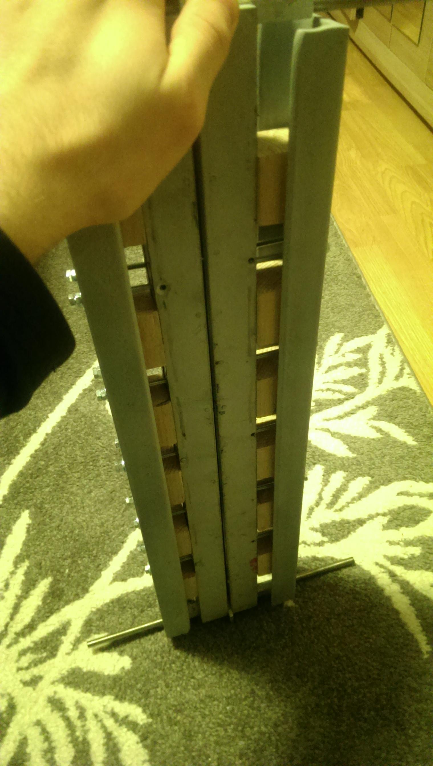

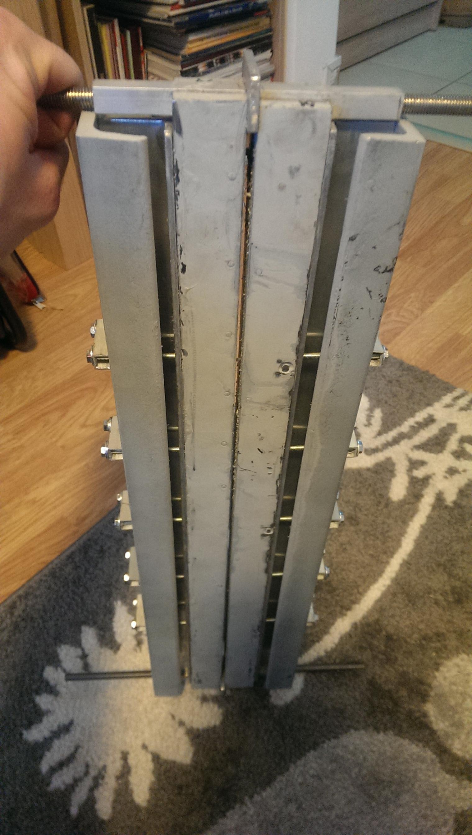

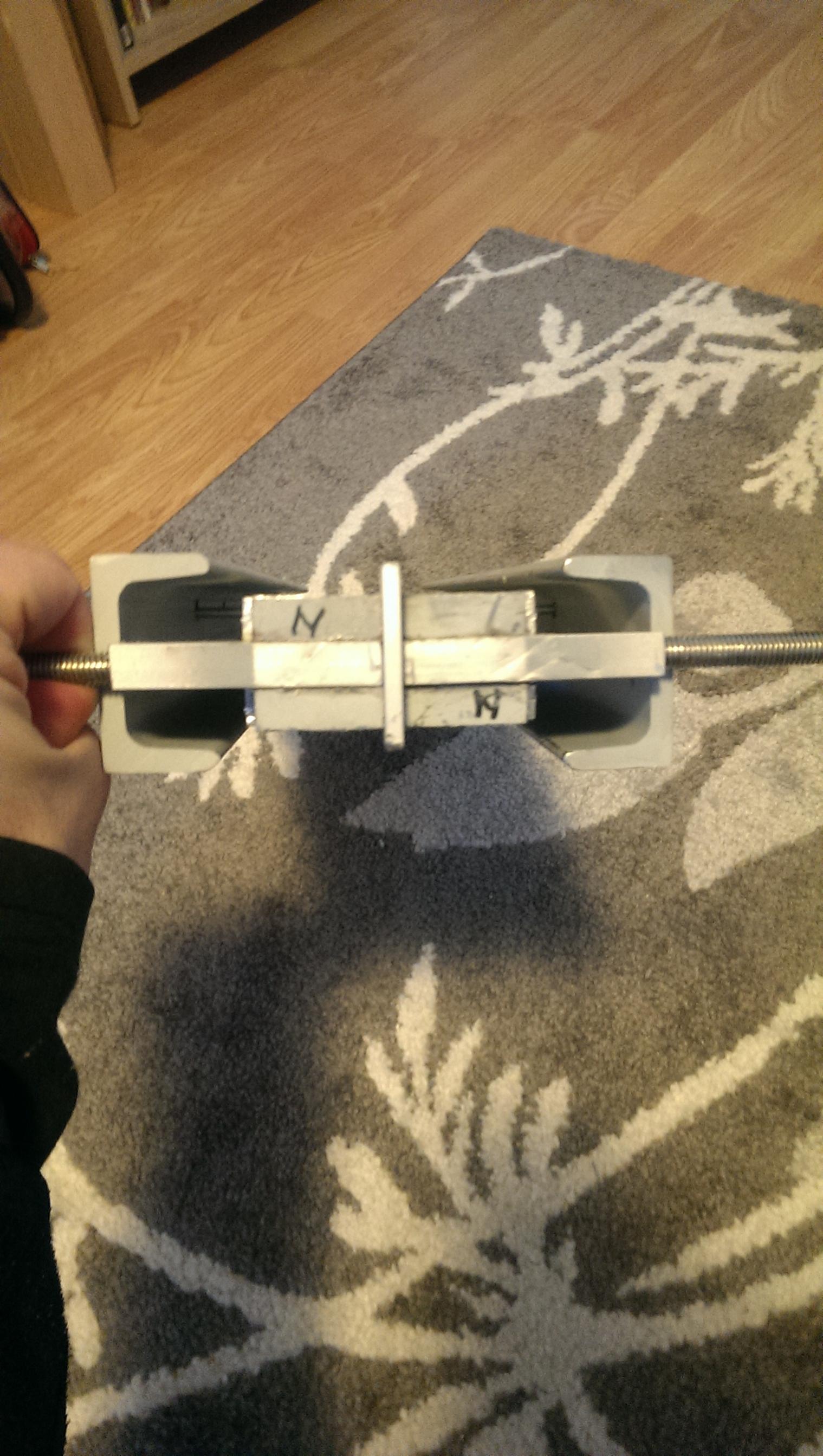

Hello my friend Wrine!
I'm back, and this time with good news. It seems that my ruban needed a different aproach, this time with U shape 5mm thick steel. It is a total succes! Now the plates doesnt bend anymore and the distance between the plates and the reinforcement is sufficient so that they dont get magnetised. I need to add some insulators to the screws because they are made from iron now instead of olc steel...
The magnetic gap is 4mm now instead of 3mm as before. The reinforcement resists at 3mm gap (tested) but i need to eliminate the square Al pipes from the top of the U frame, thing that i dont want. The 4 mm gap seems more convenient when centering the coils so i'll leave it as it is. I need to drill the steel for the other channel but will leave this for tomorrow.
Bellow i atached some pics with the results (4mm gap).
