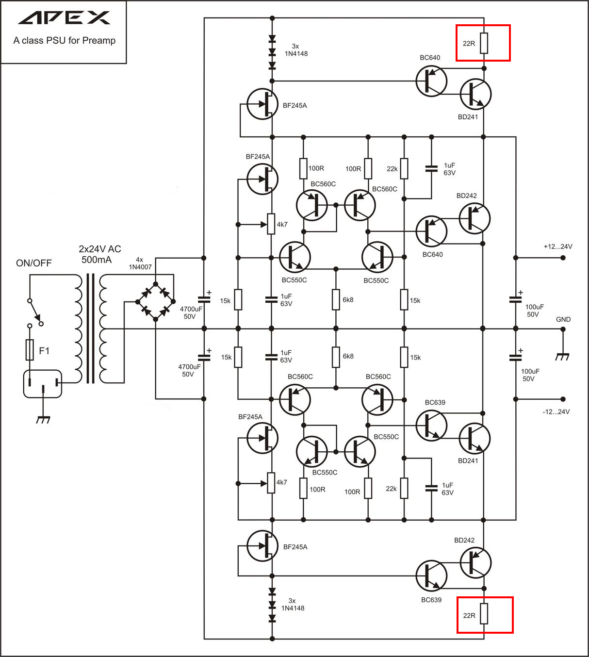

Hello Mr. Miles!
I draw a circuit to supply this and here are some images.
When my realization is complete and if everything is ok I will move my version of the circuit in pdf format.
Thank you and friendly!

Hello Miles!
I found BC639 & BC640!
My power supply works but the adjustable resistors have no effect.
For testing I connected transformer 2x14v and I have + / - 18v output. Another transformer 2x17v and I have about + / - 24v output but no ability to adjust the output voltage.
I checked my circuit several times and everything seems ok.
I am doing test without adjustable resistors and output I + / - 0v.
Any idea?

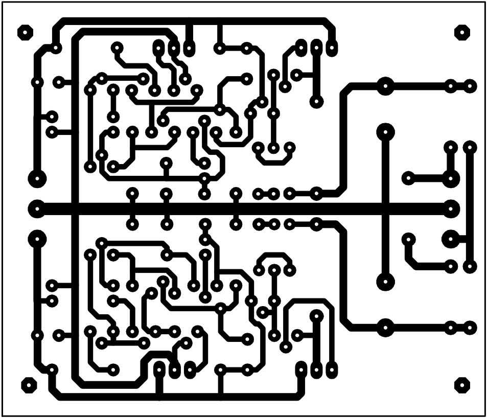

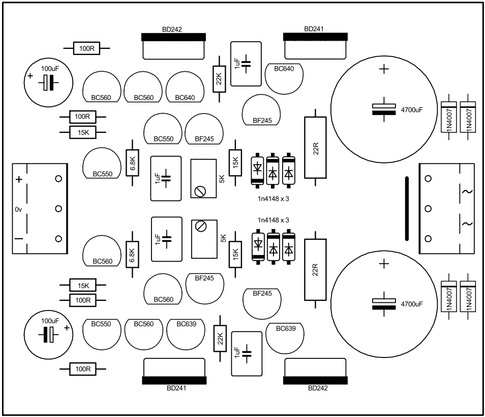

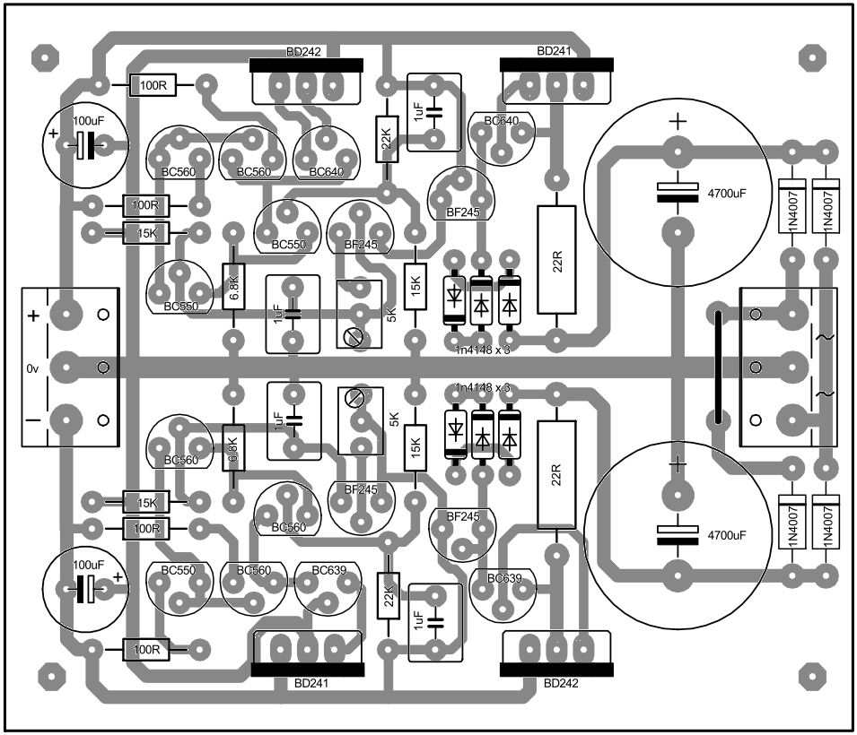

Hi to all!
I still can not figure out why it does not work.
I looked at the pcb Alex mm and the wiring is different on the legs of BD241 & 242!
The error is on my pcb or the Alex mm.
Regards!
I can't read the lower drawing clearly.
But it looks like the bd242 has been reversed to fit the heatsink, but the pin labels have been left in the non reversed places.
The BD241 is definitely wrong.
The Pins are labeled ECB, but all To220 are BCE.
The top left drawing and the top right drawing are correct for To220, BCE.
Hello everyone!
I needed a single-rail PSU +24v, so I used an apex schematic but modified it in a way, that I took only above part (positive) and feeded it from a ready rectifier. So I have on input about 36v dc (24/1,4) but whatever I do, i have on output no more then 13v.
I couldn't get BD241/2 so I replaced them with MJE3055/29T. Can that be a problem?
Or I suspect that 15K is too much for BF245 in this case and this value should be different for a single-rail PSU. Any ideas?
