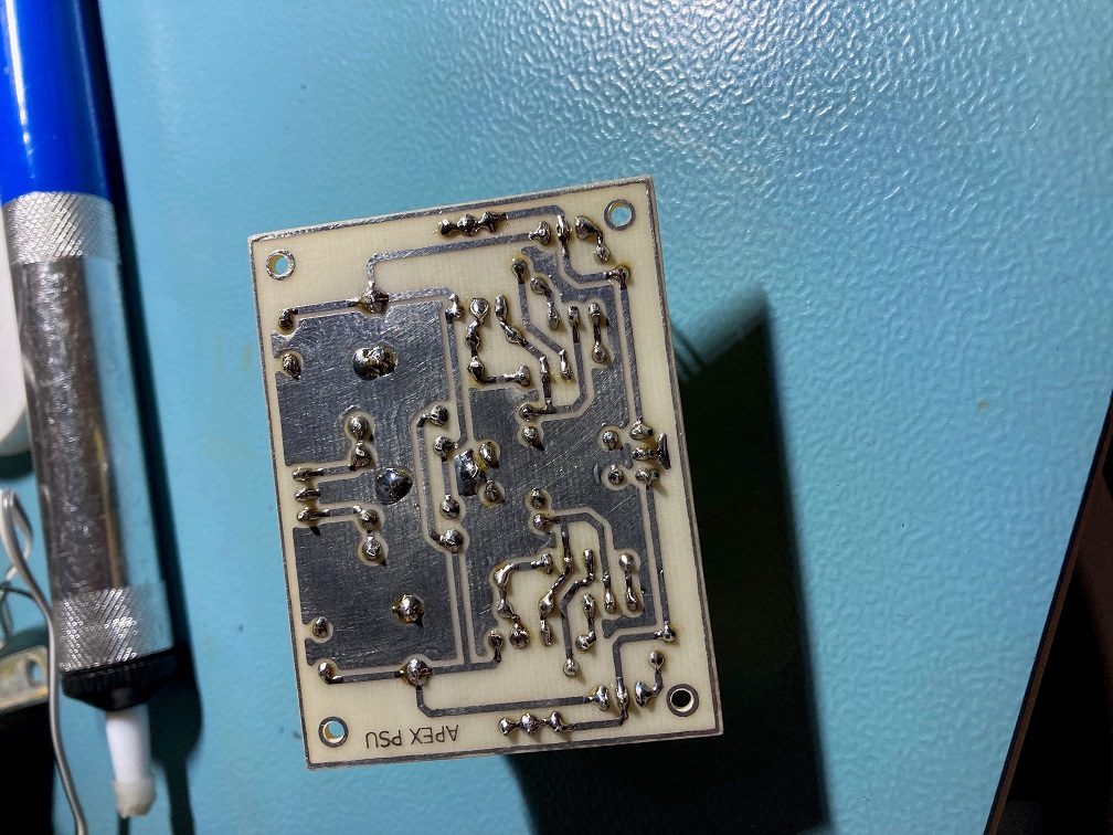

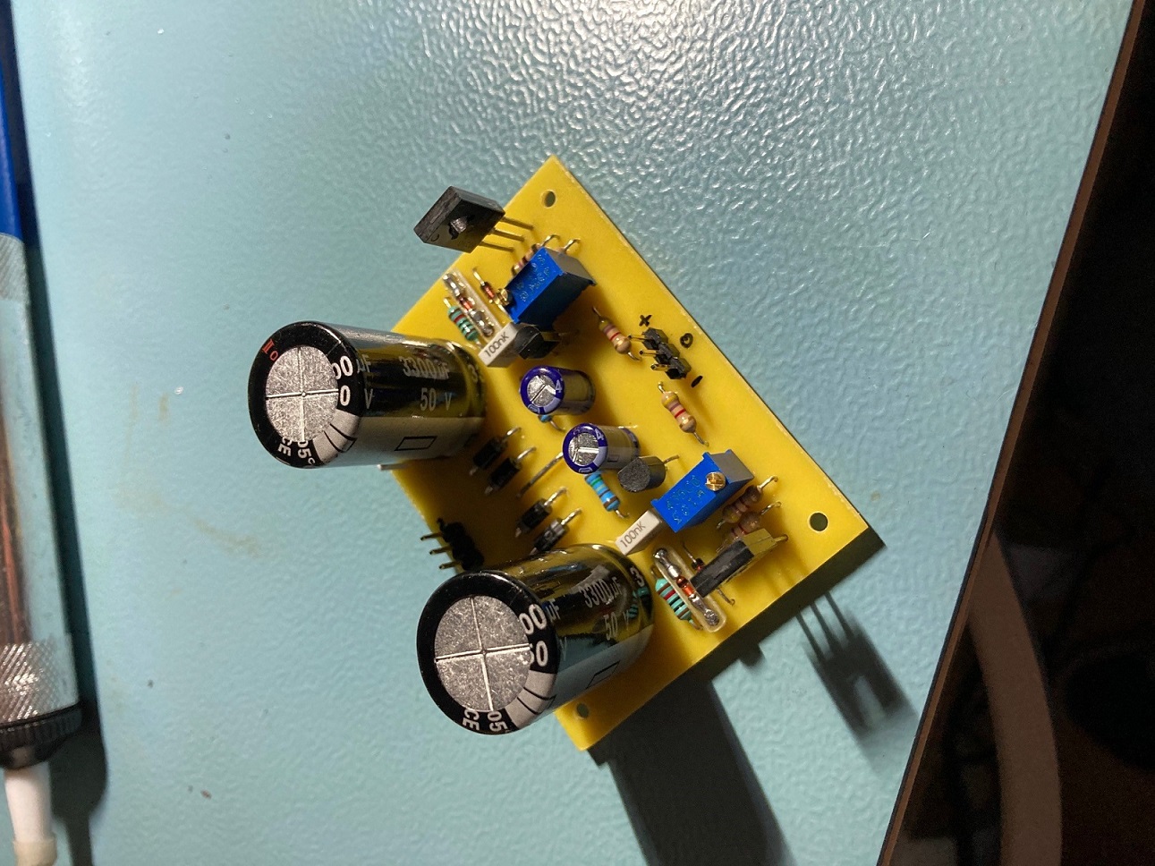

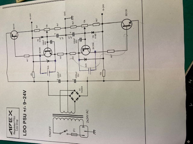

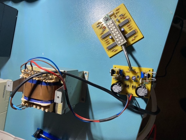

Hi all,
The assembly is the following: mains transformer 220 / 2x24Vac - stabilizer - the load that is powered at 2x15Vdc with a maximum consumption of 100-150mA.
The phenomenon is:
1 - when the assembly is powered by the network, all this work does not work, the voltage on the positive branch + 15Vdc and 0Vdc decreases somewhere up to 5Vdc and the value between 0Vdc and -15Vdc remains ok in the parameters.
2 - if I interrupt the power supply between the stabilizer and the load for an interval of 1-2 seconds everything works properly.
What is this phenomenon called, what is its cause and what is the remedy?

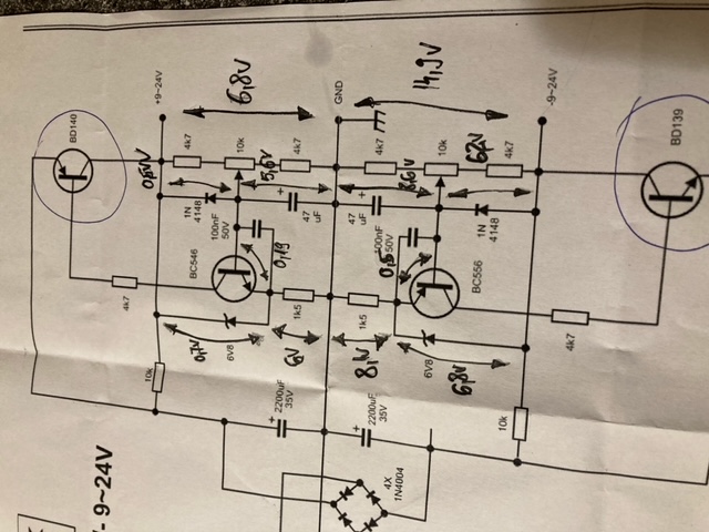

Re your point 2 - this may be called latch up.
Did you try to power on with power switch ?
I wrote check input voltages also, these are missing from the figure.
Seems like a start up problem. Try to decrease 4k7 base resistor BD 140.
I put R of 3K9 same result
I put R of 3k6 the problem moved on the negative branch only the output voltage is -0.7v ...

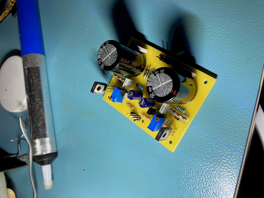

I managed to solve the problem with the help of a colleague.
After verifications we came to the conclusion that one of the branches did not synchronize perfectly with the other, that's why the BD140 transistor did not open and the source remained blocked on the '' + '' branch. A negative voltage of about ''-7Vdc'' appeared on this branch.
To prevent this from happening again, I added a 470nF capacitor between the collector and the emitter of transistors BC546 and BC556.
Now everything works perfectly.
Thanks for the help.
