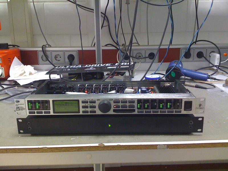

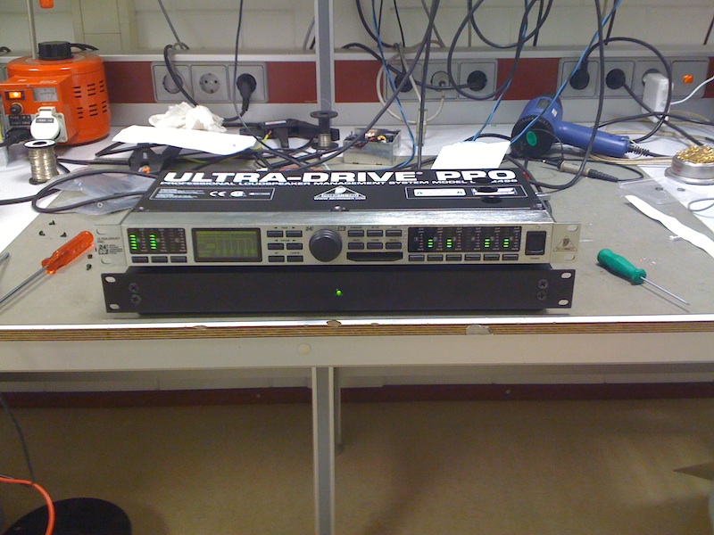

The Behringer DCX2496 that I referenced costs under 250 Pound (as little as 150 if shopping around).
The basic digital core of this unit is not bad. The analog design is awful. But that is quite easily solved. It could also do with a better SPDIF receiver, I would probably substitute a WM8804 instead of what is in there now (needs a small new PCB). But it does take SPDIF in directly.
As said, my suggestion would likely be to take the analog output directly from the DAC Chips, apply it to a set of DS1666 Volume COntrol Chips (these are quite good for solid state volume controls) and go from there directly (and still balanced) to a balanced chipamp. Such a system is pretty much the purest you can manage, except for using six S&B TX-102 on the six outputs...
I personally think that IF we can solve all issues (time alignment, equalisation, crossover etc.) that are so easily solved in the digital domain in the analog domain to the highest possible quality, the results may be better.
But just like gainclone vs. extreme discrete designs the argument is mainly academic.
Doing what I suggest above really well will already be "so good" that in most cases the result will suffice.
