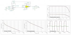

Dear Leon,
Promise is promise. I simulate here for you a concept of a nested chip-amp. The difference between normal and nested, is the almost 20 dB. better S/N ratio of the nested one! The output impedance nested is almost 2uOhm, wich will result in a dampingfactor of over a million :D
Chip amps with smart feedback techniques, like this one can outperform many discrete designs and sound trully phenomenal in my opinion.
With kind regards,
Bas

Dear analog,
Wel I built chip amps with a comparable feedback concept as I showed above. In a nested feedback in my opinion, the sound is improved day and night over the standard one. And most noticeable, the bass, and sub-bass is so much tighter. Like you put an out of focus picture in focus. Not to invoke a new discussion, but I truly believe the much higher dampingfactor is cause of this. The improved S/N ratio gives room for better micro detail information. I would say build one yourself to hear the difference, it must be heard ;) I never want a standard chipamp anymore after I heard this.
With kind regards,
Bas
