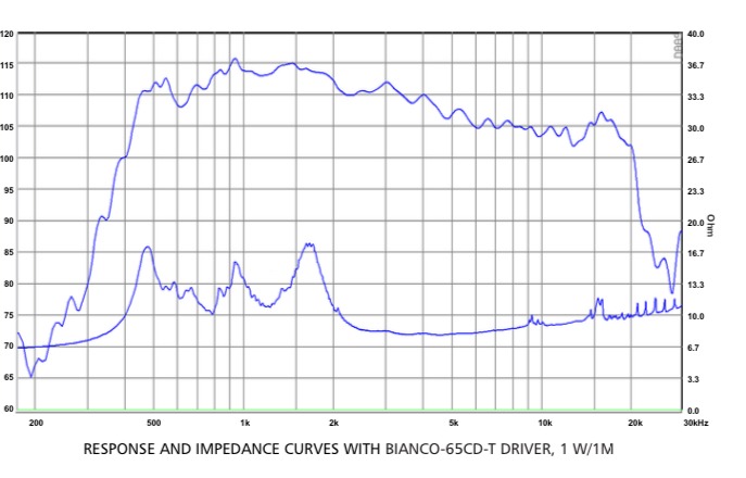

It’s interesting how close the raw response of the H280 horn with the tiny SB driver is to the datasheet:
Complete with dip at ~620 Hz and ~15 kHz. So clearly these are inherent to the horn itself, it's not super smooth overall.

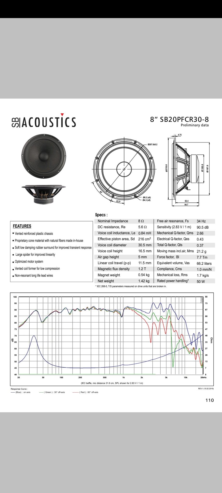

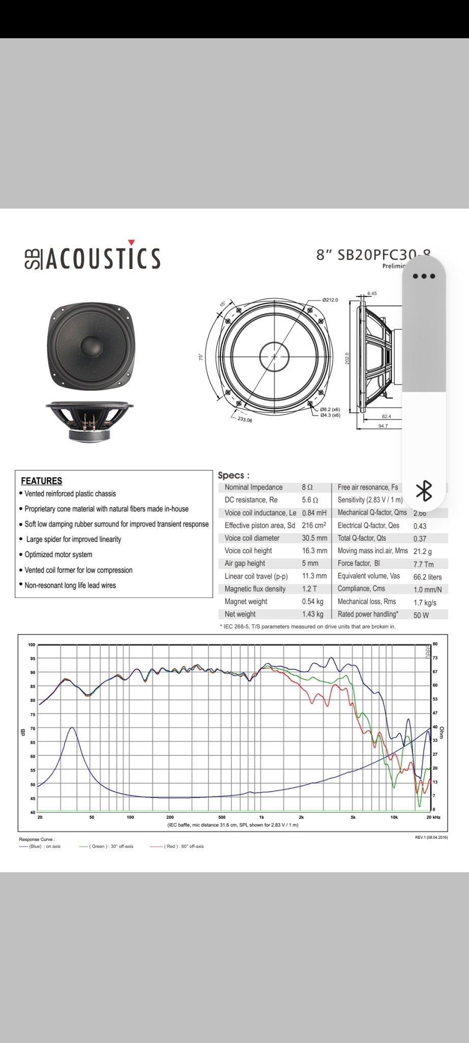

Quick and dirty calc in WinISD puts two drivers in a 300x300x450mm ID (30 Litre) box (Less approx 30% for Horn+Driver Volume) at an f3 of 71hz with only a 1db knee in the responce then it rolls off.

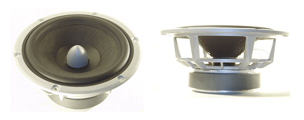

If one goes for a 650 to 500 Hz x-over, one could even use a CD like SB 65CDN-T. A larger 3D printed back cover would lower the standard crossover point a bit, while also lowering distortion a bit.
I may also have a solution for the phase plugs of my my HDS drivers: I can simply add an O-ring to seal the gap. It should be flexible enough to not interfere with woofer motion. The question is still if I actually need it though?

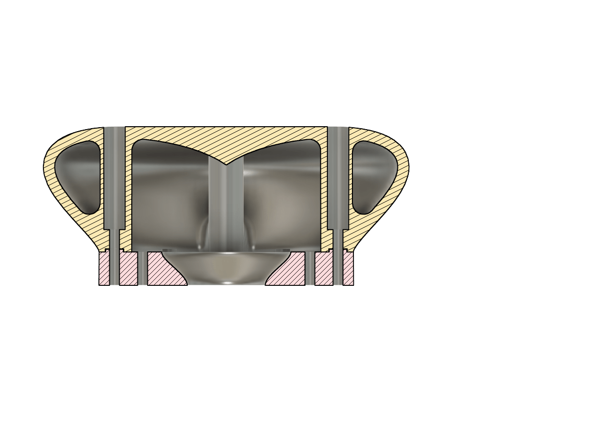

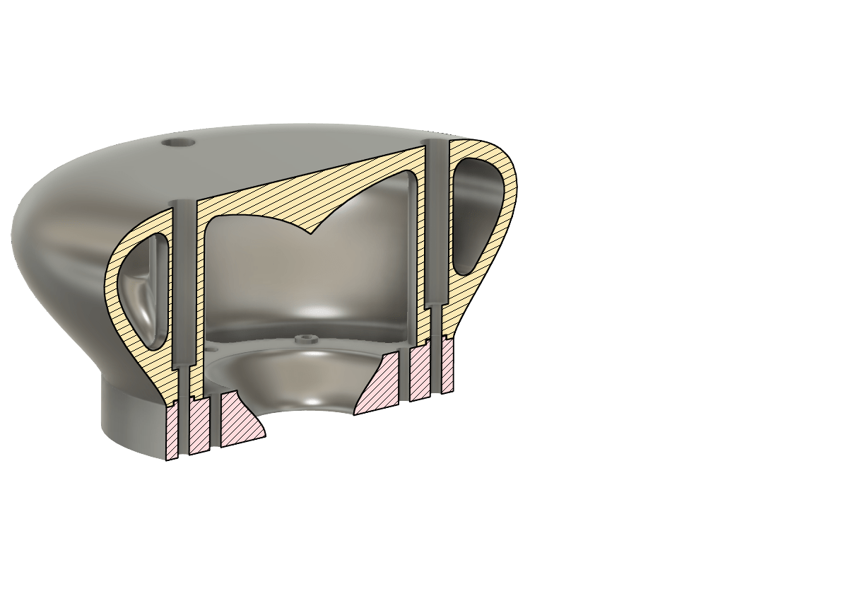

Superb work! Can you share the STL or STEP files for the nozzle and rear chamber?
Filling the rear chamber with white melamine foam might work well. Or plain fiberglass.
Can do ;)
A few points re these files.
1. This design is a prototype, I have not printed it yet.
2. The Tangent weight for the loft at the surround of the SB65 has been lowered from 1 to 0.5 to smooth out the shape a lot more, but may rub at full excursion, to be tested.
3. The model may not follow parametric design best practices, I am still learning, hence the prototypes, I may do a full redraw with this in mind.
4. The bolt holes are 4.5mm wide for m4 bolts.
5. The third attached file can be renamed from .txt to .f3d and should load in fusion for full editing.
Let me know if anybody needs an edit, happy to oblige.
