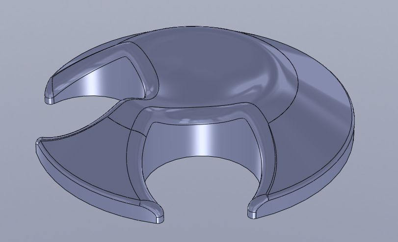

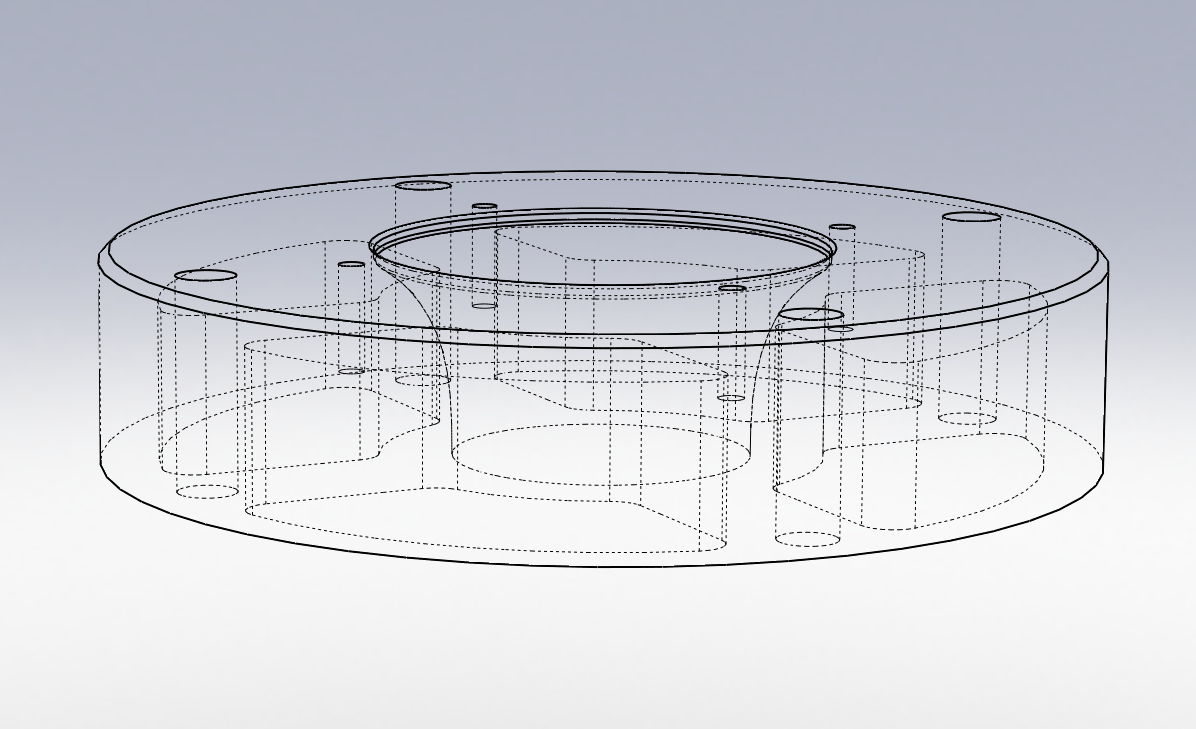

You are in luck, I found the files!
Here are the STL files for my version of the Xbush speaker. LTH horn wall adapter for woofer mounting, 6-hole drill template for horn wall, DC200 cone volume fillers, and 3 sizes of SB65 throat adapters.
Enjoy!
Horn wall adapter:

Throat adapter:
attachment.php
DC200 cone volume filler:
attachment.php

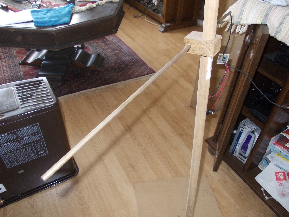

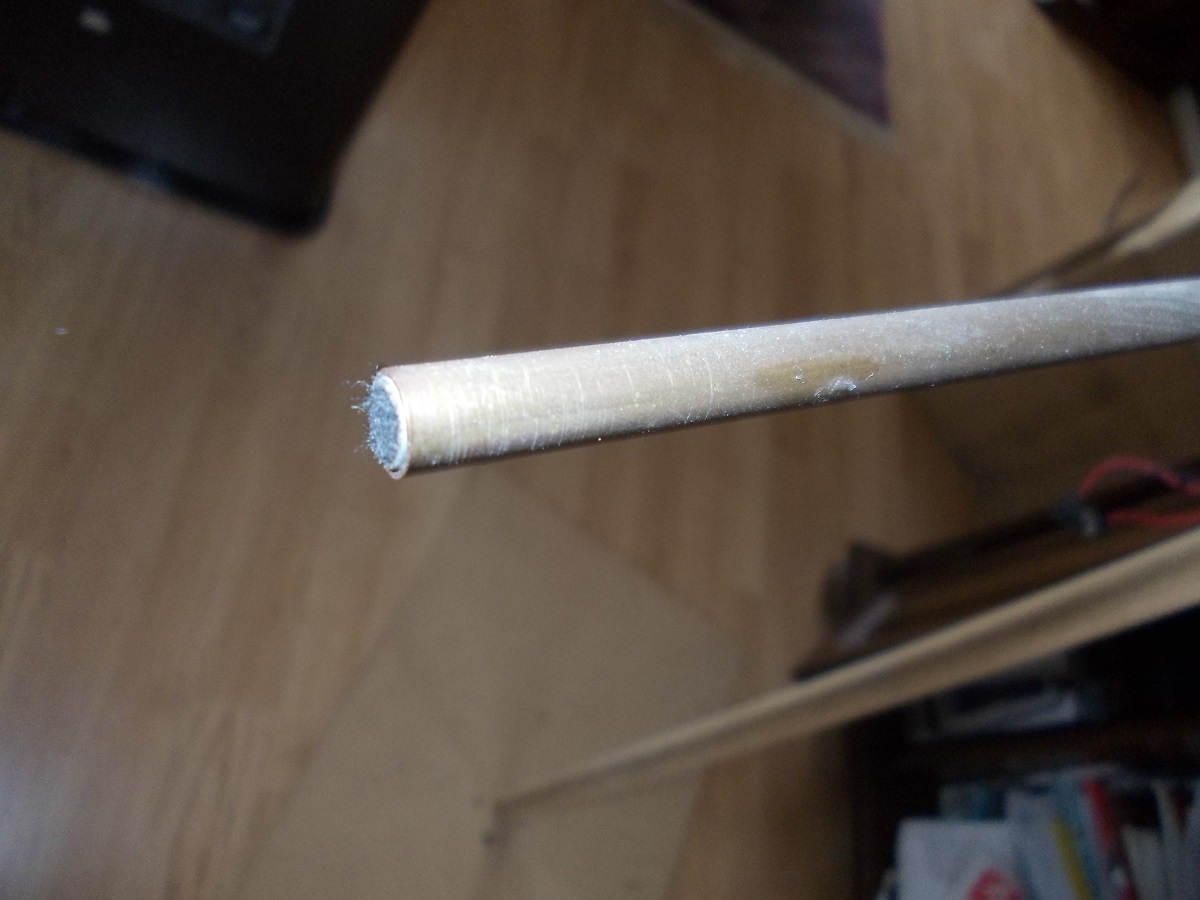

Download a copy of REW, use built-in mic on iPad. Or get a USB mic. There’s no way a speaker like a synergy can be properly optimized without a proper RTA and mic. There’s more than just frequency response. The level of effort you out into the speaker deserves at least a $40 mic and free software.
I have build a measure mic, these does well.
regards

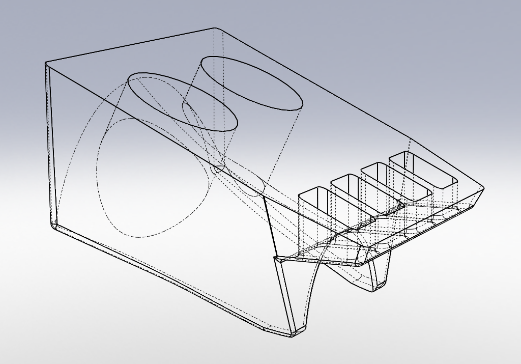

I just ordered 2 18 Sound XT1464 horns and 2 SB65WBAC25s. We know based on Bushmeister and XRK971's measurements and listening reports that the synergy version of this combination plus 1 or 2 8" woofers crossed at 650 Hz or thereabouts give good point-source performance, smooth FR and controlled directivity.
Im interested in finding out if a similar combination in a more typical 2-way or WHW configuration might give similar performance, if a large enough woofer (10", 12", 15" or 18" is used to match the horn's dispersion pattern at the crossover.
My listening room is 13' wide, 24' deep and 9' tall. I'm usually sitting about 12' from the speakers which are toed-in near the corners of one end of the room. I currently have 2 B&W 640i as the mains, which are probably bouncing sound off the walls, roof and floor like crazy. (though I use the receiver's Audyssey Curve Editor to get a flat FR at the listening position - confirmed by REW).
I wonder if I a new (traditional) horn build can control directivity enough with the horn and tweeter, to avoid fussing with the synergy taps for the woofers, and still get close enough to the 500 hz directivity control... Thoughts?

There are few projects that are similar in concept to what you are proposing.
There is the Raptor by Paul W which is two 10" Excel drivers MTM with the XT1464.
The Raptor ... a 10" MTM
A couple of Scanspeak 10" drivers or those from Dayton or the 10" version of SB driver would likely work pretty well without the high price of the Excel's.
Or this one which uses a BMS Coaxial Compression driver to get low and cross to two 15" drivers in MTM.
Faital 15PR400, BMS 4594 MTM - Speaker Design - Data-Bass Forums
If you want to avoid fussing using a 1.4" compression driver would bolt straight on and something like the Faital HF146 could use a low crossover point if the SPL expectations are reasonable.
To get directivity at 500Hz would need a much bigger horn and to get something as smooth as the XT1464 is quite a difficult construction project.
Bushmeister's design works well because the drivers chosen work well together and injecting the woofers in the horn improves the directivity.
Enjoy!
XRK971 - Thank you for sharing these files, and I hope this is not asking too much, if it is - I apologize in advance, and will not mind if my questions are ignored...
I would like to use one of the throat adapters to mate the SB65WBAC25-4 with the 18 Sound XT1464 (instead of routing a radius at the mouth of the horn to fit the larger cone driver)
Here are my questions:
Would you recommend one version over another? The 3 versions appear to have different thicknesses (Which would impact the transition angle between driver and horn) and different recesses for what I'm assuming is driver surround at X-Max. Is there a rule of thumb to follow when choosing a throat adapter? (Gentle transition vs shortest path?)
I don't have a 3d printer so I was planning to use a service to have the adapters printed... What might be some recommendations for filament type and printing resolution to specify?
