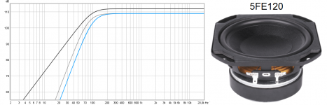

You ask for smaller woofers and had myself some thoughts on using 4x Faital Pro 5FE120 as woofers because of their small print and only takes 3,88 liter volume per driver to get a sealed Q 0,7 f3 98Hz alignment. 4x will be 0,03192 sqm Sd area with a 5,25mm linear stroke. In 4th order symmetric band pass it seems possible each feeded 64 watts and the doubling of power because they inside 1/4 wave to get 112dB total output. In below black trace is the 112dB spl with f3 98Hz and grey plus blue is example if target XO is LR4 80 or 100Hz and sits at 109dB line. For home use less spl is needed but if they worth the power or are avaible in Norway don't know, but they relative cheap in UK Faital Pro :: Faital Pro 5FE120 5" Speaker Driver 80W 8 Ohm 21.78 IN STOCK (4 Apr 2016) and also available in Sweden Faital Pro 5FE120 - supersonic.
