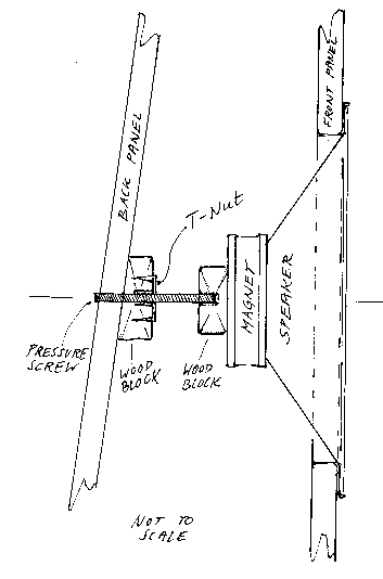

.........the brace will cycle between 250N and 150N of compressive force and never go to 0 N load. The driver will always be braced with load
This type of mass loading is the most desirable and combined with a motor support cross brace if it's heavy, especially if it's a wide BW driver app. An adjustable one such as Herb's allows for fine adjustment since you only want just enough pressure to hear an audible difference.
Of course the cab must be rigid to minimize the preload pressure and maintain it over time, so all six sides must be tied together at least in driver location area to keep it from 'breathing'/bowing over time.

I don't like to stress the basket.
In my example with the PR2 woofs, the threaded rods supply the opposite sense.

Yes that is fair enough, I reckon it would be ok on a strong cast frame though. Are the rods in tension, compresion or at zero load.
Tension (just a bit)
GM
This looks excellent, basically what I had in mind.
I should have realised earlier, that if I put the rod in compression then I don't need to drill and tap the back of the driver.
I will see what I can do to impelement it. In fact I will build this, next week

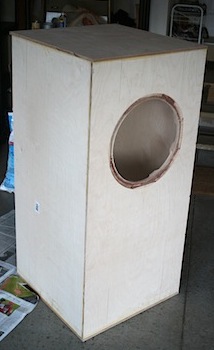

in the simulations I did, I also found little benefit of using a port in terms of bass extension - the box is simply too small (my simulation wanted me to use a 1,600 litre box if going vented !!!!!). Try stuffing the port slightly, to make it more aperiodic.Not a massive difference actually.
I could live with either. I am trying to optimise the ported version.
I will make some longer ports

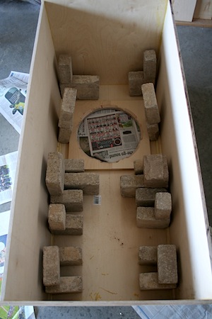

I'm adding some filets into the corners to strengthen the joints. I round off the corner of the filet where it goes into the corner of the box because there's invariably some glue that has squeezed out of the joint on the main box and the rounded off filet will allow for some clearance and ensure that the filet makes good contact with the side panel and front baffle.
The box looks like an empty shell - there's a fair bit of bracing to go in here yet.
Not so easy finding a clamp for the filets though...

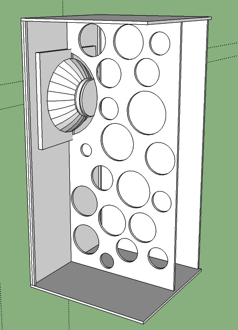

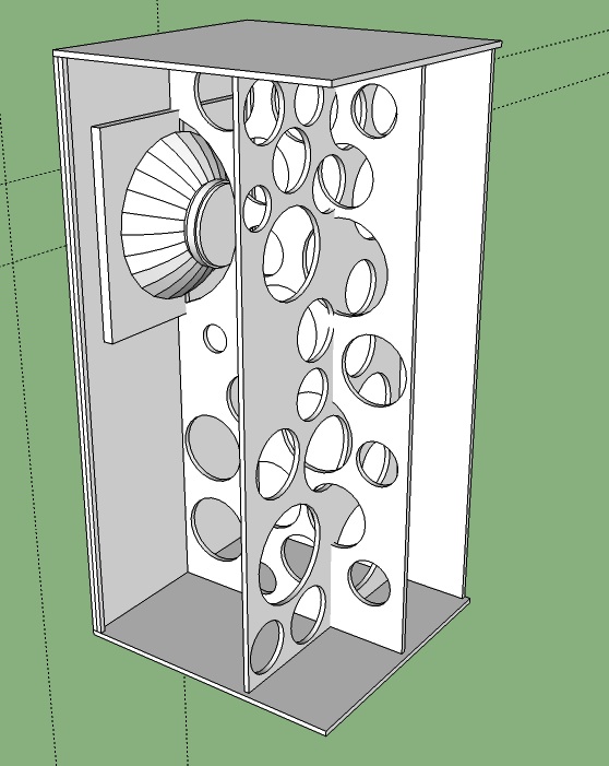

so, how about a big holey brace vertical front to back ?
That looks great!! Is it off centre? Also can you make the brace flat where it touches the magnet?
If you can work out how to add 2 more horizontal holey braces that 'slot' into the main vertical brace that contact all 4 vertical walls, and again space them randomly - now the would be cool
Next up how about 2 holey braces that slot into the main vertical brace, but at angles (different for each brace) from front to back?
To totally blow your mind & wood working skills take those 2 holey braces and spin them on 2 axis to random angles - maybe low point towards front right corner and high point to back left corner
Joined 2009
I'll give some thought to the idea of an angled brace. My original thinking was just to have two vertical braces, one front to back, the other side to side. Neither of them divide the box into equally halves of course, they are both offset. I'd shape the front-to-back brace around the magnet better.
