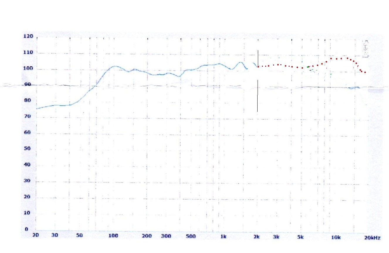

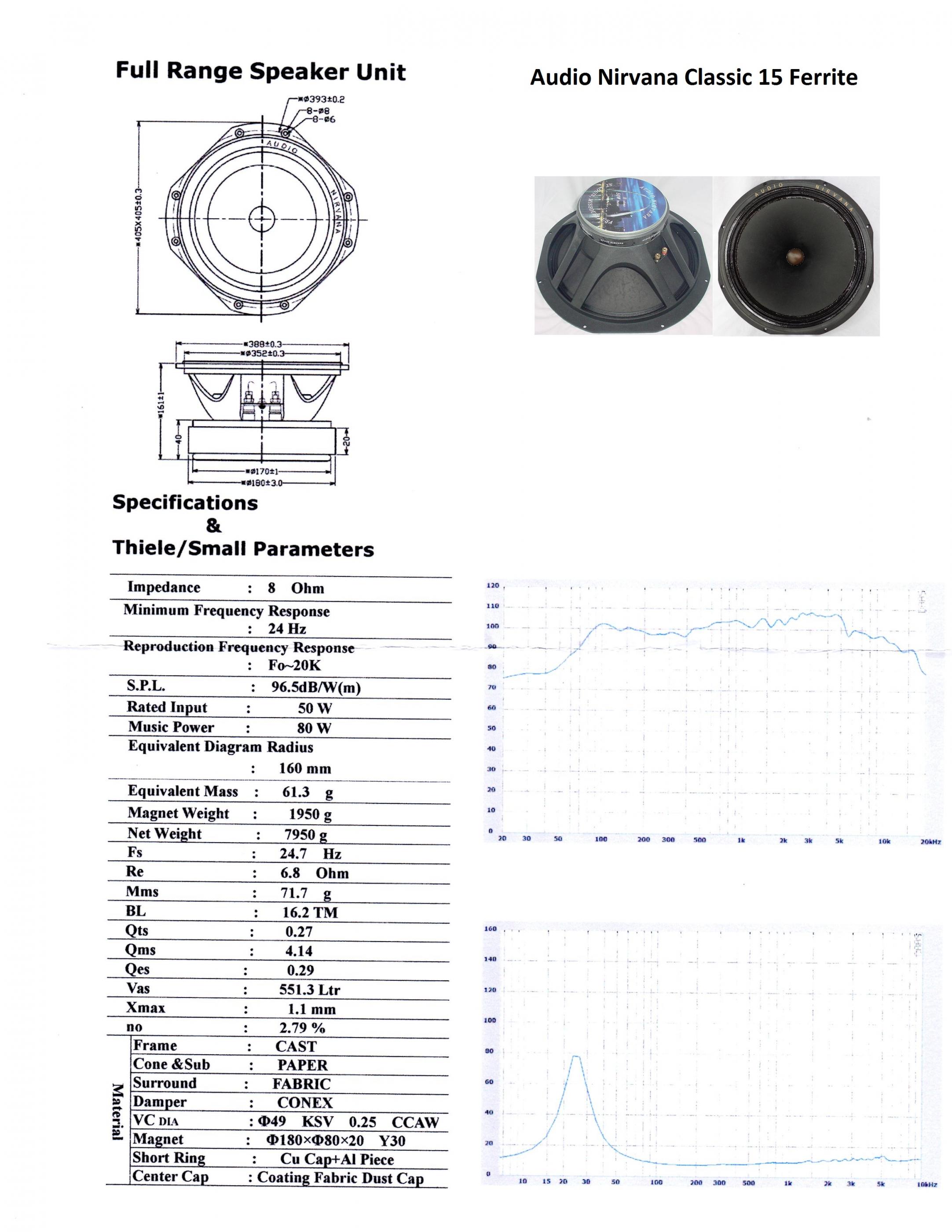

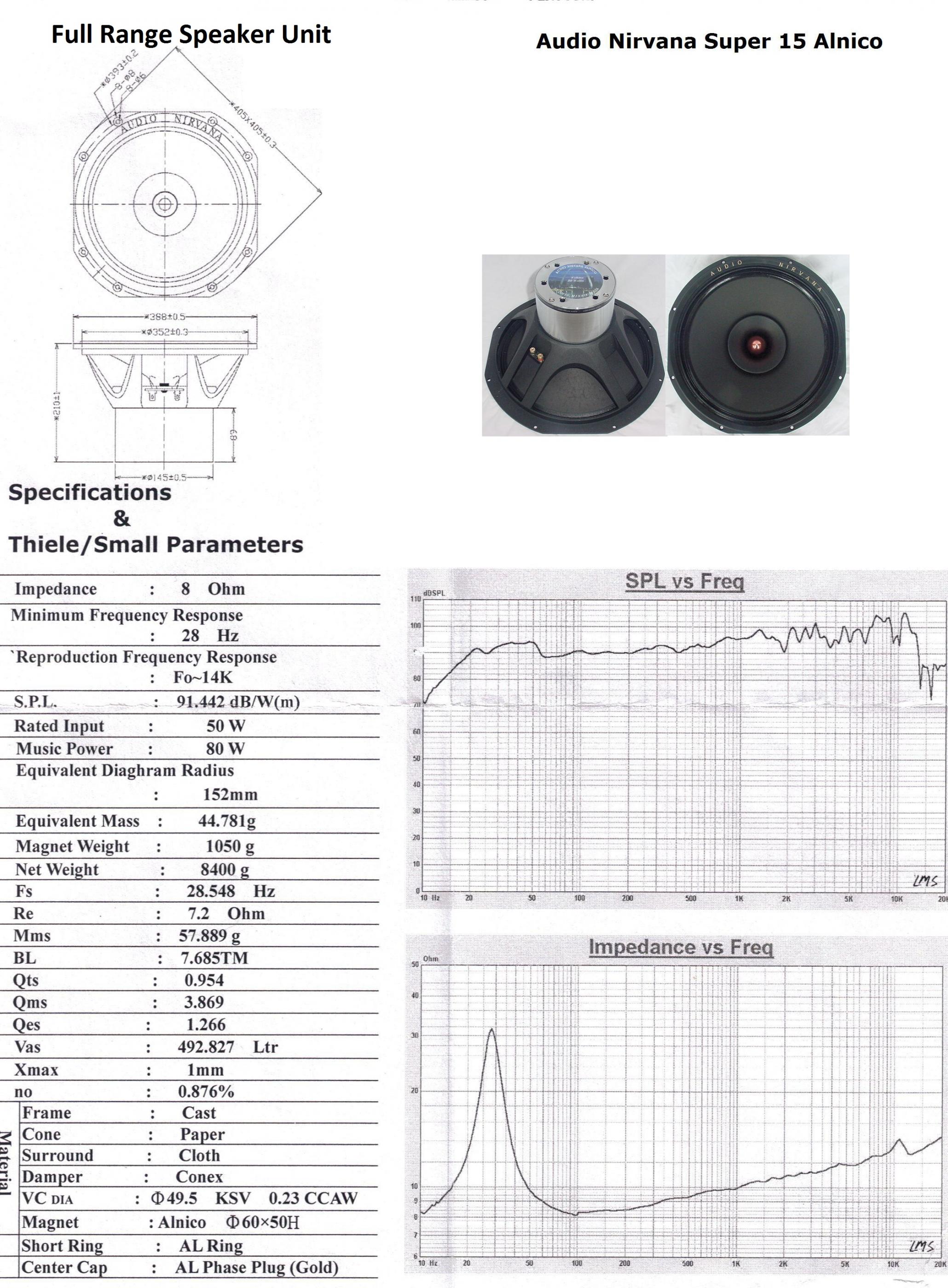

My two-way concept relies on the big AN getting to the "guitar speaker" sensitivities, 100-110 range...the Alnico version comes up shy, just running along at the plain jane response...that 90 to 100 Db range...I couldn't justify the doubled price of the Alnico Super.
See all three plots here, along with the AN-15 & Aurum Cantus G1 plot.
I was reading up on some odd lobing patterns on the vertical axis of the big AC ribbon...I'll give you all some guesses as to why that is an anomaly of this big ribbon...?
