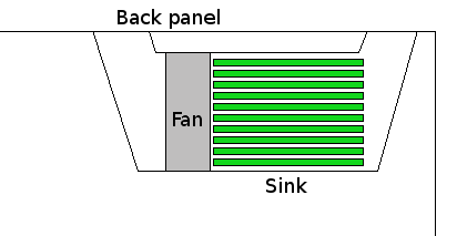

Attached here is a rough sketch of the design i'm contemplating right now. The "tube" is made of tin or other thin metal, with the top removable, and the fan is held vertical by two L-shaped flanges. What i'm working on now is how to keep the damn dust out.

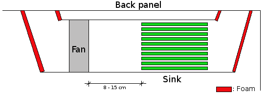

Lisandro,
You might find that the turbulence induced by the rapid rotation of the vanes right near the fins of the heatsink creates quite a bit of noise.
The solution,I have found, is to use a 10-15 cms long plenum chamber, whose purpose is to make the airstream more laminar before it enters the sink. This will also help with dust formation too, which is usually prevented by putting a filter on the induction side of the fan.
I'm doing a Class A at present using this precise technique.
In response to the question on inductors to slow the fan, I note that fluro ballasts are dirt cheap and rated for mains operation. This is in sharp contrast with purpose built inductors!
Hugh
After taking both advices in consideration (thanks!), i redrew the design. I originally didn't intend to keep the tube ends so tight to the fan / sink, but in spite of keeping the image small i drew it like that. The new sketch is much more what i originally had in mind.
gmphadte, i thought of placing the tube vertical but my amp will be sitting in an horizontal chasis, so it's really not an option :(
What i didn't thought about was noise because of air hitting the sink flanges. So i'll move, as Hugh suggested, the fan away from the sink itself. I also added the foam covering on the air entrance & exit; which can help, to some degree, in reducing noise.
A point i haven't touched is that if you add a fan, you must monitor it in some way. Rod Elliot has a pretty nice design for temperaute monitoring; mine will be integrated in the remote power-on board and will shut down the amp if the sink exceeds a preset temperature.

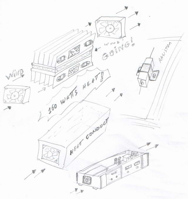

I used tunnel type heatsinks, with speed regulated fan. I planned the regulating circuit by myself. It keep the fan running with low speed, if the temperature is low, and speed up, if the temperature rising. This circuit is very sensitive, if You put Your hands between the fan and the hetasink it speed up within one second....
I found the followings:
- use the shortest route for the air. This keeps the cooling very effective
- use the fan with the lowest possible speed. This keeps the noise low.
- keep the air inside the heatsink
- the inlet, and the outlet must be far away from each other

Make the 90 degrees angles a rounded corner
The best you can round the corners, the lesser the noise you will have....use straight line, as the main direction to wind flow.... assemble fan over flexible rubber.
Fan is fun!
Reduce space
Increase heatsinking
Can make things pretty too, depends on you.
Turns and absortion panels are made to reduce noise...so, better than reduce the damn noise, is not to produce this noise.
If noise fan must be used, small heatsinks used, or needing to push the maximum fan speed, you will need to make turns to absorb the noise, those curves will reduce wind speed, together with the noise reduction, efficiency will decrease.....not a good idea, spiral, curved ducts or things alike.
Push air from your front panel to back or oposite direction, also you can make the hole amplifier a tunel, this way, rectifier diodes and transformers will be cooled too....but the dirty inside will be terrible.
