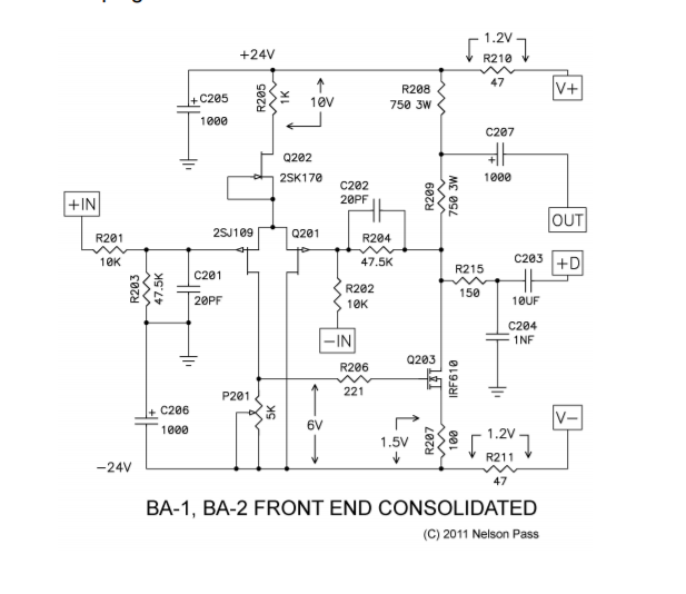

I found this in the article, on gain, but I'm not sure which parts to omit for stand-alone preamp use:
R201 through 204 form the balanced inputs networks. R201 = R203 and R202 = R204, and
the gain is R203/R201. Compensation capacitors C201 and C202 form the high frequency
roll-off for the gain, and while C201 is not strictly essential, it helps to retain the balanced input
common mode rejection figure at high frequencies. If you are interested in higher gain
figures, adjusting the values of R201 and R202 is a good place, as it minimally disturbs the
frequency compensation.

Official Court Jester
Joined 2003
+D is your output
you don't need C207 (that;s node to connect out of amp , for bootstrapping ; if you don't know what bootstrapping is , just ignore it :)
also , put bleeder resistor from output side of C203 (where D is ) to GND , to ensure that cap is always discharged , important not to zap amp when fiddling with interconnection
10 to 100K will do the job

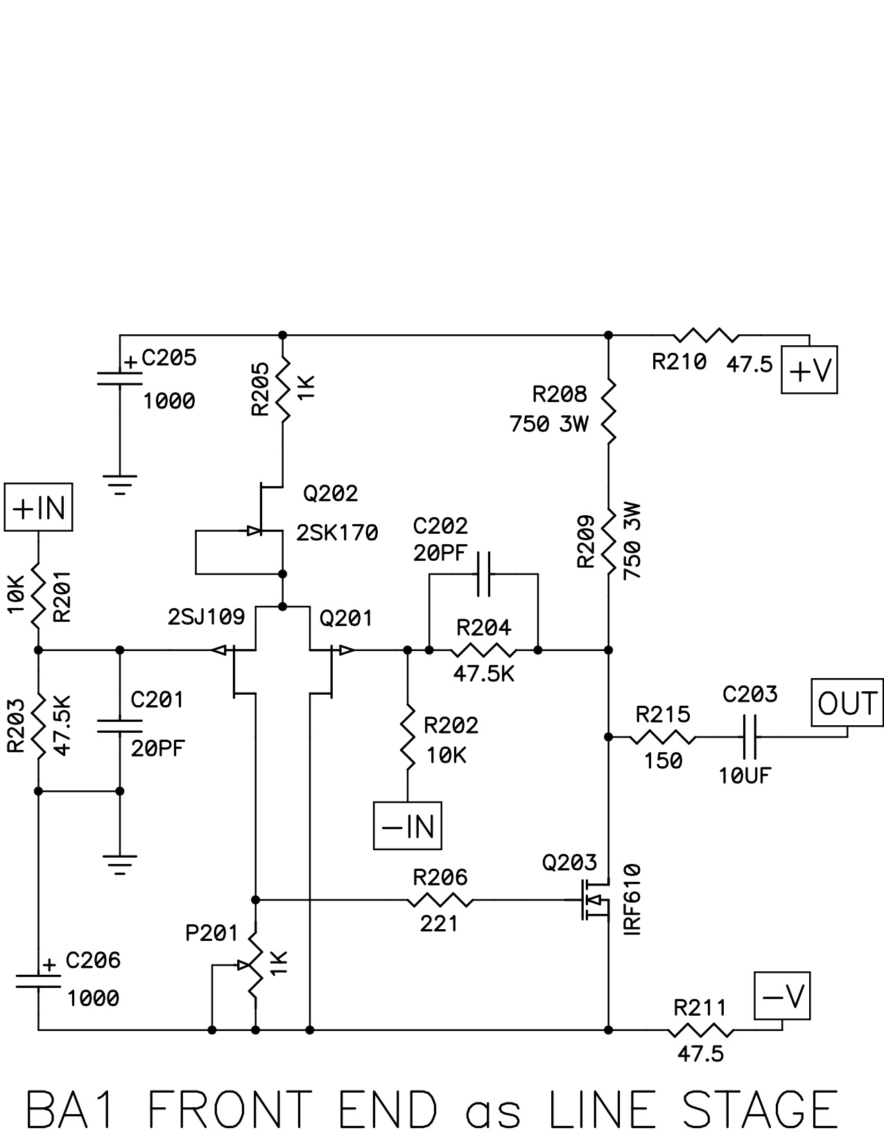

I had a conversation with Nelson a while ago seeing if he had any suggestions on making the BA-1 front-end PCB into a linestage. He did, and was so kind as to make a modified schematic for this very purpose --

6L6
Moderator
Joined 2010
I'd like to echo what Zen Mod has already said, on the BA-1 Front-end board, the pad "+D" is the signal output, and the "out" is for biasing a power amp stage later.
Also the addition of a bleeder on the output capacitor is an extremely good idea.
In a perfect world the K170 would have an Idss of about 8ma, as it's acting as a CCS, but a couple ma in either direction isn't going to hurt anything.
I'd use the 610 in the output to begin with, I recently used 610/9610 in the output of the Whammy and am very pleased with the performance. Get the circuit working with pedestrian parts first and then change things out.
