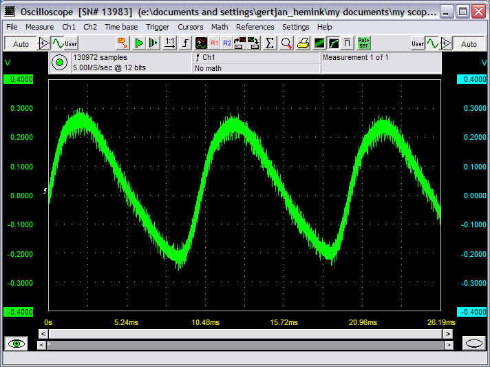

OK, here are the results. I added a cap of 0.47uF in parallel to C25 see the schematics at:
http://www.a-and-t-labs.com/K6_Sw_Amp/index.htm
This moves the compensating zero in the compensation network from 100Hz down to 33Hz, this is about the factor 3 that the resonance frequency of the LC output filter would go down with a 10.000uF cap at the output.
I measured the smps with the default setting and with the added compensation cap with the default output caps and with an additional 8200uF cap at each rail. Plan to use high grade caps for that, but now just used a few caps that were lying around (so not super high quality).
The results are very good. The SMPS is completely stable with and without the added cap, as expected of course. Of course, the feedback loop reacts slower to any load changes, but it recovers very gentle, no overshoots, so lots of phase margin. I could increase the gain (have not done that), to reduce the 100Hz ripple more.
I heated up my dummy loads and went as high as 5.3A load. The output voltage stayed stable at about 63.8V at any load between 0.38A and 5.3A, at 5.3A we are talking 675W power, the dummy load got pretty hot.
The 100Hz ripple at the highest load of 5.3A was about 1.9V peak/peak, so about 670mV RMS with the standard caps and went down to 660mV peak/peak or 230mV RMS with the added 8200uF caps. So I got about a factor 3 reduction in 100Hz ripple.
The HF ripple consisting of mainly 150kHz and a smaller 75kHz component reached about 250mV peak/peak at 5.3A and is about 100mV peak/peak at 3A and lower.
I'm already very happy with this performance, I will in a later stage hook up my Elna Cerafines and I will also try to increase the gain since I'm sure I have a lot of phase margin. Possibly with the Elna's the HF ripple is further reduced. I can also play with some additional black gates that I have to see if I can reduce that HF ripple further. Besides that, I also have the white noise active supplies that I could hookup after the SMPS, expect than a super clean output without any 100Hz ripple and without any HF ripple (hopefully :)).
Maybe in the weekend or later next week, I plan to hook it up to a couple of UcD40 amps.
Attached are two scope measurements for the default case and the case with added 8200uF per rails. The load is switched from 164 Ohm to 41 Ohm, so from about 0.75A to about 3A. Note that the scales are blown up big time to 2V per division in both cases. Both + and - rails are shown.
Looks quite good I think.
Best regards
Gertjan

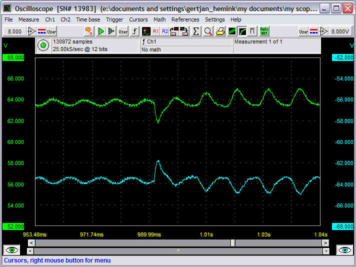

ghemink said:
This is with the 8200uF caps.
I know which one I prefer :)
In case anybody wonders, the scope is a PC based scope with 12 bit resolution up to 50MHz sampling and 8 bit up to 100Mhz. It can do up to 14 bit and 16 bit resolution at lower sample frequencies (it uses oversampling). The scope is the HS3-100 from http://www.tiepie.nl (but better buy it in the US, a lot cheaper than in Europe). It also has an AWG (arbitrary waveforg generator) that is a great tool that I used to generate signals for the open loop measurements, no seperate generator needed, very nice.
Best regards
Gertjan

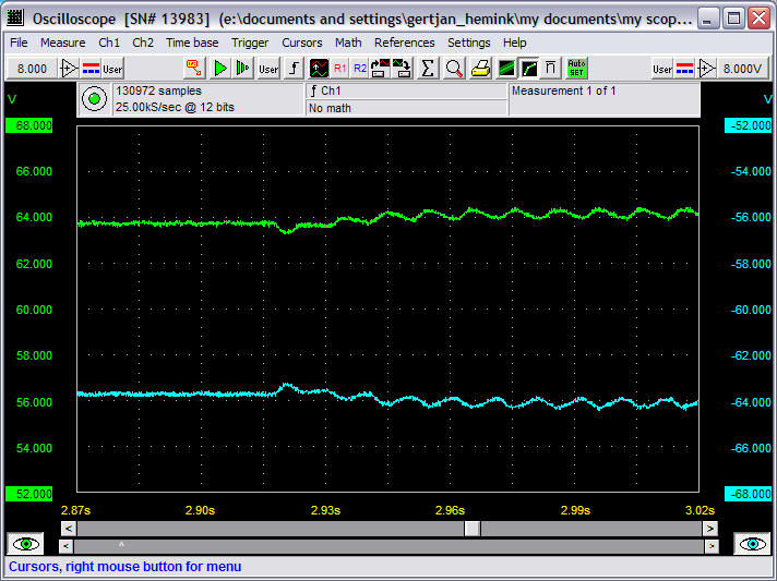

And this one is with the original 0.22uF cap but now resistor R25 changed from 7k to 33k. This increases the gain and reduces the frequency of the first zero needed to keep things stable with the big 8200uF caps. The gain can be increased because the LC filter output essentially falls of with 6dB/Oct due to the low Q factor and due to the series resistance of the cap itself (0.05Ohm). I tried even higher values, but then at high currents (more than 5A), you get a slight oscillating behavior, not heavy, but larger than the 100Hz ripple. Everything stayed clean up to 43k, but when I switched to 56k, I got some weak oscillations at about 250Hz when switching from the 41 Ohm load to the 23.4 Ohm load (from about 3A to 5.5A). With 56k, the 3A load gives no problem at all. For safety I decide to use 33k to have a safe margin for even higher currents.
When I hook up the elna caps I may have to do this exercise again because the elna's probably have a lower series resistance.
Note that the drop due to the switching in the load is now almost invisible (switching from 0.8A to about 3A).

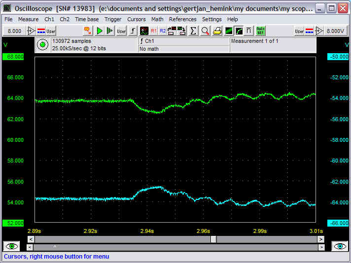

And here when switching from 3A to 5.4A load. The switching oocurs at about 2.59s, can not see it.

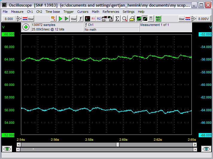

And here is the AC residue on the power rail (only positive rail shown).
About 400mV peak/peak LF residue (100Hz + harmonics) and only about 40mV peak/peak for the HF residues. And this is at a load of 5.4A on both rails with both rails at 64V, so delivering 690W power.
I think I have a hell of a power supply here that is immune to changes in the load current and has very low LF and HF ripple.
Thanks to Reinhard for this supply that I could further optimize in a relatively simple way. Hopefully this weekend, I can hook up some of my UcDs to see how it works with the amps.
Best regards
Gertjan

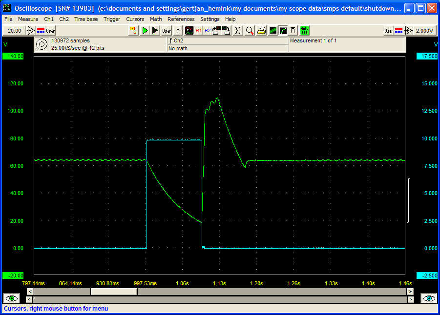

shutdown behavior
I restored the supply that I have to almost its original state (kept the RC network that ramps up Vref nicely to avoid the overshoot at startup).
Then I had a look at the shutdown behavior. I applied a 100ms pulse at the shutdown input. In that case, the supply should shutdown and opamp IC2 should function is a latch to keep the shutdown state for a while until the latched state is reset by R24, C9 and Q5 combination. However, it turned out that after the pulse, the supply starts immediately, well before the sofstart cap C6 is discharged. So, the supply restarts at full power. As a result, the overcurrent protection of the supply is triggered a couple of times during the charging of the output caps (the 2x470uF per rail). The output signal is really nasty, see attachment. The blue signal is the signal at the shutdown pin, the green signal is the + rail output voltage. The + rail goes all the way up to 110V!!!! after the restart after the shutdown pulse goes low. The ripple on the output voltage directly after restart is because during that ramp up, the overcurrent detection of the supply trips a couple of times, shutting down the supply for short periods of time. The supply was loaded with a 164 dummy load between + and - rail.
Because of the nasty restart I decided to remove Q5 since I expected that this one resets the latched state too fast. In that case, IC2 should always stay in the latched state, so no restart. I think for safety I would prefer this. After an overcurrent situation or a shutdown, the supply would stay in the shutdown state. One would have to remove the mains voltage to reset the supply, this is of course the safest approach. However, this did not change anything. So conclusion, IC2 that has to function as a latch circuit, does not work as a latch.
After more measurements, I found out that the reason why IC2 is not working as a latch is that the output of IC2 is loaded too heavy. A LED is connected to that output with a 316 Ohm resistor. This alone draws about 30mA, it has some other load at the output as well, so that poor opamp's output voltage dropped quite a bit and became too low to make it function as a latch. When I replaced the 316Ohm resistor R40 with a 1k resistor, the latch worked perfectly and the output voltage had some margin to let the latch work properly.
After I found this al out, I did not replace Q5 anymore, in fact, Q5 was damaged when I desoldered it. But that is OK, I can check it with the other supply that I have not build yet. But I think I keep it this way, no restarts after a shutdown or overload is the safest approach anyway. I plan to add bigger output caps as I experimented with before, so with those bigger caps, output current peaks should be no problem and should not trip the overcurrent detection circuit of the supply too fast.
Bottomline of the whole story is that this shutdown circuit does not work correctly, R40 needs to be replaced with a 1k resistor to make things work. I think this is quite a serious thing and users should be aware of this not corectly functioning shutdown circuit. I assume the supplies of other users will have the same issue. Note that my supplies came with LM358 for IC2, the original schematic shows LM258, don't think that these opamps are a lot different.
Best regards
Gertjan
