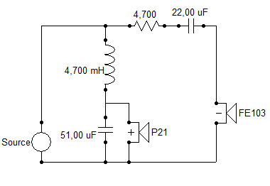

This is a schema as simple as possible. The crossover point is near 500Hz.
The baffle step is corrected with a big coil 4.7mH. You must adjust the level of the Fostex, it is the job of the 4.7 ohms resistor. This value of this resistance can vary for fine tuning. The capacitor 22uF cut near 500Hz, it push the 100Hz resonance effect only 15dB down. Note the fostex is in opposite polarity.
The capacitor 51uF is by default because you have it, you can remove it, to test but not recommend. This capacitor can be replace by an impedance compensation R=6.8 C=15uF, but I think a simple capacitor is more efficient. A value near 27uF gives a better phase response, eventually to test ?

Great info and schematic Jerome. Thanks!

Use it doesn't give a good phase response although the resonance of he fostex is better controlled. Don't forget to connect the fostex in opposite polarity.Also, why is the inductor useless?
Follow Dave instructions or my schematic.I'm at a stand-still at the moment because I don't know how to wire the Fostex up... Other than that, the speakers are pretty much done and ready to go.
