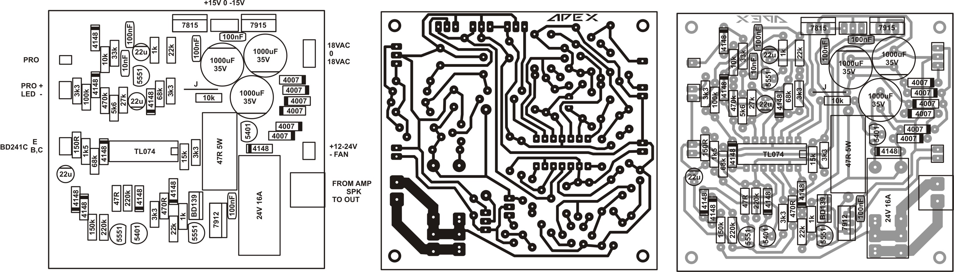

My protect circuit use 2x18VAC. There is thermal senzor and power for 24V fan with two speed control, also have +/-15VDC PSU for balanced input circuit.which is better
if i use 24v supply
transformer must have 4x40v +/-15, and another 24v for the fan
if i use another small x-former for fan and protect circuit
what is the desired ampere

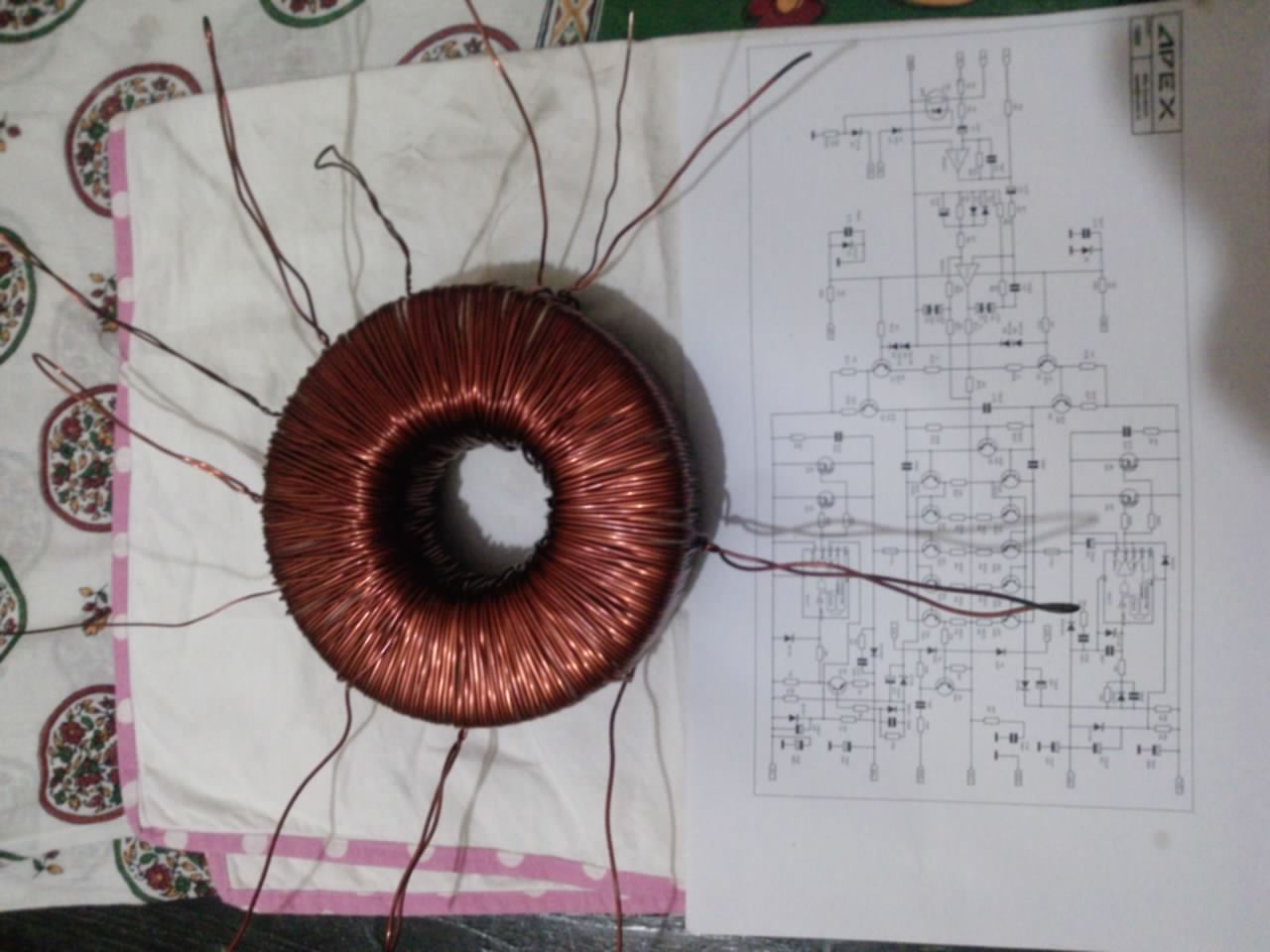

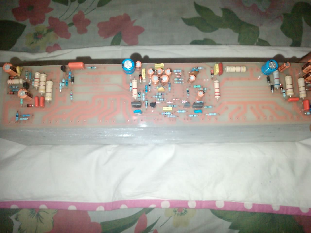

greetings working on 900h my dream project finished
winding my transformer have eto put insulation tape and take leads out

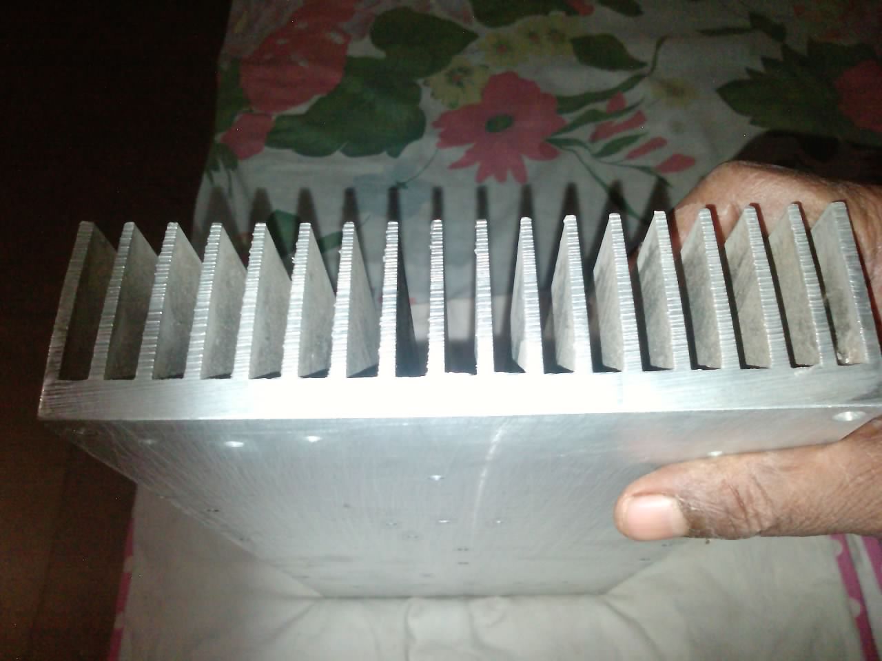

heatsink have to be cut and anodised posting pictures

pcb to be fitted like this

H900 Protect include:
1 Anticlick 5sec delay
2 DC cut-out
3 Thermal cut-out on 90deg
4 Fan high speed on 60deg
5 Over current protect (power-on reset)
Conectors:
1 2x18V 500mA AC

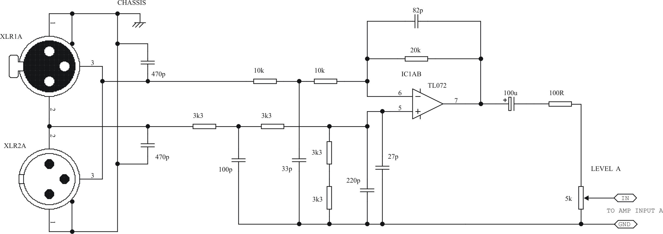

2 +/-15V DC stab for XLR circuit
3 PRO overcurrent detect
4 Protect LED
5 Thermal sensor BD241C as diode on heatsink
6 24V DC Fan cooler (12V for low speed)
7 Speaker IN/OUT
2 DC cut-out
Conectors:
1 2x18V 500mA AC
4 Protect LED
7 Speaker IN/OUT
andrewlebonhi apex audio
greetings work in progress,will keep u informed
thanking you
andrew lebon
what software are you using in making pcb
or does this h900 pcb is already printable
w/o size change
can you share protect pcbhi engel dela pena
greetings yes pcb is smaller easy to find components no
software used take out a printout and see if 8pin ic aligns exactly to tracks
accordingly can be enlarged or decreased
thanking you
andrew lebon
